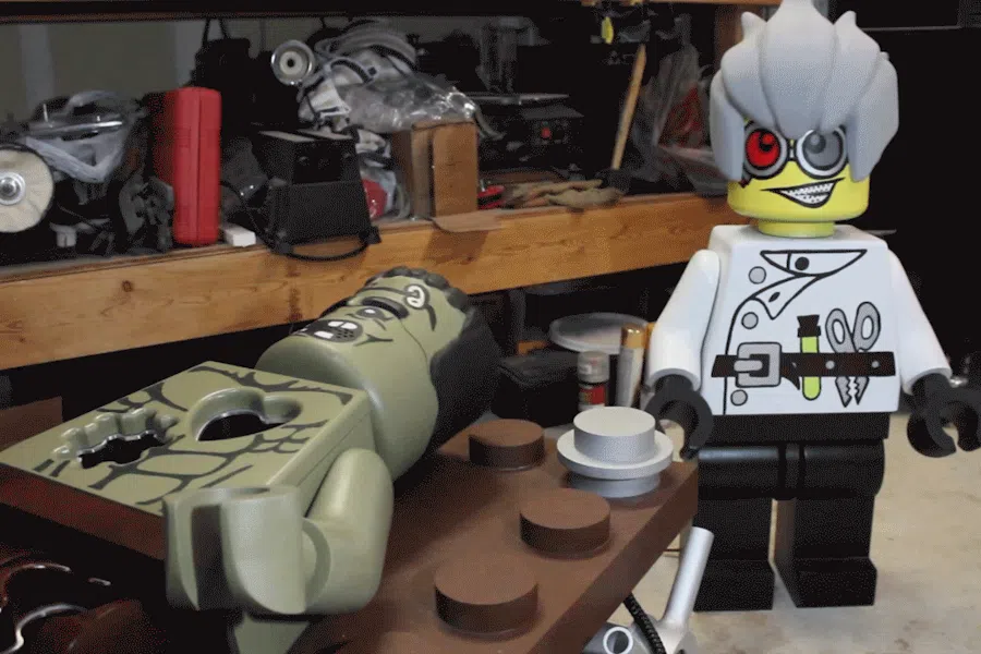

For Halloween this year, I upgraded my Giant Lego Minfig decorations into an animatronic operation game. I iused my Taz5 to grown alot of brackets to hold bearings and servos, as well as both of his legs. The premise is that the candy is stored in the Frank, when the tongs touch the sides of the candy dishes, both megafigs move and talk.
If you want to see them moving, click the youtube link below.
https://youtu.be/BqjBtizkyo8
3D printed speaker mount.
3D printed bearing holders
3D printed leg
1 of the 3D printed candy dishes
You can view a full build log at http://www.therpf.com/showthread.php?t=195101&page=5
