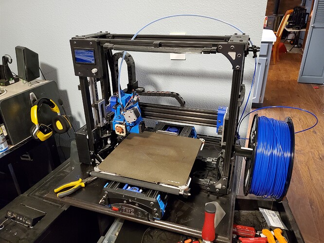

I was going to mention the OpenRails work that @piercet has done as an option I was thinking of, since this is a hobby printer I think it would make more sense to go OpenRails even if its a lot of work. Would love to push this machine to its limits.
Thanks for posting a photo of your modified printer. I really like your openbuilds modified printer. Think I’d like to try that modification!
