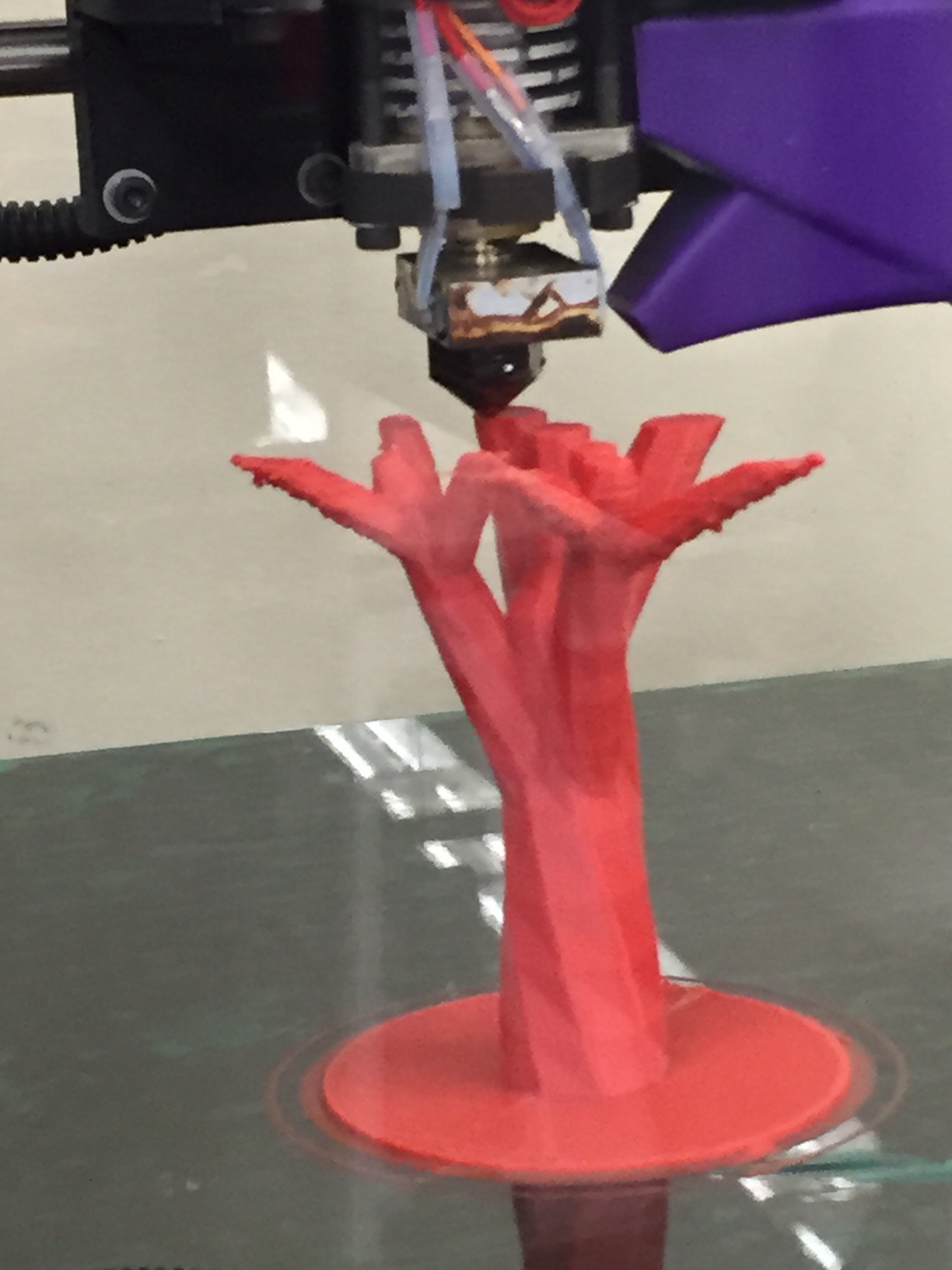

However tried a print with some overhangs today and had some droopy edges. Don’t want to hijack your post but I felt this was related to your topic instead of creating a new thread. The tree below I printed today had some issues with the branches as you can see, It took about 8 hours to print which is why I am asking instead of just experimenting. It started drooping right as it started angling out, so was not just on the skinny branch areas. There are others on thingiverse that got the trees to print cleaner. What do you think needs to be adjusted to fix this drooping? Extruder temp (110c) Fan speed (was 45) print speed, retraction?
Also, as it was printing on some of the branches it was pushing them down as it was adding the next layer so it must have began warping between layers slightly raising the height of branches.
Thanks

I am running at 220 on the extruder as I do not have the hexagon head and have been having fairly good results. Also have the fan at 100%. Even at that I have some issues with drooping more with hips then other materials… Do you have any issues drooping at 250? I feel the higher temp would cause more issues.

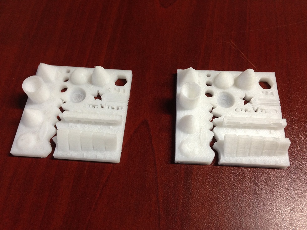

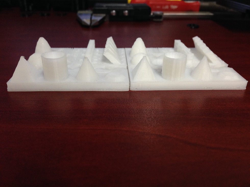

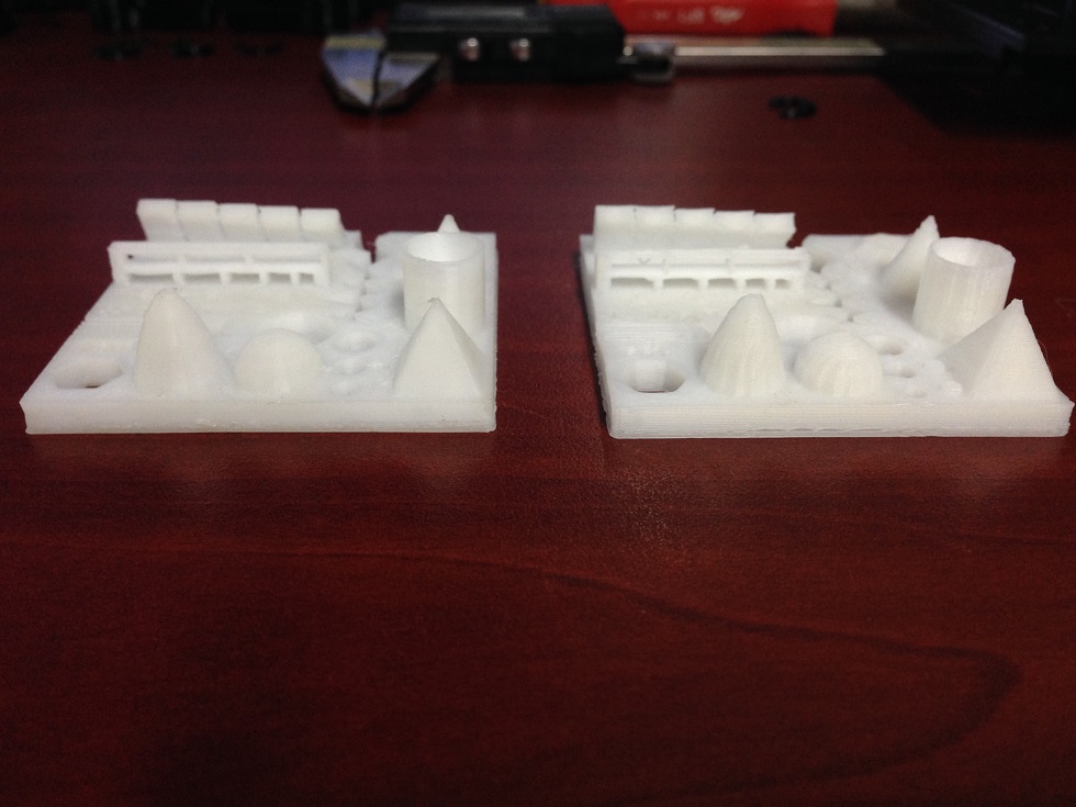

I haven’t had any drooping issues that I’m aware of, but I try to design my parts to prevent that if possible. I did print the CTRL-V test part a few times. Once I understood what it was and what it was doing to my Taz, I did a comparison between CURA and Slic3r using the settings listed below. Here are the results of the 2 parts side by side, the CURA part is on the left, the Slic3r part is on the right. The parts were printed with the overhang facing the fan (machine X+). I’ll put the print specifics right after the pictures.
In CURA, I used the same settings I had listed previously -
Extruder at 252°
Bed at 95°
Print speed 50mm/sec
Layer height .2
Shell thickness .7
Filament Dia. 2.91 (calipered)
Flow 103%
In Slic3r, I had used the profile HERE provided by Lulzbot for the Taz 5.
I have to be honest, and say that I’m really not impressed with either of these at all. I’ve made a few other parts from HIPS, but when I want detail or corners, I end up going to PLA. I haven’t tried out ABS yet (Still finishing up my printing cabinet), but that’s on the list soon!
