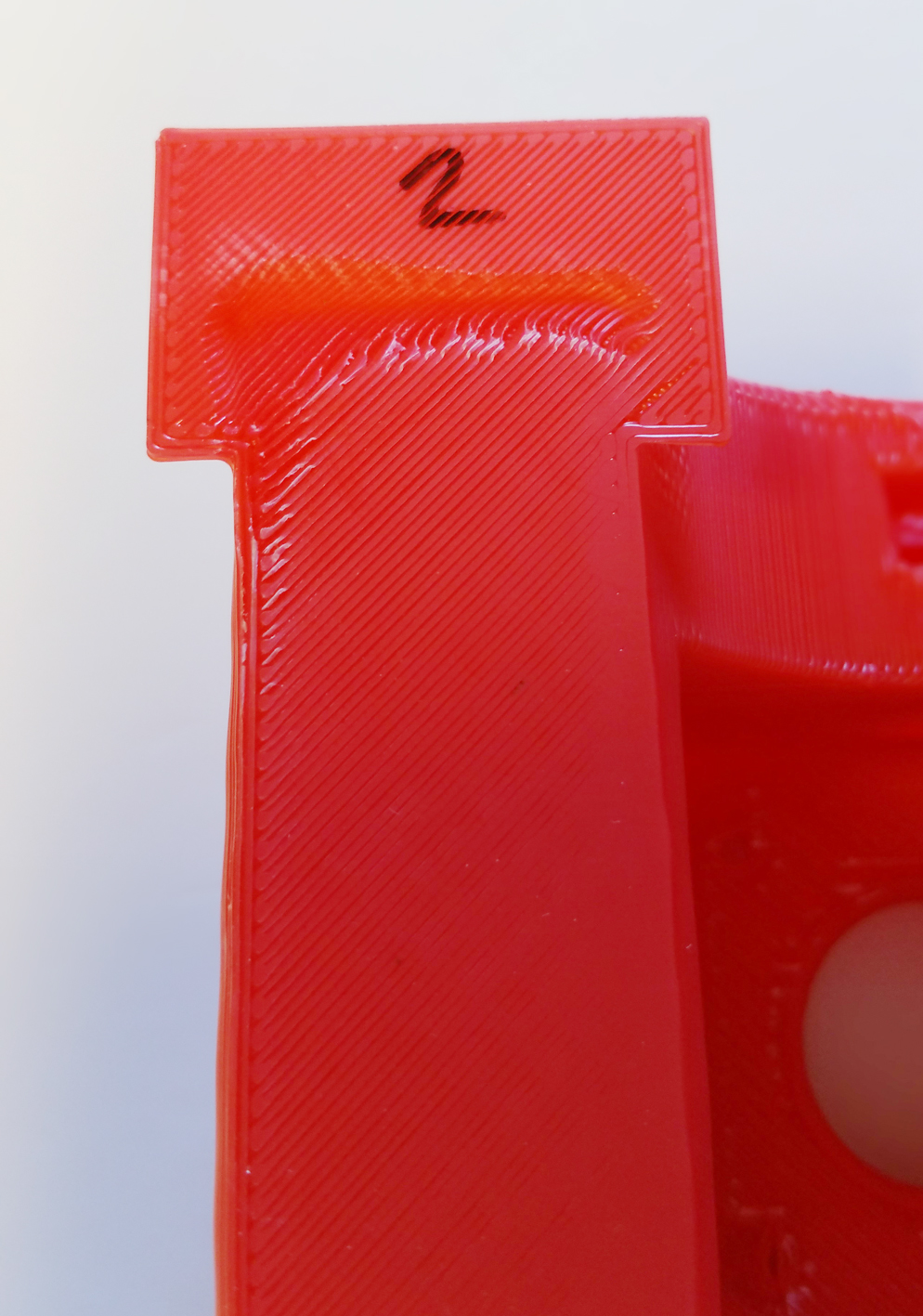

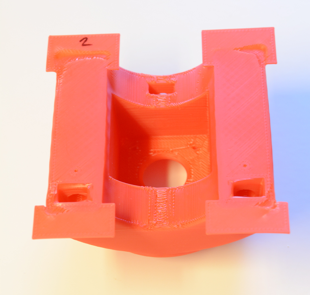

When printing with HIPS one or two of the parts have given me problems with shrinkage resulting in corner lift from the bed. I
have tried many different approaches to mitigate this problem as follows :
- Changing the bed temperature from 110C down to 80C
- Incorporating localized brim
- Enclosing the printer as best I could
- Changing the number of base solid layers
- Changing the fan speed and presence
After much trial and error I did manage to improve the corner lift problem. I loaded the models into Meshmixer and added in
localized corner 1mm brim but even then the corners lifted even within the brim itself - see the images.

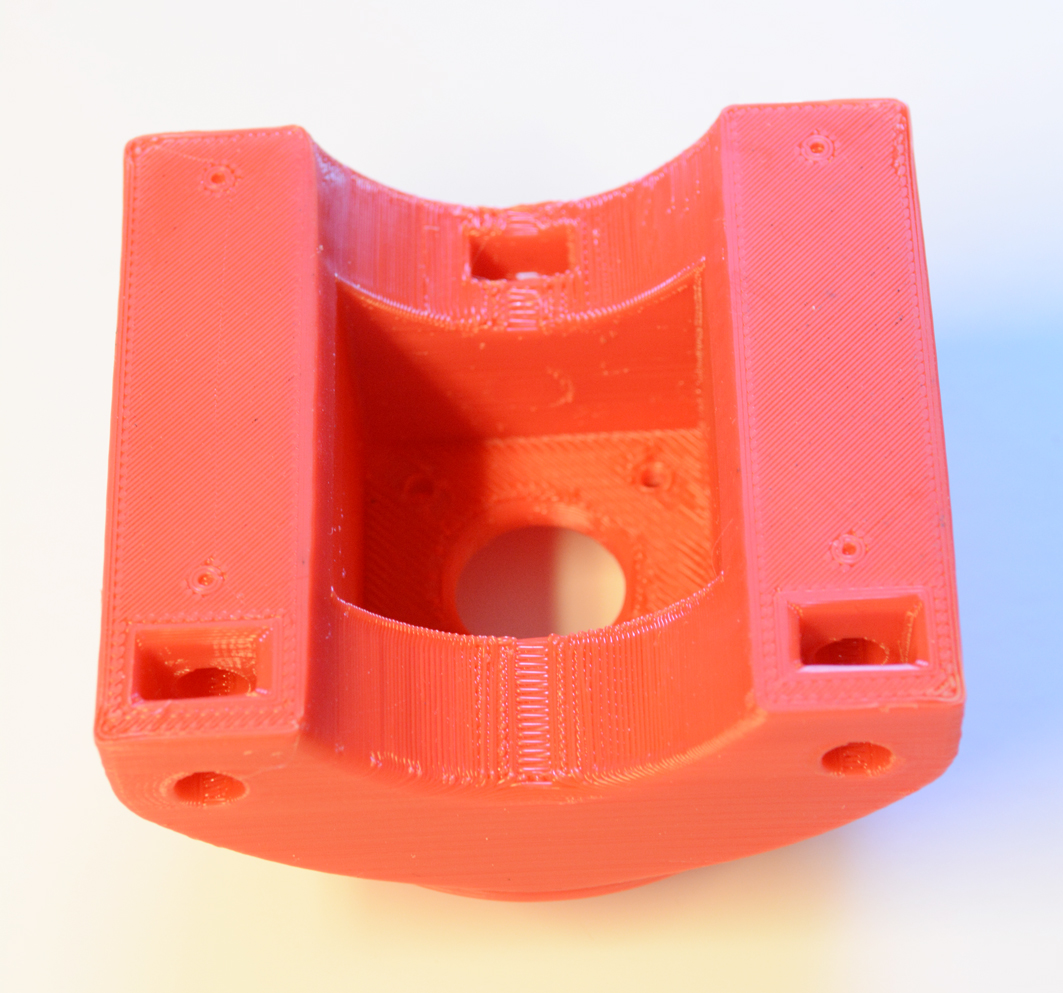

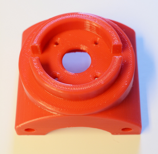

I then decided to have a go printing the object using a new filament PETG. I found PETG to have advantages and disadvantages
but overall the advantages were clear.
HIPS
- Prints generally very well
- For larger parts corner lift seems almost impossible to cure
- Can be vapor smoothed easily
- Produces a pleasing mat finish
- Low levels of ooze and stringing
- Very strong
- No smell
PETG
- Almost zero corner lift or shrink at all
- Vapor smooth - not tried so far
- Finish is slightly glossy
- More ooze and string than HIPS but fixed with profile tweaks
- Very strong (stronger than HIPS/ABS)
- No smell
I have been printing the PETG at 240C extruder and 100C bed temperature. I think from now on I will be printing with PETG
simply because the levels of shrinkage and distortion are so low compared with HIPS/ABS.

Anyway enough words, here are some photographs to show the results :
