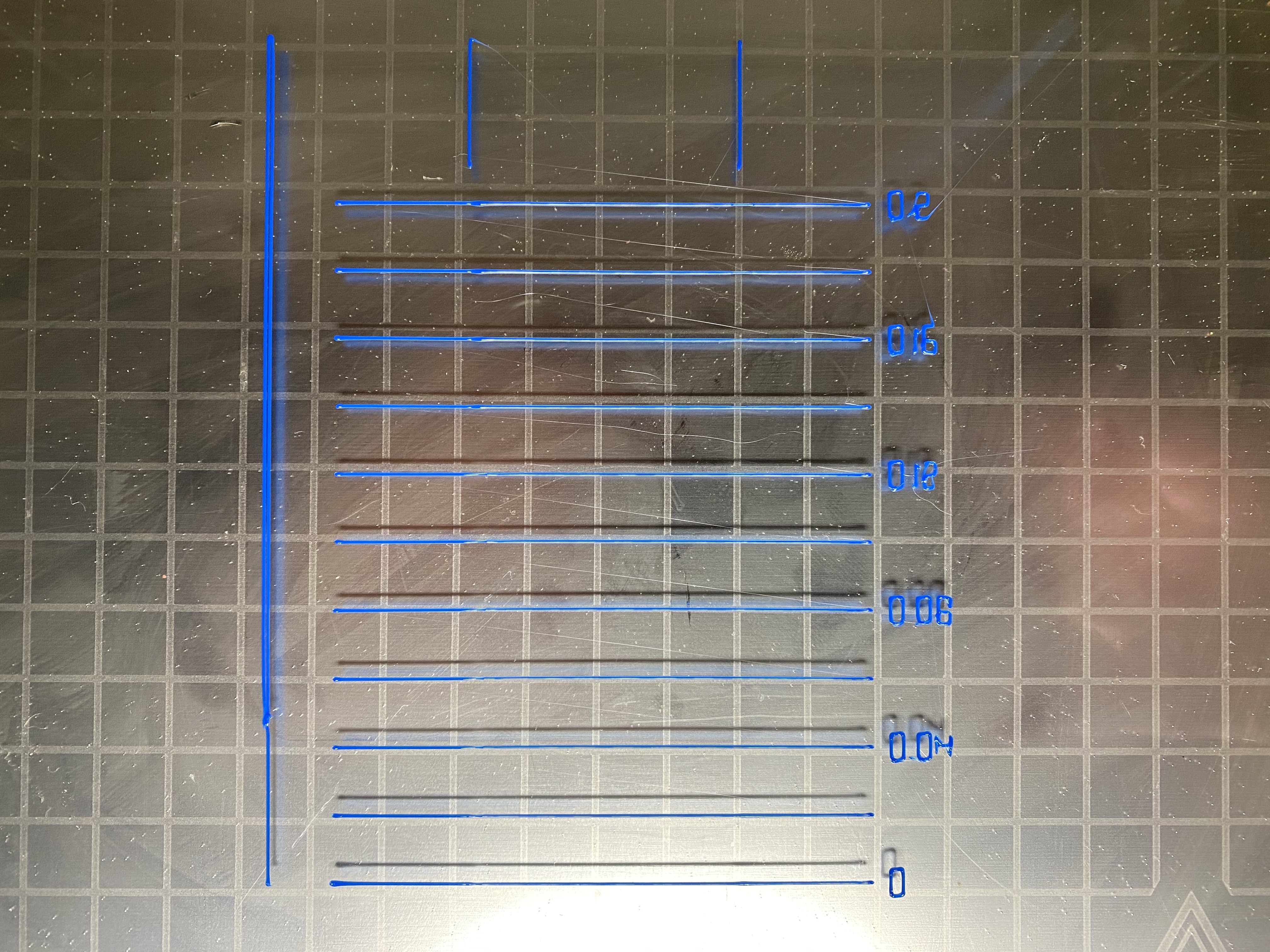

You will get a result that looks like this:
The line at the left is just the priming line (just to get the filament moving)
The job will print several lines … each will be printed at the “slow” speed then jump to the “fast” speed for the middle section and then end by returning to the “slow” speed again.
Along the top there are two horizontal lines … these mark the speed transition points. The left mark indicates where each row switches from slow to fast. The right mark indicates where it drops from fast to slow again.
Inspect each row. For example, the “0” row at the bottom shows a very slight “pinch” in the filament at the left transition and a very slight “bulge” in the filament at the right transition point.
The row at the top (the 0.2 row) is the opposite… it shows the “bulge” on the left and the “pinch” on the right.
We want the row that looks perfect … or as close to perfect as we can get (no pinches or bulges).
To my eye, the 0.12 row (7 rows up from the bottom) is nearly perfect but has a very very slight pinch and bulge. Meanwhile the row above that (the unmarked row between the 0.12 row and the 0.16 row) is the 0.14 row and it’s the opposite. THIS tells me that probably a K-factor of 0.13 would be best for THIS printer when using THIS material.
