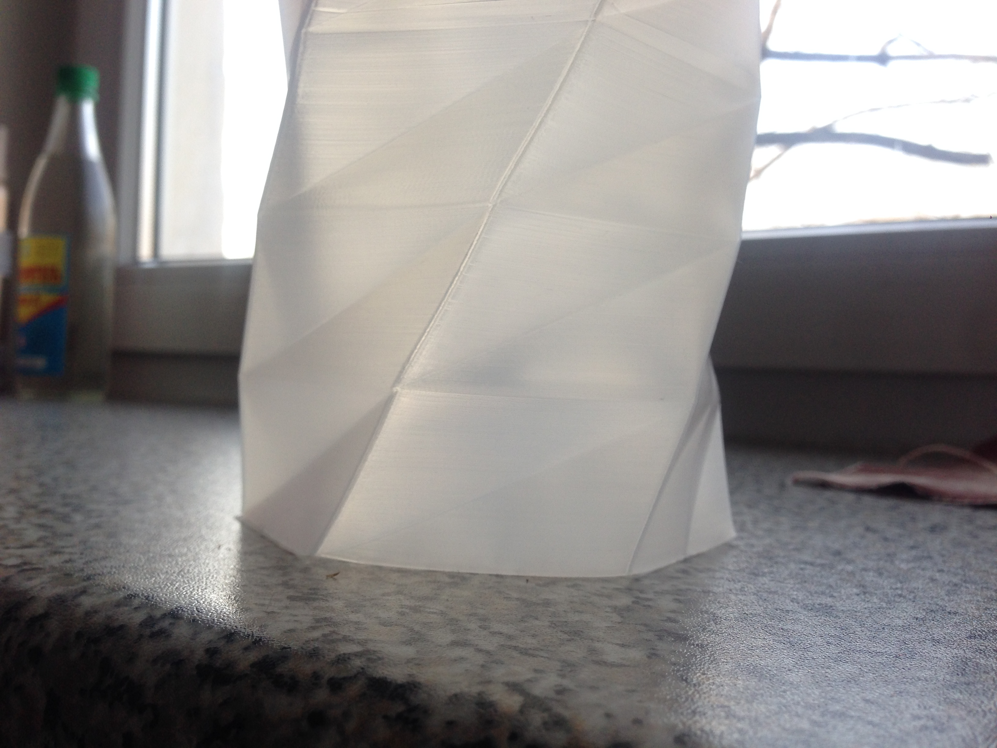

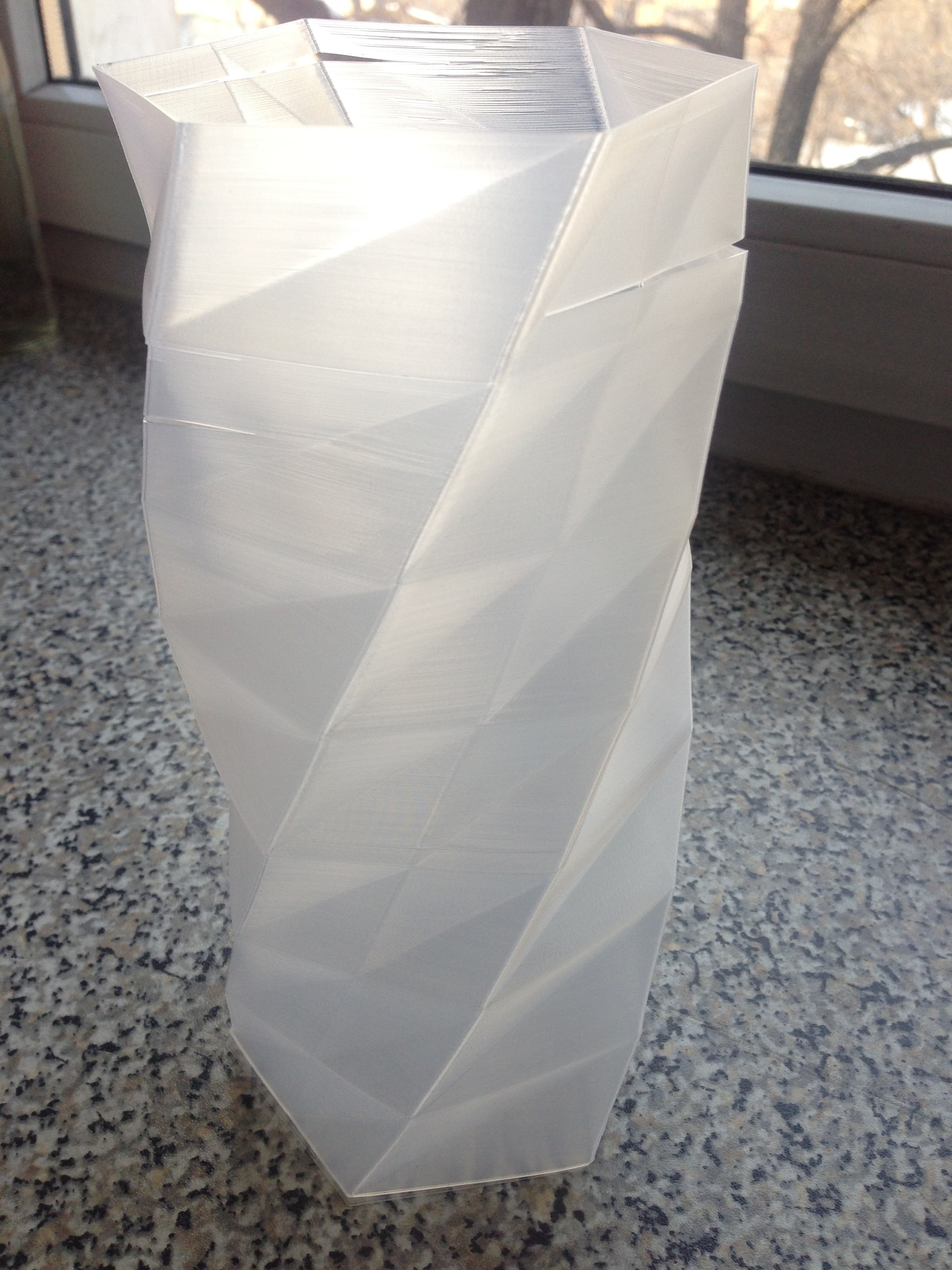

Here is photos of what i did. setting are about the sae .235C. 0.5 nozzle. 0.1-0.15 layer. speed 30-40mm/s.
There are delamination on the top of the vase. I wanted to see how far I can go squeezing it. Not far at all. I printed it with only 1 (Simplify3D) shell. Should I go for 2?
As well bottom of the vase is deattaching. Might be because of only one shell.

As for the delamination, maybe the layers aren’t fusing together. Increase extruaion temps or turn off the fan… Both should slow the cooling and possibly help with fusing of layers.
