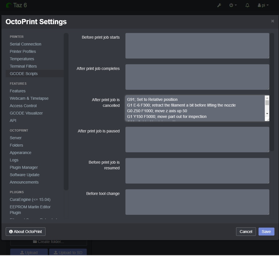

Octoprint gcode scripts:
After print job is cancelled -
G91; Set to Relative position
G1 E-6 F300; retract the filament a bit before lifting the nozzle
G0 Z50; move z axis up 50
G1 Y150 F5000; move part out for inspection
After print job is paused -
M600 Z50; pauses print then moves the print head up 50mm so hotend doesn't burn model

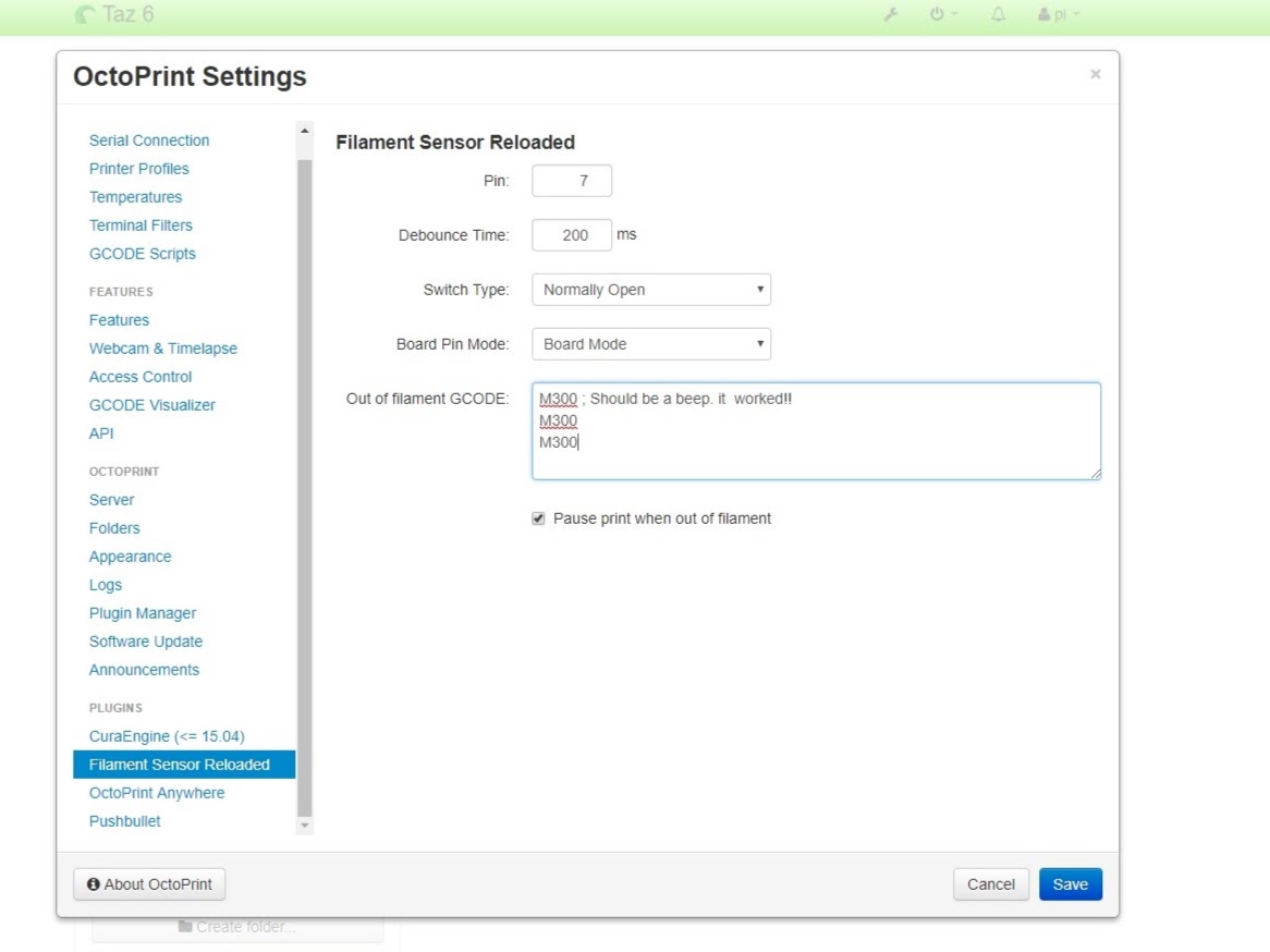

Filament Sensor Reloaded (pluggin page)
Pin 7
Debouce Time: 200 ms
Switch Type: Normally Open
Board Pin Mode: Board Mode
Out of filament GCODE:
M300 ; beep sound
M600 X220 Y17 Z50 ; move Z up +50, move bed to rear for easy access nozzle
Pause print when out of filament u[/u]
GCODE Scripts
; M601 ; pause print
Before print job is resumed
M602 ; Resume print

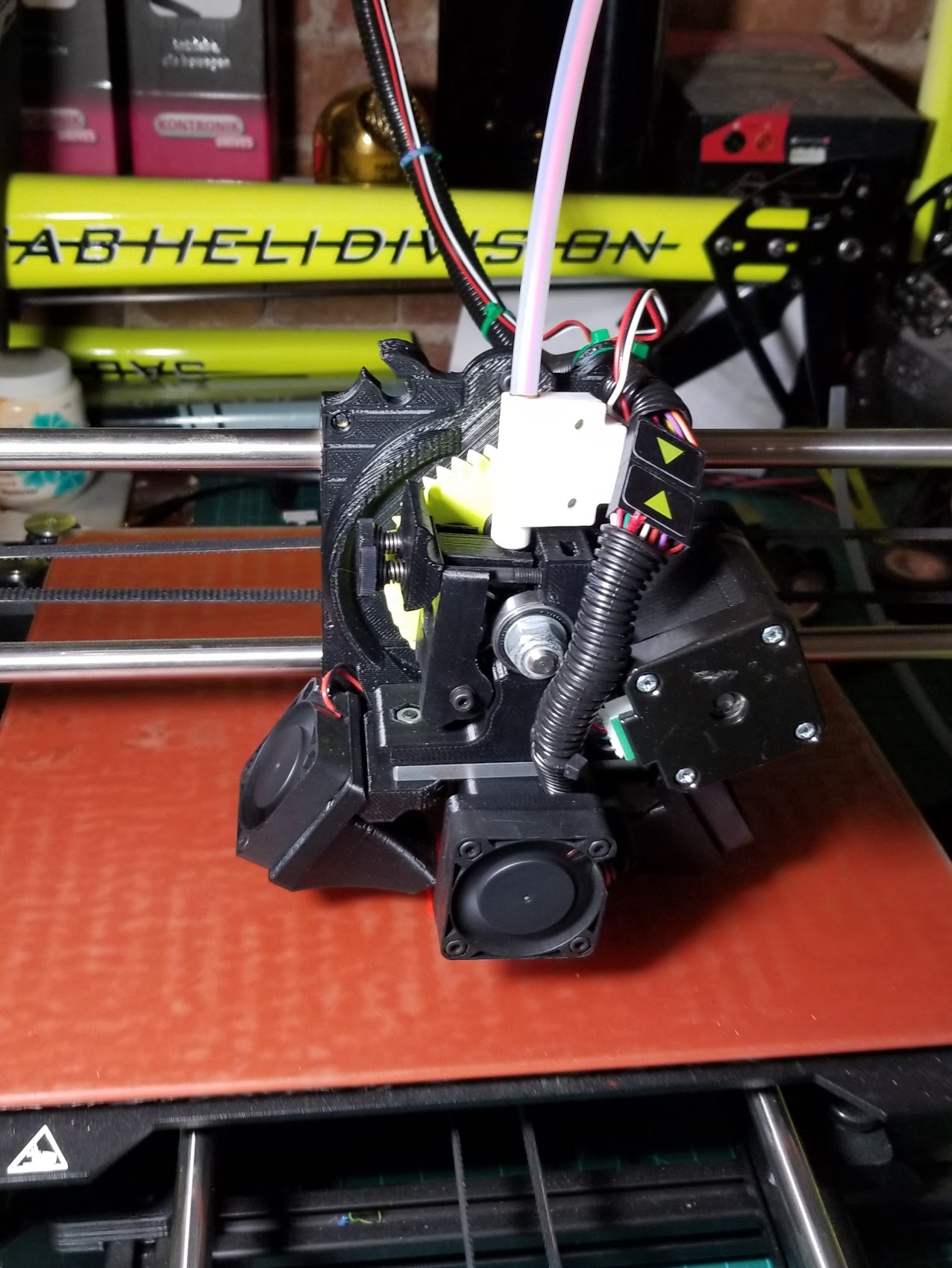

Did you mount this sensor to the print head so it won’t move? Or is it free floating?
Its free floating. Works pretty well like that.
I lack the design skills to make a mount for it. But I’m learning slowly.

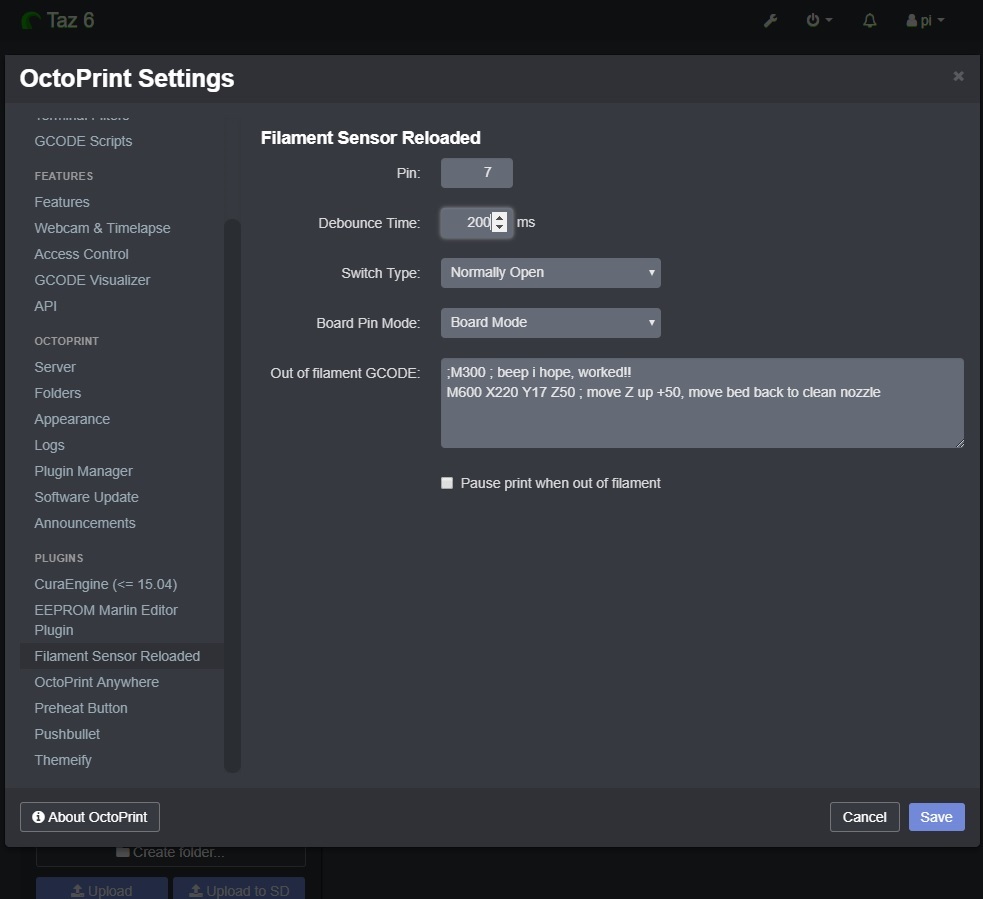

Updated Instructions
Filament Runout Sensor Pluggin setup:
;M300 ; beep i hope, worked!!
M600 X220 Y17 Z50 ; move Z up +50, move bed back to clean nozzle
leave “Pause print when out of filament” unchecked
GCODE Scripts
Leave blank now - No other commands needed as far as filament changes go
After print job is paused - “empty”
Before print job is resumed - “empty”
The wiring for the sensor is same as 1st post.
