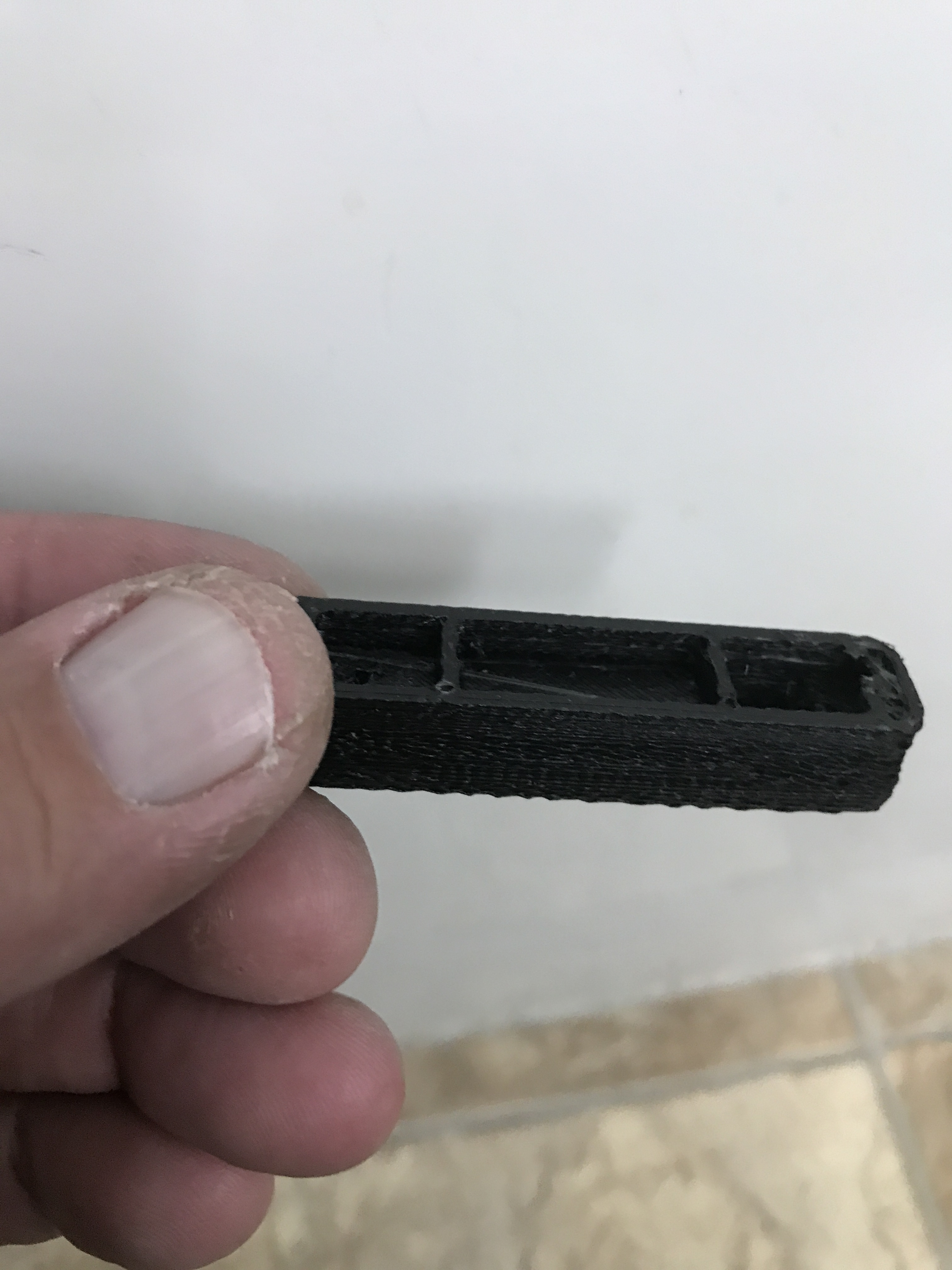

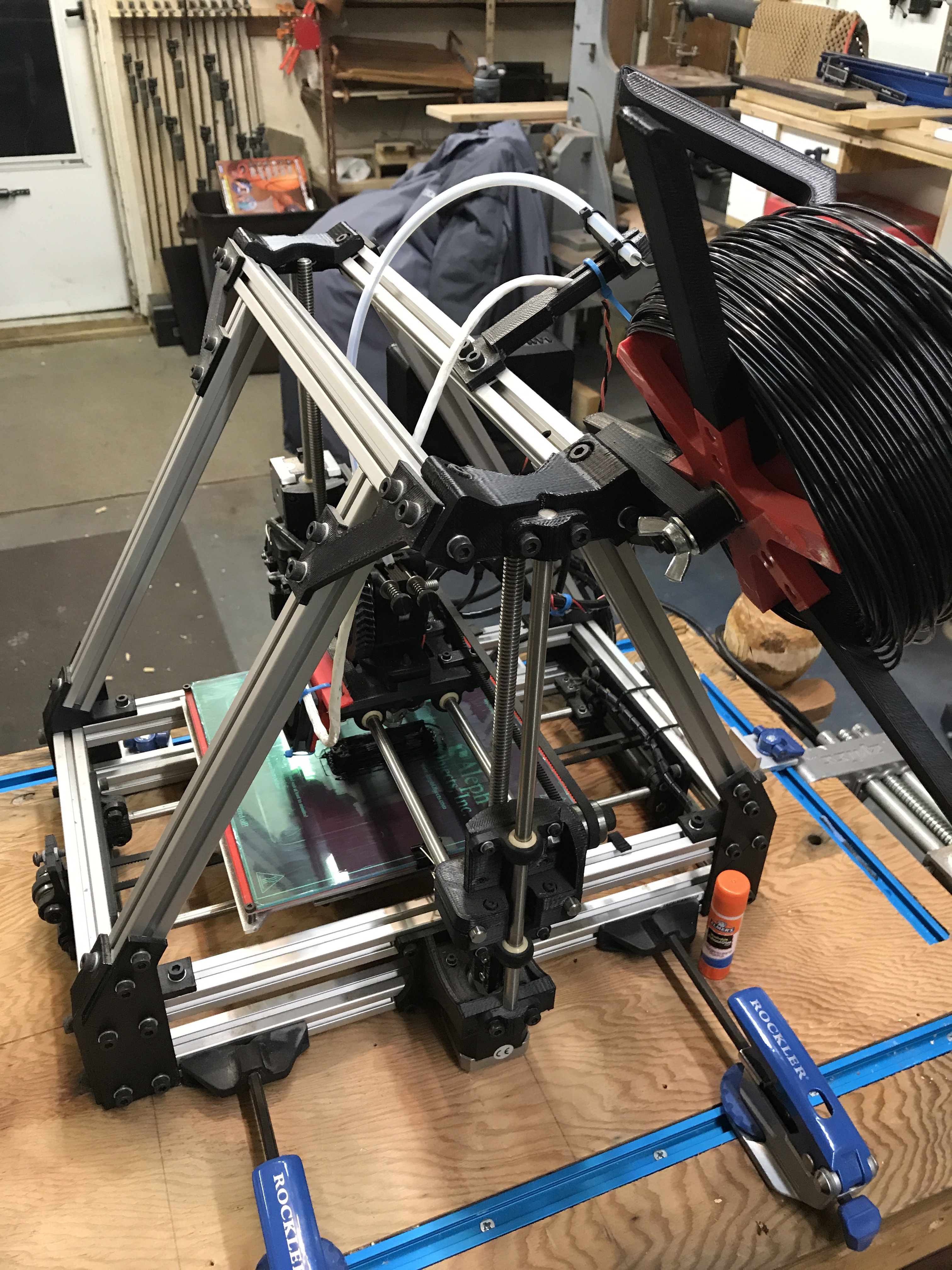

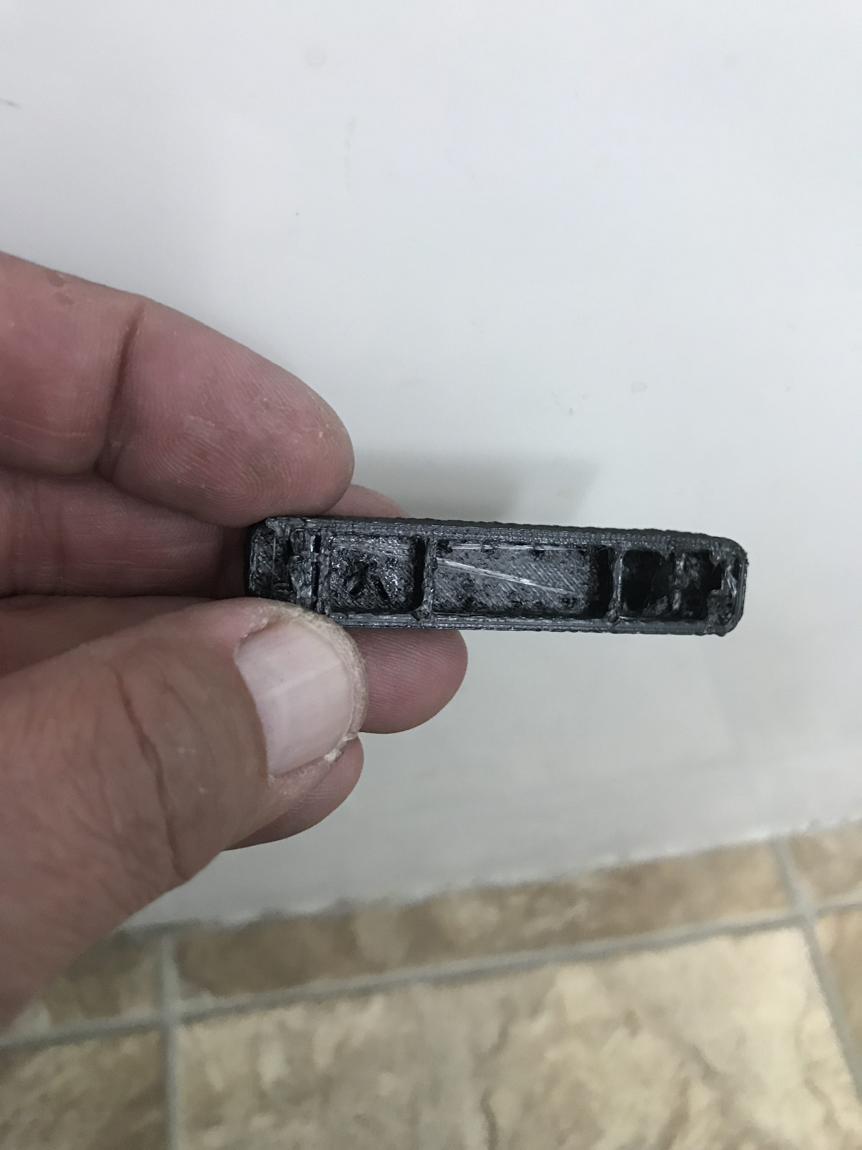

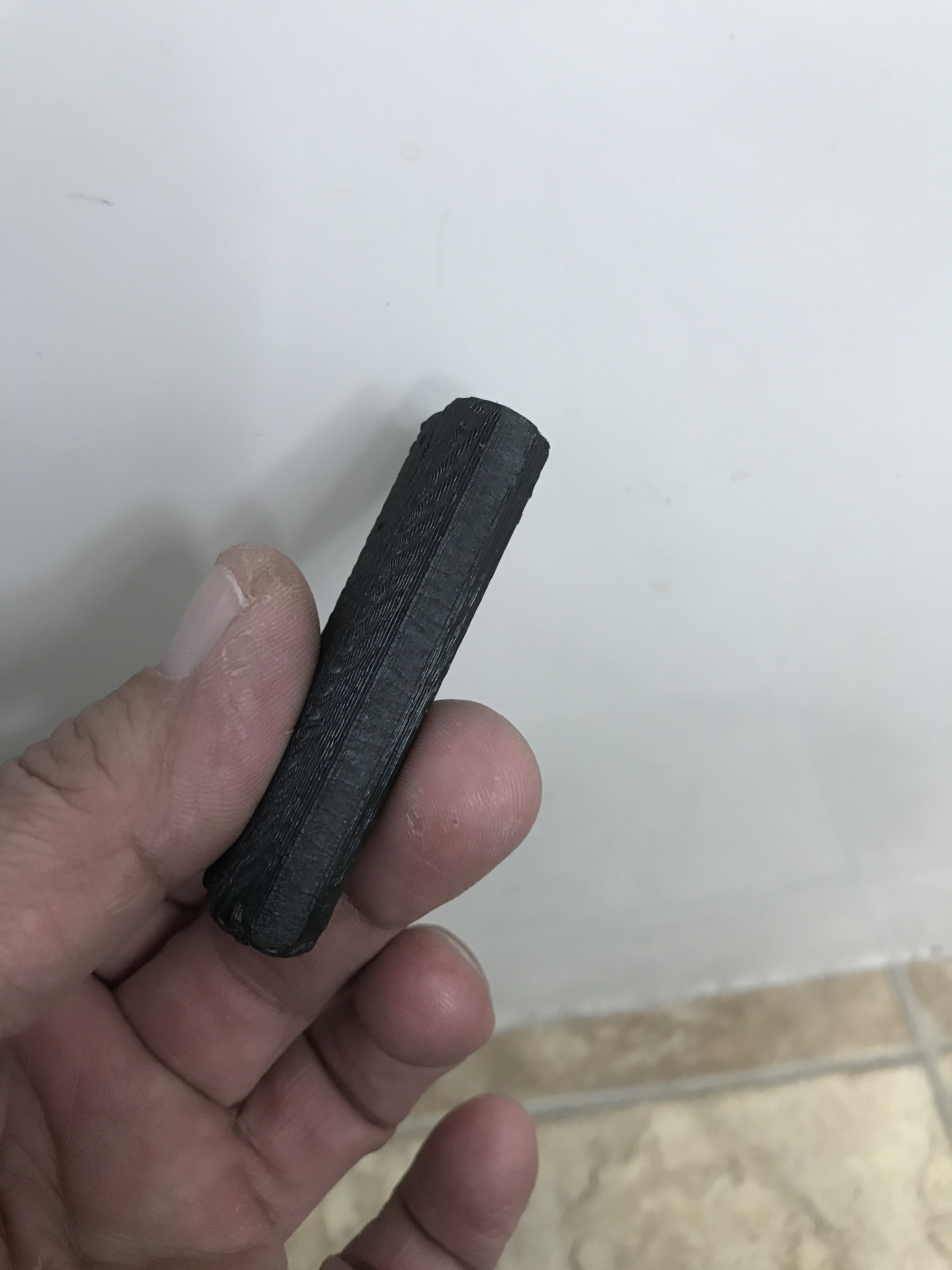

It’s working! Big shot to Piercet for all the answering to my stupid questions! Not the best print and ended up coming off the bed 2/3rds done but I’m still happy!
Congratulations!! Once you get it printing right, dialing it in is the fun part. I would definilty reccommend getting a PEI sheet to stick on your glass bed right away, that will make adhesion much easier and it only requires raising the Z endstop target enough to adjust for the thicker piece.
Yes I have one and used it but it still broke off. I am trying glue stick and a raft at this very moment. Should I be heating the bed with PLA? I read you should use 60 degrees Celsius. Is that the issue?
