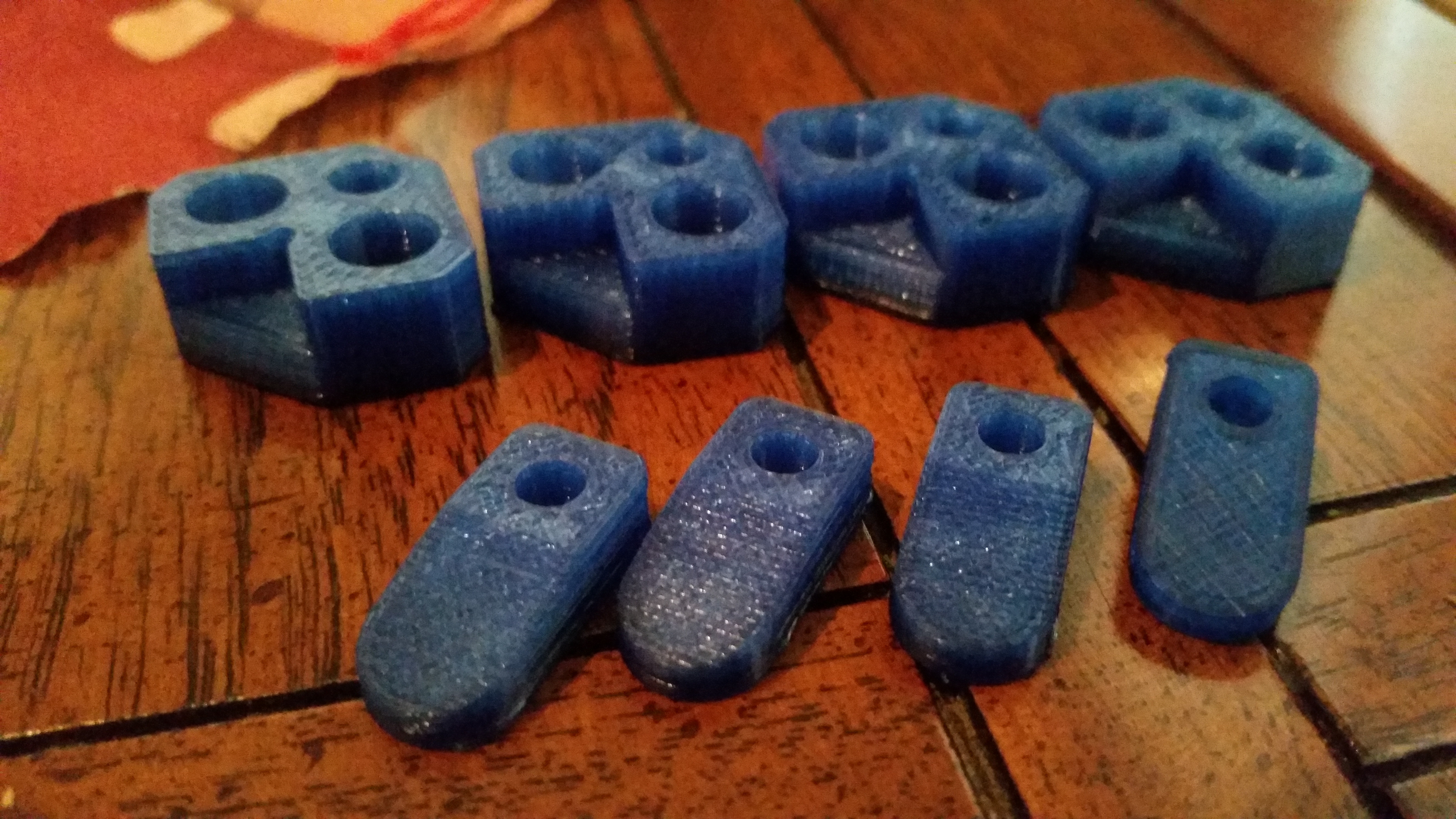

I set my nozzle height set so that ABS prints pop-off / releases at 55- 50C. You can hear the snap, crackle and pop of the object releasing at it cools from 65C. Sometimes they need a little help using the clam knife or similar flat tool to wedge between the PEI and object. My print bottoms are smooth with little to no striations from the extruded filament (use .2 Z-offset to get a completely smooth bottom). I don’t think you can get the nozzle height dialed in better than that…

I used to experience bubbles like that when I first got my taz and they used PET sheets on their beds. I was having issues with the prints sticking to the bed and tearing of the pet also. So I ordered a 100$ printinz 12" taz build plate and clipped out to my bed. It worked ok, for about 3 prints, then nothing would stick, and I found myself back at square one. I did some research and came to PEI. When I went online to purchase some they apparently were having a shortage problem from the extreme demand that PEI recently fell into. So I went to amazon.com and the only reasonable thing I could find was a 12x24" x1/8" thick piece. I repeat I ordered 1/8 inch thick PEI. I scored it in the middle with a utility knife and square on both sides and snapped it into 2 pieces so I would have a spare (1 year later and still using first one!). then using double sided 3m, I stick it to the bed.
After using this for a year, I never have to worry about any filament coming loose, air bubbles are non-existent, no tearing/ripping, heat bed works same as with thinner PEI. Of course you still need to use a glue stick, but this stuff is indestructable!
