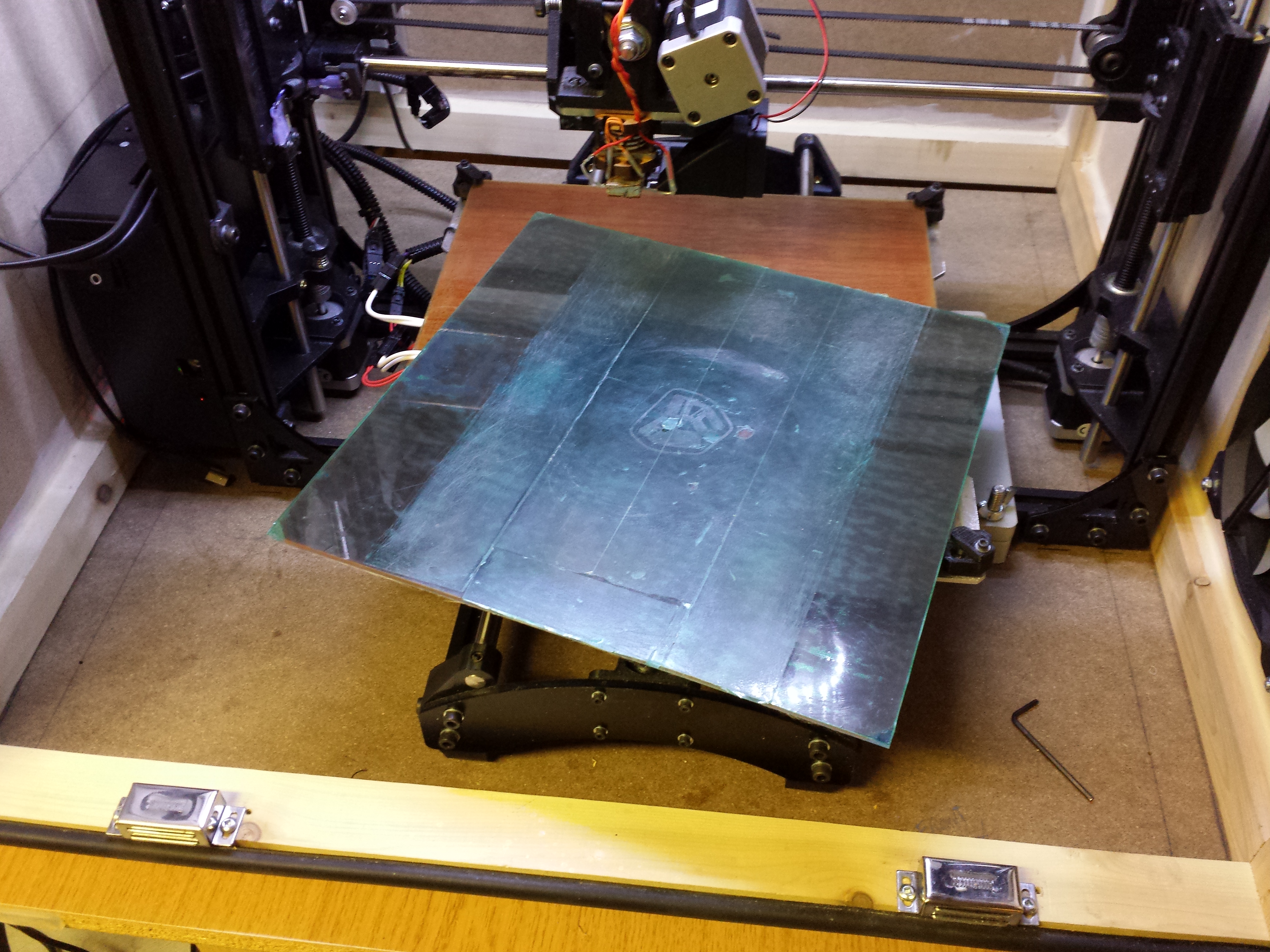

Here is my bed removed from RazzMaTAZZ, along with the tape, the PEI (note that the McMaster has both sides covered with a protective blue film), a hobby knife and a bottle of isopropyl alcohol. Not shown are lint-free paper towels and a pair of scissors and a plastic scraper. I am using the McMaster .04" PEI and 3/4" tape since all other widths are currently backordered on Amazon too.

The #1 requirement is to make sure the glass surface is absolutely clean. I clean and rinse with isopropyl alcohol to remove all traces of grease and moisture. Once clean, do not touch the surface!
First, apply your tape to the glass. I lay down strips starting at the one edge for rectangular beds and work across the plate. The tape has a paper film on one side, leave that attached until all strips are installed. Try to keep the tape smooth and wrinkle free. Leave a 1mm gap between strips, do not overlap the edges of the tape as that will create a lump in the PEI. Allow the tape to extend about 1/4" past the edge of your plate.
Once all the tape is applied, I like to burnish it down with a soft plastic scraper. An old credit card works fine too. The idea is to smooth out as many bubbles as possible. Finally, use a hobby knife to trim the tape as close to the glass edge as you can. This eliminates clumps at the perimeter later when you apply the PEI. Use a hobby knife and a cutting board, you can use the edge of the glass to guide the knife blade.
