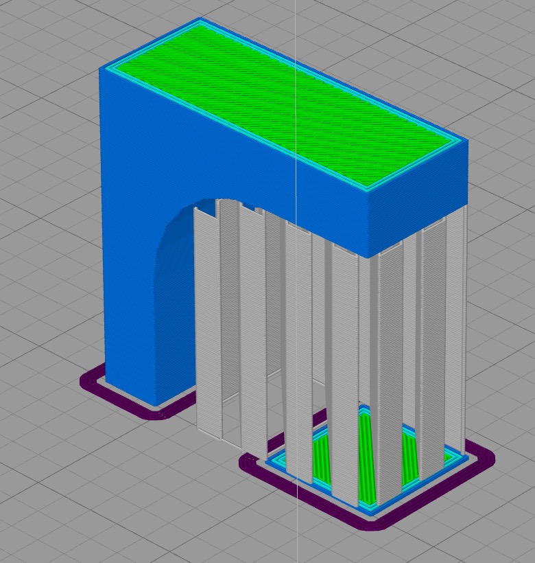

As a last resort, import the attached STL and place at the bottom of the support. May need to set “Lower Vertical Separation” to 0. It should provide a platform and anchor. Scale the .5mm square as necessary.
Base_20-20.stl (1.85 KB)

Would you try kcchen’s method of distributing chicklets under the support? If that works for you I’d love to know that – I might re-buy because the other end of the supports, where they attach to the pieces, is pretty awesome.

Out of my own curiosity, here’s a pic of the support anchor suggested above.
