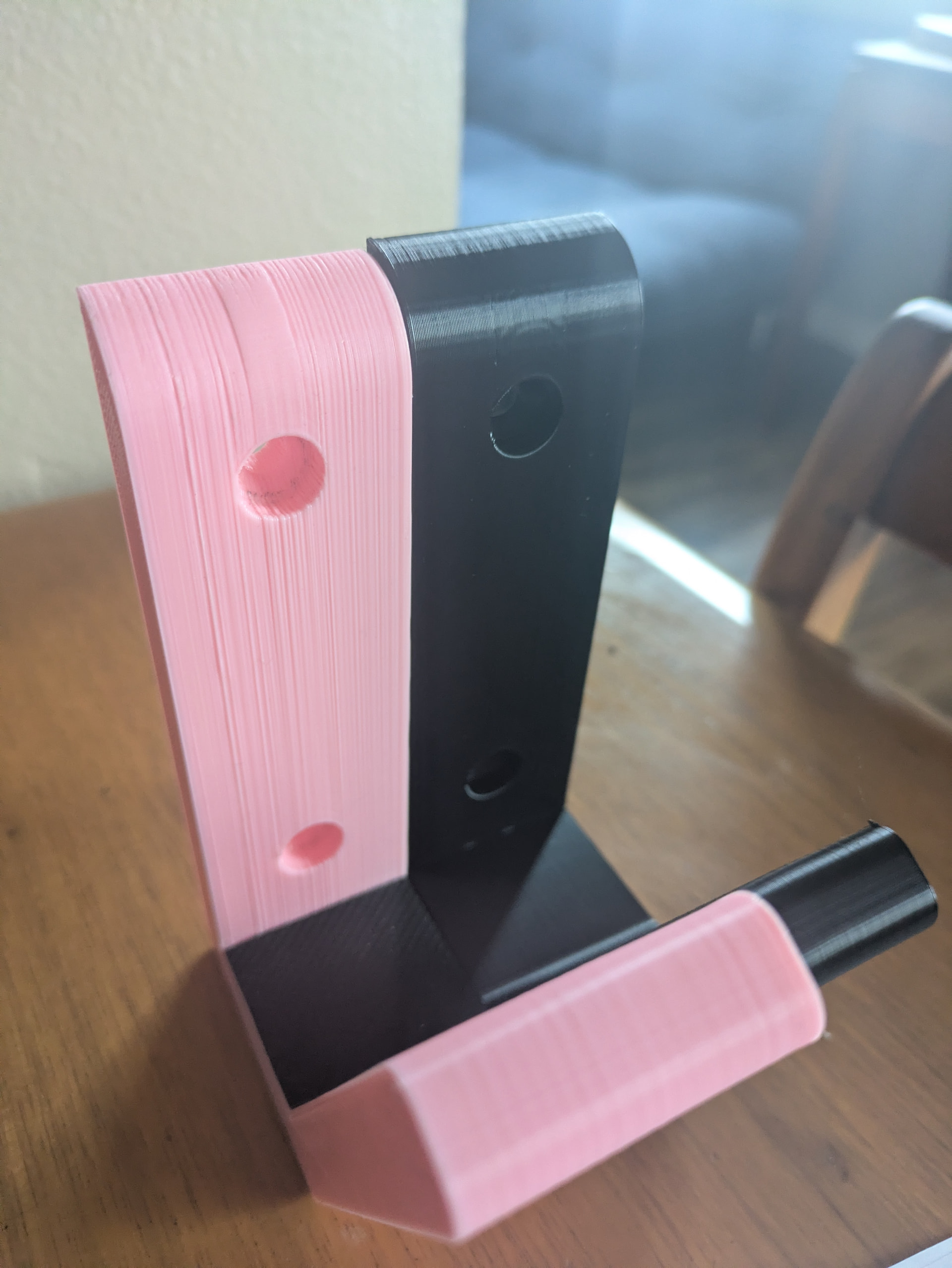

Hi there, I just created an account to say thank you! I have two (3rd gen) mini 1s, and it was definitely doing some form of this z-banding.
I did most of your fix to one of them and this is the result:
(I didn’t reprint any of the original printer’s parts, just removed the bearings and installed new couplers)
They are slightly different parts, and I sanded the pink one to make it smoother, but you can see the black print is silky smooth comparatively.
I will warn people who might try this - the set screws in the original couplers on my machines had/have red loctite on them so they are not easy to remove and replace - I had to cut/drill them out. I’m holding off on doing the second printer because it doesn’t have the same issue at the moment.
Thanks again @zenotek - I can confirm your solution above by works!
Another thing I will note after doing @zenotek ‘s modification is that when the gantry moves down the screw at the start of a print it definitely makes noise now. It doesn’t affect the operation of the printer. I’ve printed several prints with this mod, and they all have come out perfect. It does not make the noise when the gantry is moving up or printing.
