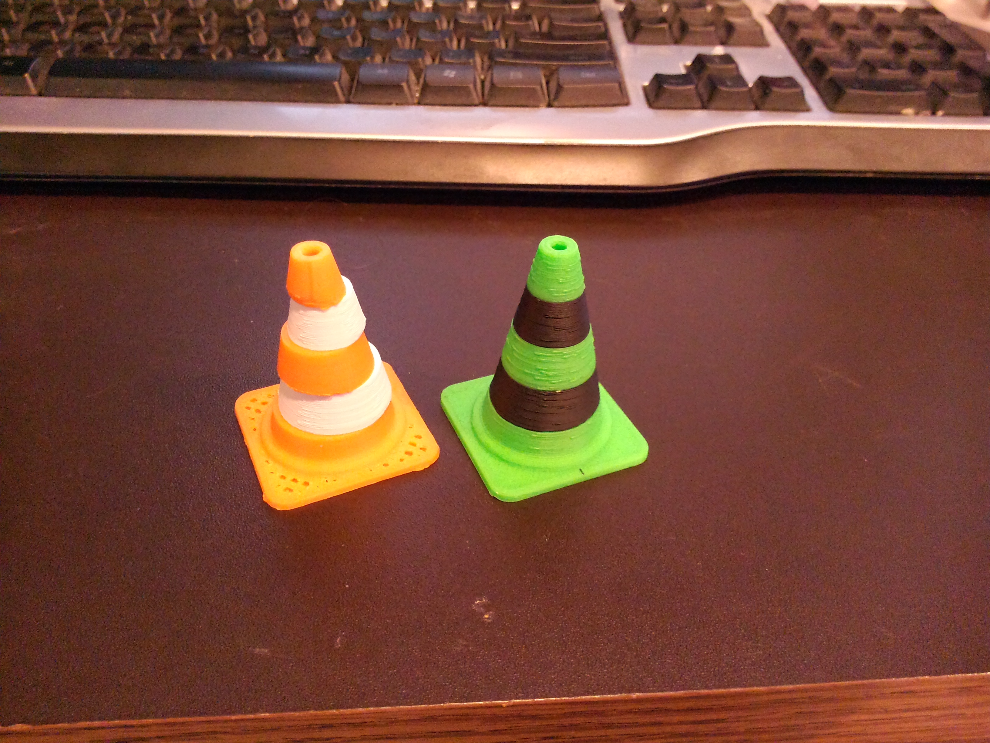

Yes, I ran through the alignment process. I did the square test. I plugged in values to slicr. I got it to print the squares all fine and dandy. Centered as best as you can mesaure it on the print plate.
Then I printed the large cone via Simplify3D. I used the same figures as from slicr. And it came out looking like that, offset by a considerable amount. So I shrank the cone down (to use less materials) and proceeded to re-align it. In virtually every print, the white (flexi) would print ever so slightly larger than the orange (budda). As you can see I downloaded a ring test object and started using it (even less material).
Thinking I got it aligned I printed the dice. The white dots looked like they were in the right position. I tried playing with the settings to get results like I did with the hex. I never did get it close. I gave up started the octopus and went to bed. That was my surprise for the morning. A God awful mess. After work, I played again for another couple hours and finally gave up and put the hex back on.

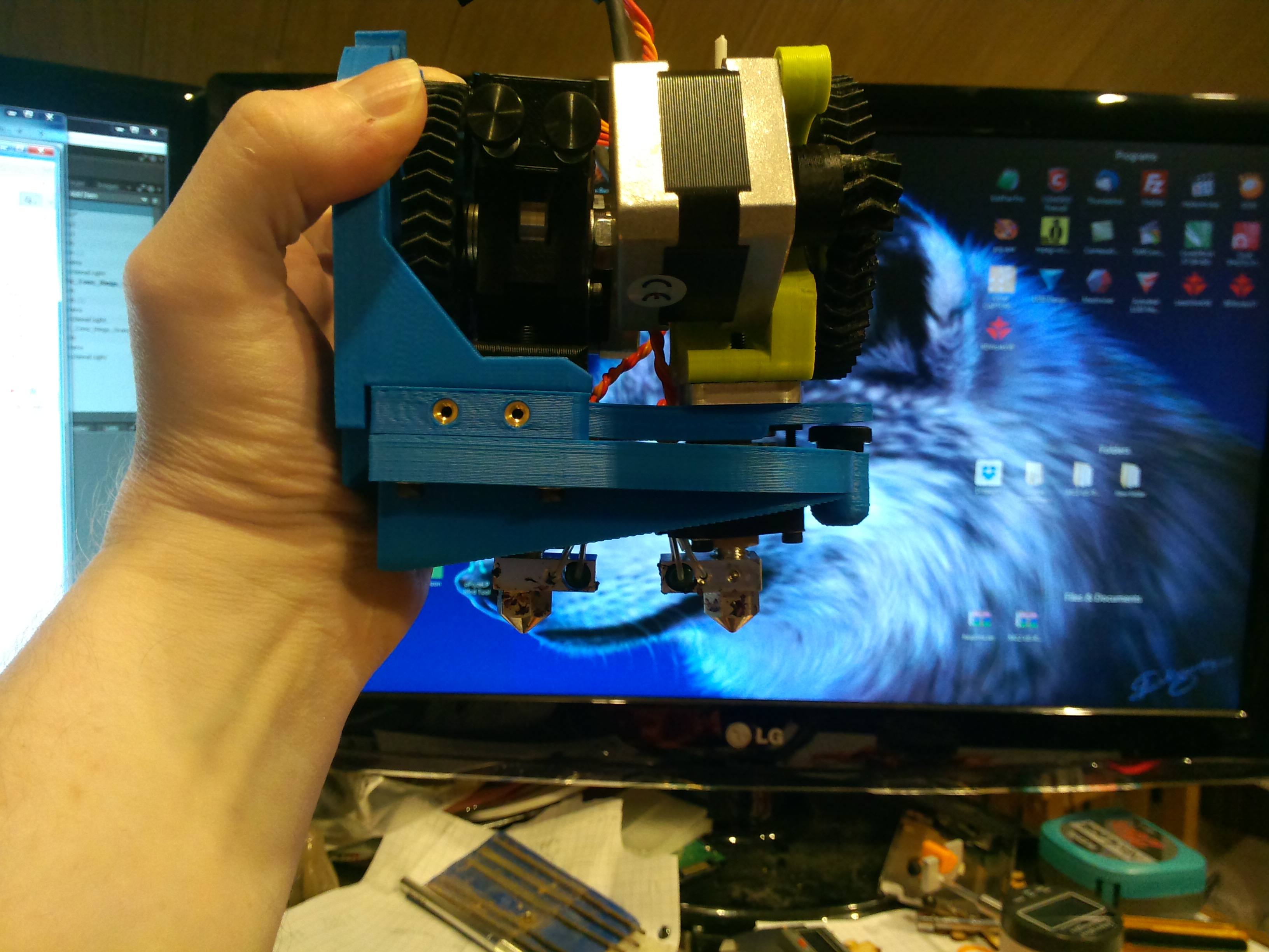

As you can see, its warped in both the X and Y planes. No wonder I had a hell of a time getting it aligned. I am also wondering if it was warping during use and constantly changing. That, at least, would account for the extreme variation in positioning.
Here is the flexi-dualie rebuilt with a plate I printed:
I think that looks more like it should :slight_smile:
Say, anyone got a low quantity source for those imbedded nuts that are in the old plate? I would like to put them in my plate, even if they aren’t used right now.
Are there any tips for alignment while I have it dismounted? I mean is there anything mechanical I need to do after assembly?

Ps In simplify 3d, the Y axis is reversed from Slic3r. So the Gcode offsets you enter for tool 1 (the second extruder) have to have the same value for x, but for y, you need to put in the absolute (positive) value of the y value you entered in Slic3r
THAT explains a lot! You would have thought the guys from S3D would have mentioned that in at least one of their emails I got on this matter. Anyway, I have resorted to putting the offsets in the firmware, that way the gcode doesn’t have to contain it. Think it will be easier in the long run. First print off the bed and I am within 1mm in the Y and looks like right on in the X. Printing test 2 right now.

Well, I would have to say that the rebuild with the new plate was a success. Green is ABS coming out of the flexistruder, black abs from main extruder.
I still gotta get retraction right as well as feed rates but as far as alignment goes, I think I got it darn close. Maybe 0.01mm off.
