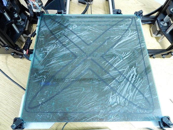

That gcode prints a single layer pattern across the bed. After it completes, take a look at the width of the print lines and adjust your corner screws so they are consistent. There is a picture on here as well as in the manual, I believe, that gives you a reference to what the print width / height ratio should look like for the first layer. I usually end up adjusting the z end stop in combination with the corner screws to get everything sorted out.
Don’t hesitate to print 5 - 10 of these with adjustments between each to get a good set up.
Okay, so I ran the gcode. Everything stuck, looks like all the lines are equal width and height.
Is that basically what I’m looking for?
Yes. Now you can print some parts.

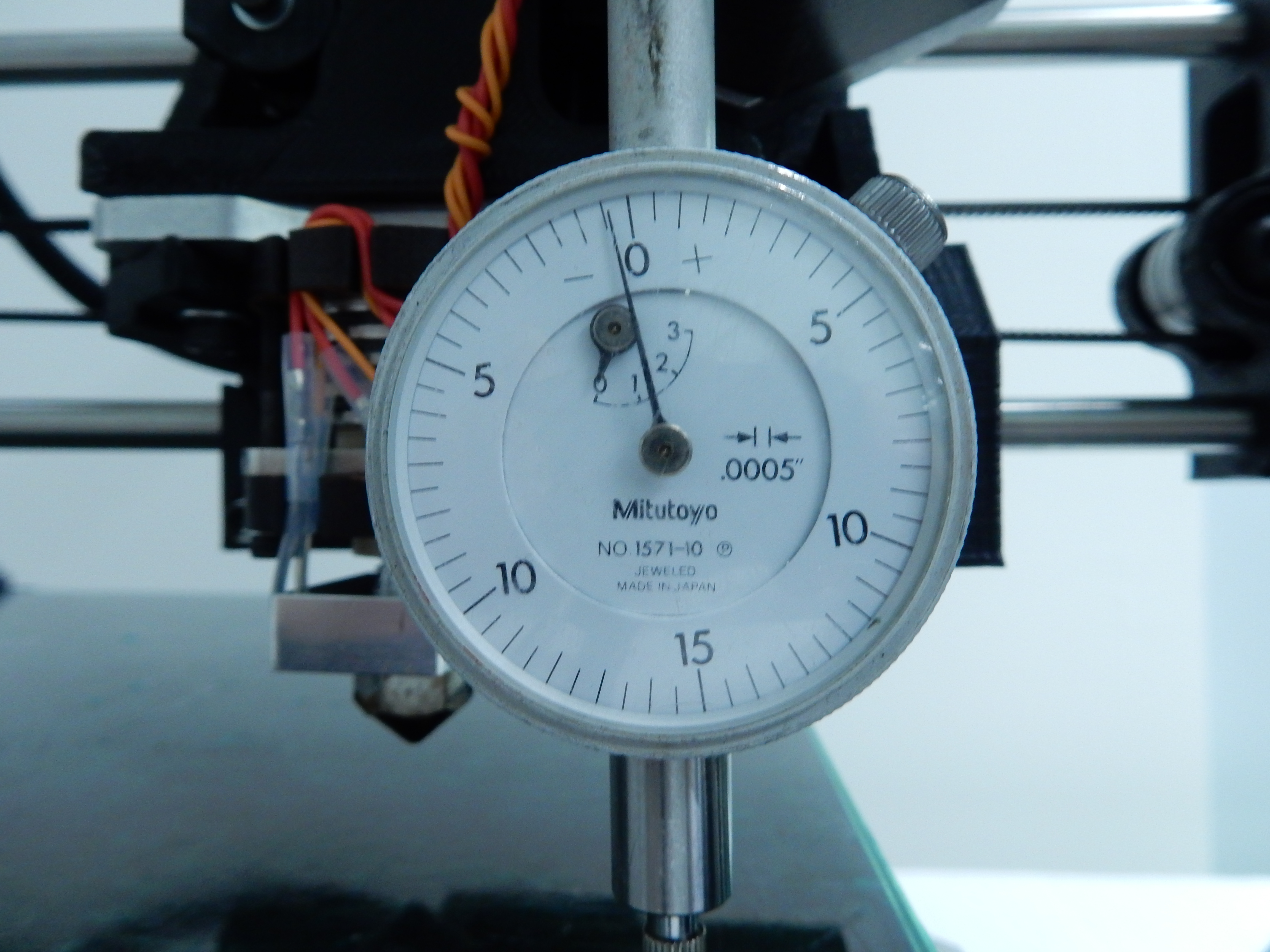

I’m seeing a deflection of x-axis rods of about 0.007 inches from “home” position to far right of stage.
Now I realize I’ve added weight to the carriage, so the deflection of the rods might be less without my runout gage, but this still shows quite a bit if difference across the stage.
(you guys get the rhyme for free :mrgreen: )
You will always see a run out across the x axis. Especially if you have the dial indicator mounted to the front of the extruder assembly. The x rods flex. The x axis rails need to be a larger diameter or supported or just replaced with a profiled rail to eliminate the flex. This irritated me early on as well but after several posts and comments from others here as well as the Lulzbot folks, I realized it doesn’t really affect the print.
After you have your bed leveled using the bed leveling g-code, move the extruder to the center of the bed and set your home gap to 0.005". Then, set up a smaller part to print in the center of the bed. Then, print the same part at the left or right side of the bed. You will probably find that it does ok even though there is a variance in the extruder tip to bed gap between those two build locations.

I understand there’s a variance. Now I’m proving it.
A gap of .005 in center equals a gap of upwards of .010 as you move closer to the edges.
Sounds “normal.” :smiley:

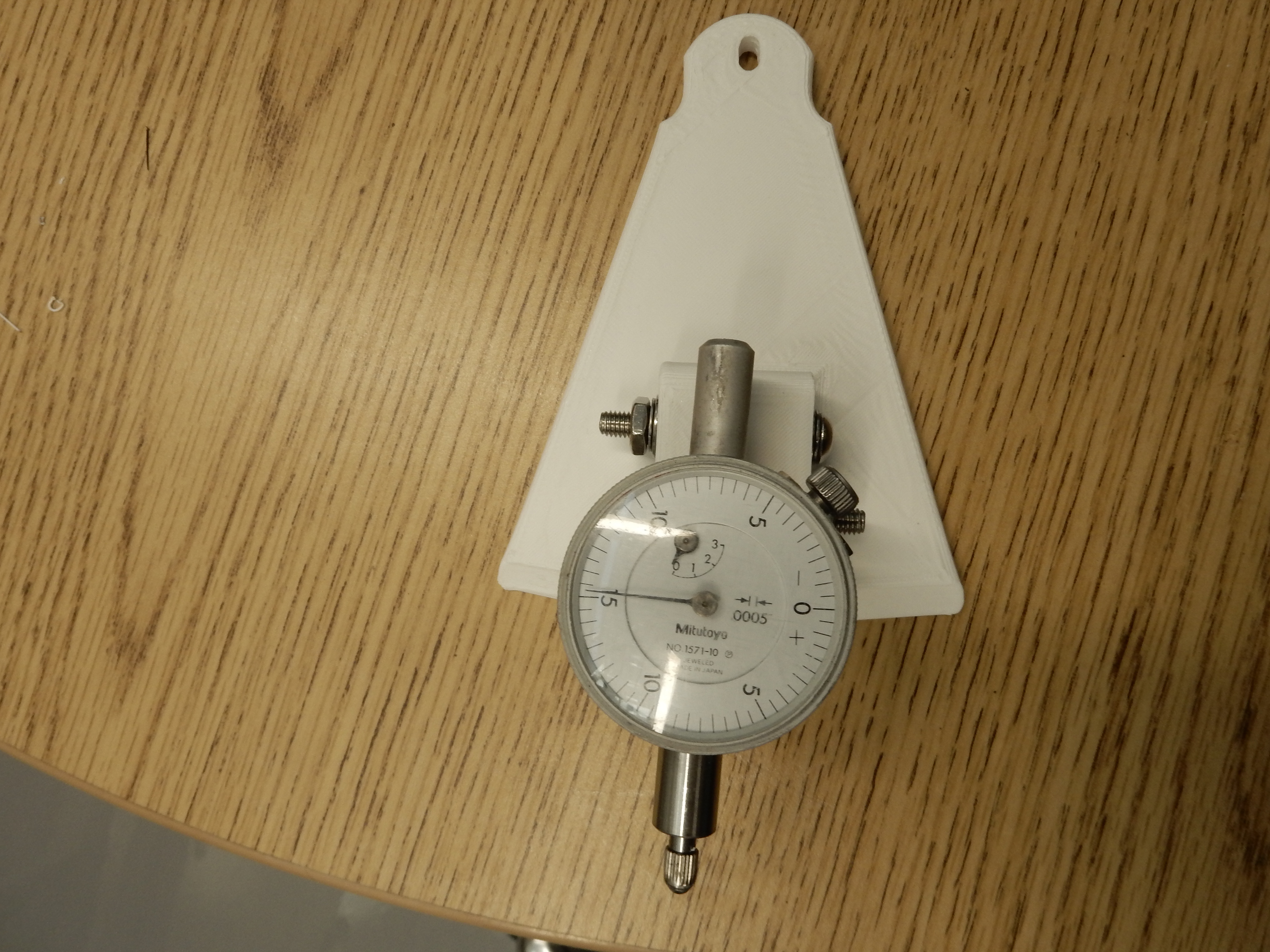

Made this. Remove entire extruder head to relieve weight from x-axis rails. :smiley:
Borrowed design idea from Thingiverse. http://www.thingiverse.com/thing:551366
Cut down size a bit.
I have been using the thingiverse version of this for a while. It is amazing how that “upward bow” in the build plate goes away when you take the extruder off the x rails.
