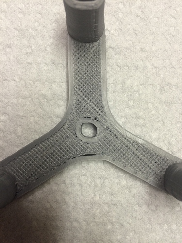

Ok, so I ordered the Kittaz, put it together, and printed a calibration cube. I love it, it worked great. However, when i go to print a circle, or round objects in general, I get problems with the shape. I have looked for answers online, I’ve calibrated the x-axis, y-axis, and z-axis steps. The surface is leveled, the extrusion steps are calibrated. I have no idea what’s going on, which leads me to believe it could be a software issue? I am using Slic3r and pronterface. Also, when i turn the speed down in slic3r, it doesn’t seem to change the print speed. Any help would be greatly appreciated.

I’m experiencing this same issue on my new KITTAZ. It is due to backlash resulting from very sloppy linear bearings (the Igus bearings) on my machine. The fit of these is really poor - I can measure .5mm of slop in them with a feeler. I have ordered hardened 10mm rods and ball bearing linear bearings from some eBay vendors I’ve used in the past. This will eliminate the slop and backlash.
There are other contributors to backlash too that you should check:
  1. make sure the belts are tight (but not too tight)
  2. make sure the pulleys on the stepper motors are secure (the set/grub screws)
  3. test the Y axis by grabbing the front corners and pushing (gently) side-to-side. If you feel any movement, you should start by adjusting the linear guides as per the build manual. I was not able to remove the slop completely without causing binding.
  4. test the X axis by grabbing the left and right and checking for slop. See 3 for fix.
  5. may as well check Z while you are at it - first the left then the right side.

If you rotate the part 45 degrees and reprint it, will the misalignment in the circles follow the rotation?
There’s been numerous posts here about misaligned circles. Almost all appear to have turned out to be belt/belt tightness related.

I have found an excellent way to take the slop out of my Y axis at least. First I measure the distance between the ends of the rods and make sure they are exactly 5 7/8 inches center to center. I have made a jig to hold them exactly that far apart. I then loosen the 4 bushing mounts on the table and rotate them so they are snug against the rods, removing the slop. I rotate the left rear and right front clockwise, and the right rear and left front counterclockwise. I then check the bed for smooth motion from end to end. This has virtually eliminated any slop in my Y axis and greatly improved my print quality.
