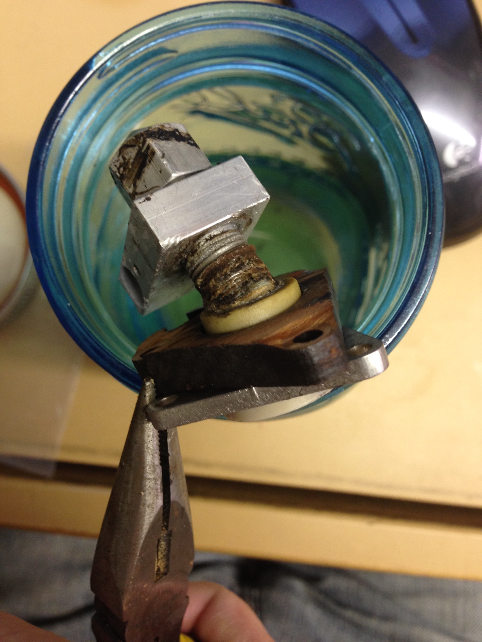

I set it to 235 and at the most I don’t think it registered over 240. It was did a few weird little spike ups in temperature curve as it was warming up. I have never seen it do that before.
I am kicking myself for not taking a screen shot of it.
Do you think it could be the thermistor going out? I just put in a brand new one about a week and half ago that I had bought from Lulzbot.
Oho- potentially… What’s the thermistor resistance at room temp? How centered was the thermistor? You may want to PID tune the hot end prior to heating it up again. PID tune it at 230 first. The PEEK plastic insulator doesn’t fail until you near 250C. We’ve printed at 235 with no issues before. Were you running the fan? What material were you using?
I will check the resistance when I get home. I have been getting beautiful prints with the Lulzbot black abs and everything was working perfectly up till last night and I hadn’t changed any hardware or settings.
What’s the thermistor resistance at room temp? Going to check EDIT: 122 ohms
How centered was the thermistor? Fairly centered.
You may want to PID tune the hot end prior to heating it up again. PID tune it at 230 first. I rand a PID tune when I put the new thermistor in but I can run it again. Do you recommend updating the firmware with the values or using M301?
The PEEK plastic insulator doesn’t fail until you near 250C. We’ve printed at 235 with no issues before. I will check. If I left it on at 235 for an extended period, with the extruder not running, could that cause it? I don’t think I did but at the same time I wouldn’t put it past me.
Were you running the fan? INo, I thought you didn’t need one for ABS unless you were using an all metal hotend.
What material were you using? Lulzbot Black ABS

It’s not recommended to leave the hot end at extrusion temperatures when idle, but it shouldn’t do that. We typically extrude our black ABS at about 230.
If I did it was a complete accident. I normally don’t fire up the hotend until its within 5 degrees of the target temperature.
I was extruding at 230 but a couple of my first few prints ground thru the filament and failed several layers in. Since I went to 235 no problems.(Until the hotend.) It could have been something else like the filament snagging on the new real but I din’t change anything except for the temp.
I guess I am down until, I can source some new peek insulators or scarp all my budaschnozzle parts and buy a new hotend.
We do have the PEEK insulator in stock- if you have any questions on how to replace it, feel free to email support at Support@LulzBot.com. If the thermistor wasn’t centered appropriately it could have been reading cooler than it actually was. It’s worth checking- you can probably do so without having to cut off the thermistor. If you email in, please include your order information so we can determine your warranty status.

Here is another photo of the damage. :frowning: Trying soak it in acetone so I can get the peek off.
