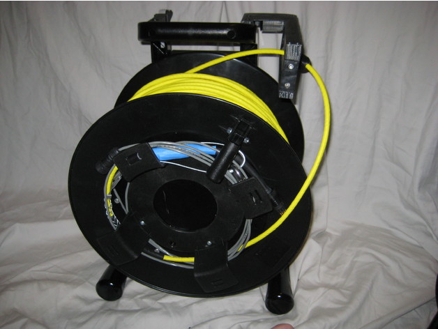

You can see a work sample here, the Lid of the control box in this project is made of it, the other parts are not.
I printed this using my Modified Taz, using my standard ABS settings at a temperature of 240 on a 105c bed. This was a large flat part, and I experienced no lifting with my aluminum core bed, which is normal. What really impressed me though is the corner definition. Usually with push and village plastics filament I tend to get small lumps in corners and occasional minor ringing on particularly fast prints. This time I was printing with my rapid settings, and it came out just as crisp and as clean as if I had printed it with my higher detail settings. It barely drips at all during start, and seems to be adheared as well or better between layers compared to both push or Village plastics.

Dimensionally it did fine, the lid matched up with the box printed from Push plastic ABS perfectly.
