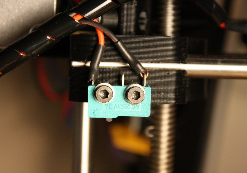

After a couple of weeks without printing, tonight I try to home the Z axis and it will only move up, not down.
The problem is the endstop getting stuck, it’s the third time now and this time I can’t “unstuck” it.
Last time I had purchased replacements at a local electronics store (almost identical endstops), but when I removed the rubber sheaths on the endstop’s contacts, I saw the leads were welded. Damn. Do they have too? I have no welding iron here, I actually never used one, I’ve never been an electronics kind of guy…
Norm, who’s gonna go to bed unhappy because he wasn’t able to print… :frowning:
Edit 2013-10-22: problem now fixed, but I have a new one…
So I just replaced my endstop and it still won’t work.
Either I don’t have a good enough contact (since I didn’t weld the leads), or the problem was not the endstop.
Damn. :imp:
Some more info: in Pronterface, if I move Z 1mm up, I can then move it 1mm down. But it won’t go further.

X and Y are indeed homed, but Z is about at 80mm height from bed and won’t go down.

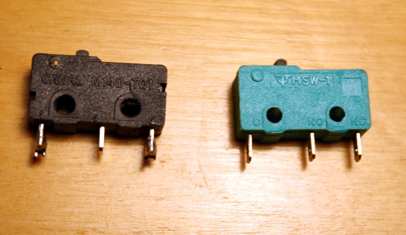

Well I have no idea which wire should be attached to which lead. The original switch leads are labeled “1, 3, 2” which is useless. The new one is labeled “C, NO, NC”.

According to the technical diagrams for that black switch, it should match the pins of the blue one. THe middle pin is Normally Open, the outer pin is Normally Closed
http://www.canal.com.tw/images/products/M140T01.htm
You really do want to get a proper soldier joint or crimp fitting on that switch though. Just wrapping that type of wire around like that might mean you aren’t getting enough connectivity for the loop to know it is actually closed. The heat shrink tubing on the red lead may theoretically have compressed the wiring off of the switch entirely. There also could be a break somewhere in the wire, or a loose connection back in the RAMPS board.

The switches I bought are green (I bought three).
The Canal switch’s pins are labeled 1, 3, 2. How do I know which number match C, NO and NC?
FYI I attached the black wire to NC, and red wire to C. It is how the X endstop switch is wired, if I assume 1=C, 2=NC and 3=NO.
Rather than the Ω setting I used the continuity setting as shown in the video at 11:15.
When I connect the leads to C and NC, with button released, the multimeter beeps, and when the button is depressed, there’s no sound. For C to NO, it’s the opposite.
I got the same result for the new green switches and the original Canal switch placing the leads on the same pins.

Yeah 1 is C, 2 is NO, 3 is NC. Sounds like your switch is fine, so it’s either your wireing harness back to the RAMPS board, or the RAMPS board itself. I’d check for a loose connection on the RAMPS board, or maybe a pin in the wrong spot? There also might be some fuses in there.

My colleague and I were able to locate the source of the problem. It was the black plastic housing for the wiring that was too loose. It was not making contact with the board’s pins. Removing it and plugging the wires directly works, I’ll keep it that way until I find a replacement part.
