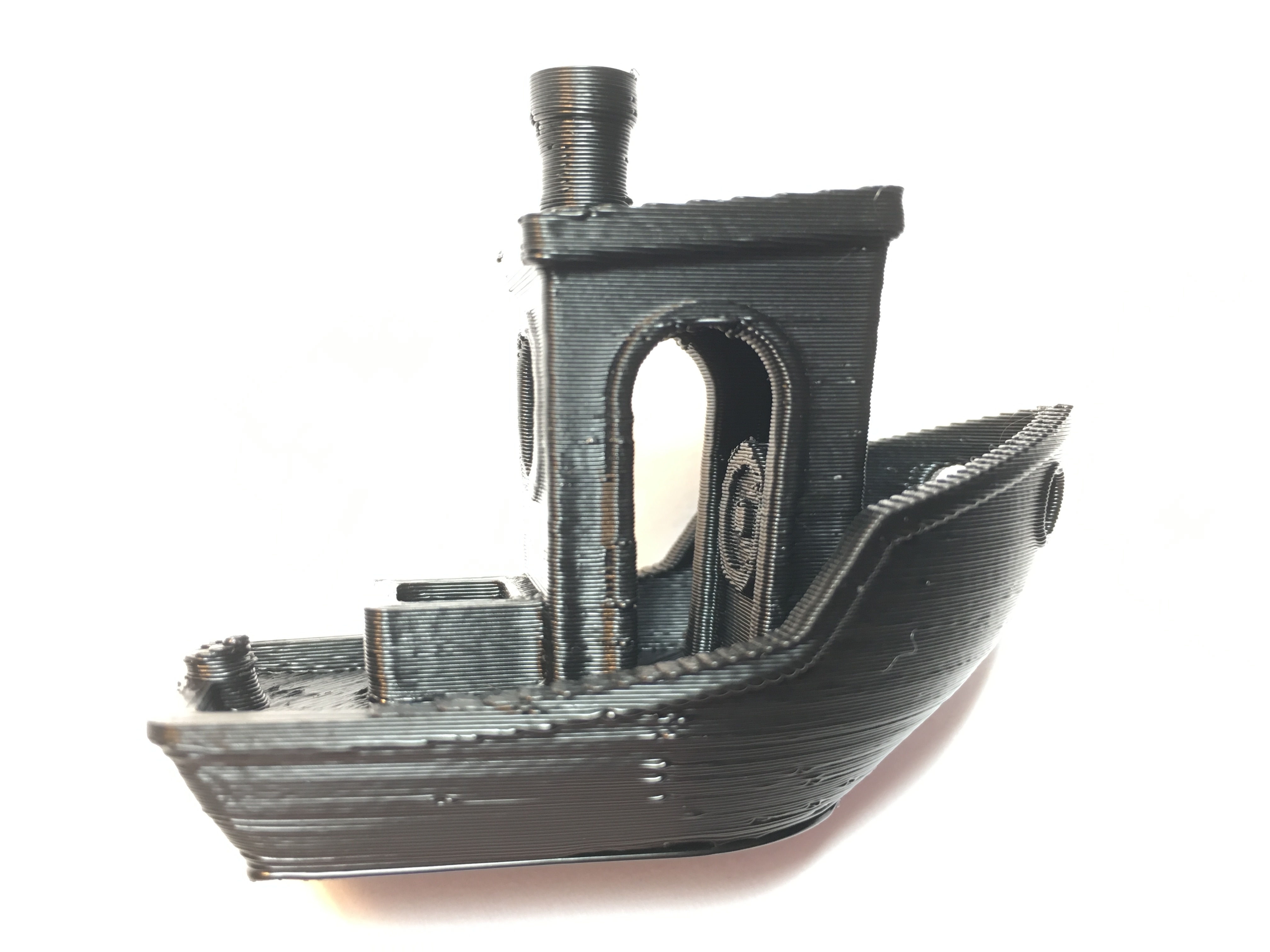

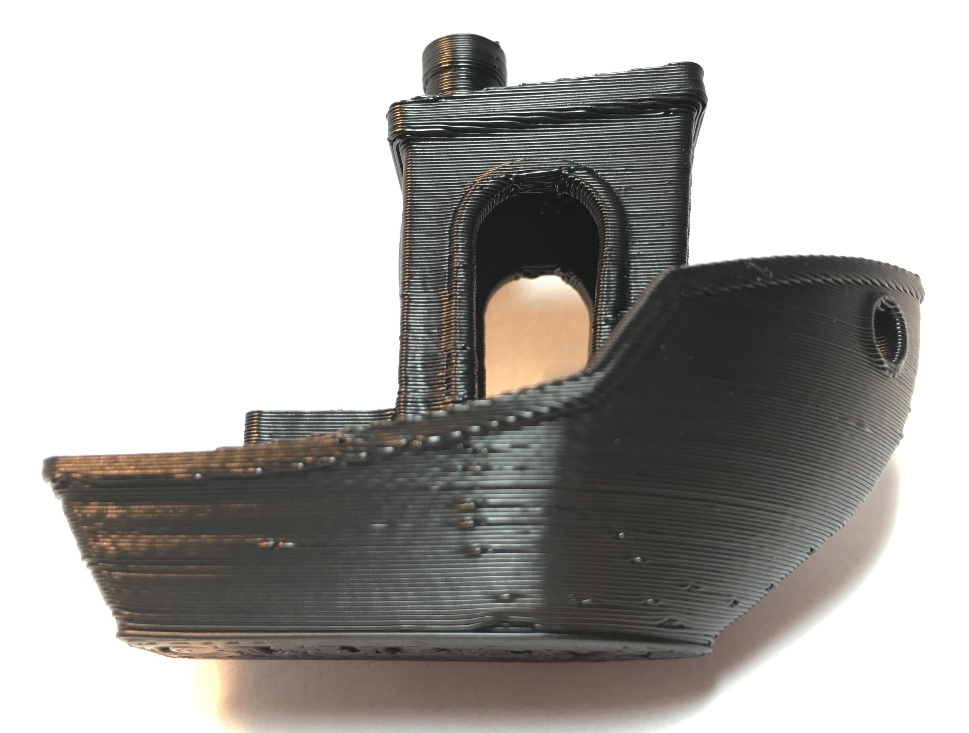

That said, I DID let myself tweak the Z knob just a tiny bit last night, and I printed a Benchy, so in my next post I’ll bombard you with photos of it. Then I’ll go reset my Esteps to factory settings and print another one – unless you prefer I stick with the cube?
Cura standard settings except for 3.00 mm filament diameter; nozzle temp 240º, bed temp 110º, Esteps at (modified from factory setting) 811.

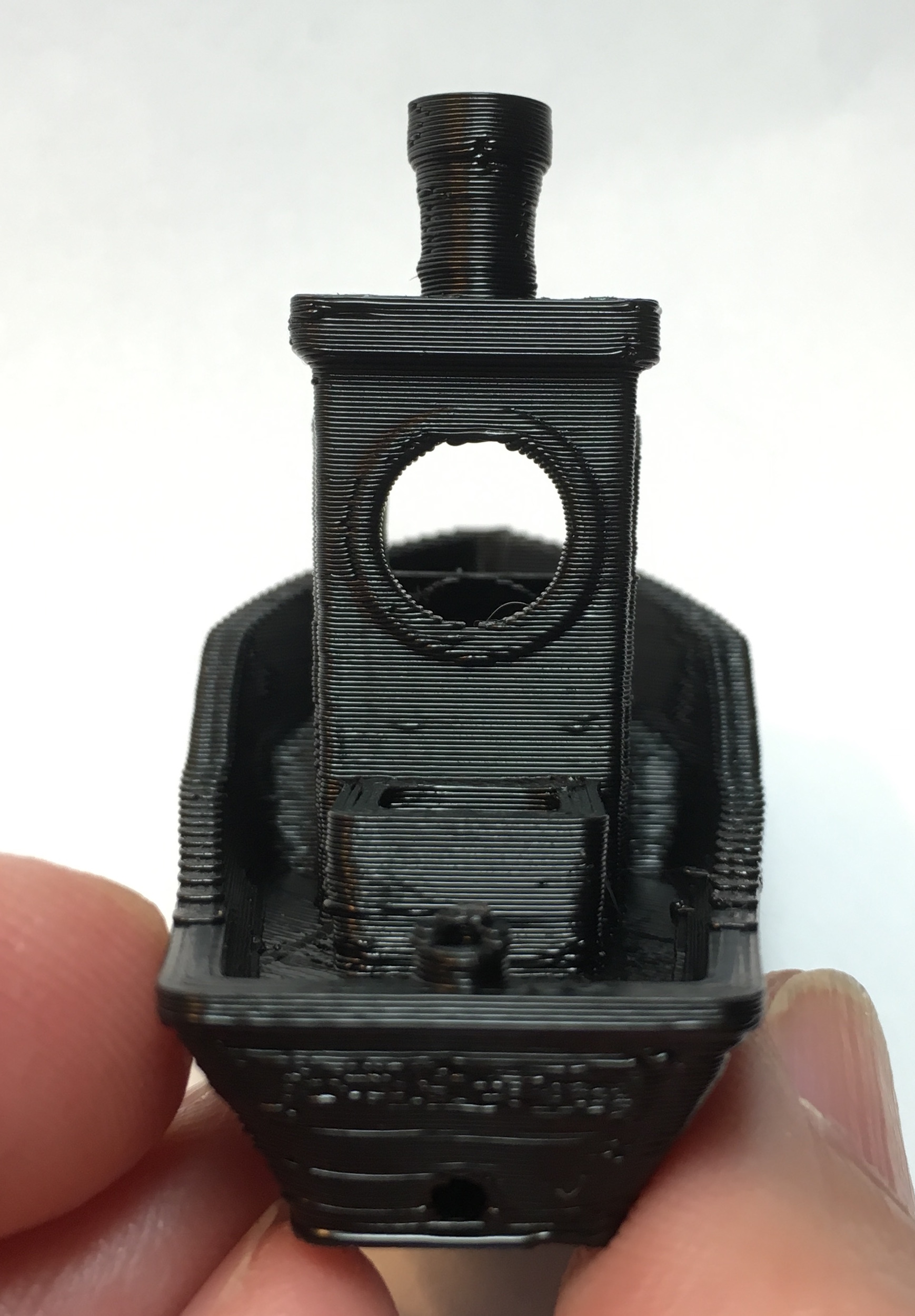

Apparently I need to start wearing my old lady glasses when taking photos – I’m appalled at how many of them are out of focus. :astonished:
Two more that wouldn’t fit in the previous post:

Those 3DBenchy’s are looking better than I was expecting. Was that printer before resetting the esteps? There are still some anomaly to clean up. Did you hear popping noises when it was printing?
Yes, that was before resetting the esteps.

I didn’t hear popping noises, but I started the print before going to bed, so I wasn’t really listening. :wink:
That’s a very nice looking benchy. Those small divot are either moisture popping, or possibly start points of peremiters are set to start with the outer perimeter first, not the inner. You also may be able to turn down the starting layer over extrusion for adhesion a bit to get a better start layer. It’s set to 120% to help new printer users get things to stick to the bed better, but it does cause “elephants foot” on parts for the first layer. It’s not needed if you are getting good part adhesion.
Good looking Benchy. The fact that you can read the bottom indicates that the initial nozzle height is good. Might be a little overextrusion… but should be fixed when you set your esteps or adjust the flow %.

Thanks, guys!
It’s starting to feel like all the stuff I was trying to fix using things I was reading was just making everything worse…which is kind of discouraging… sigh But I’m okay with starting over and learning to do it right. :slight_smile:

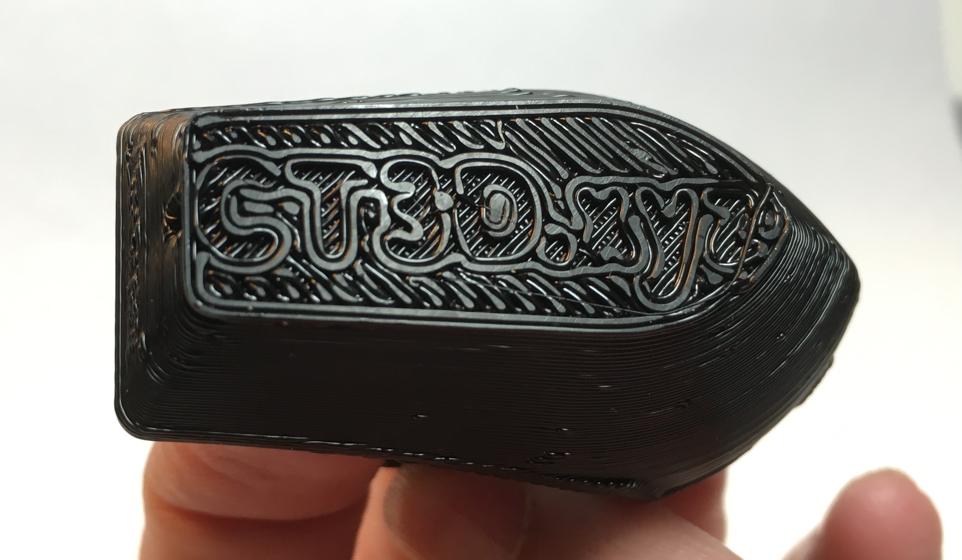

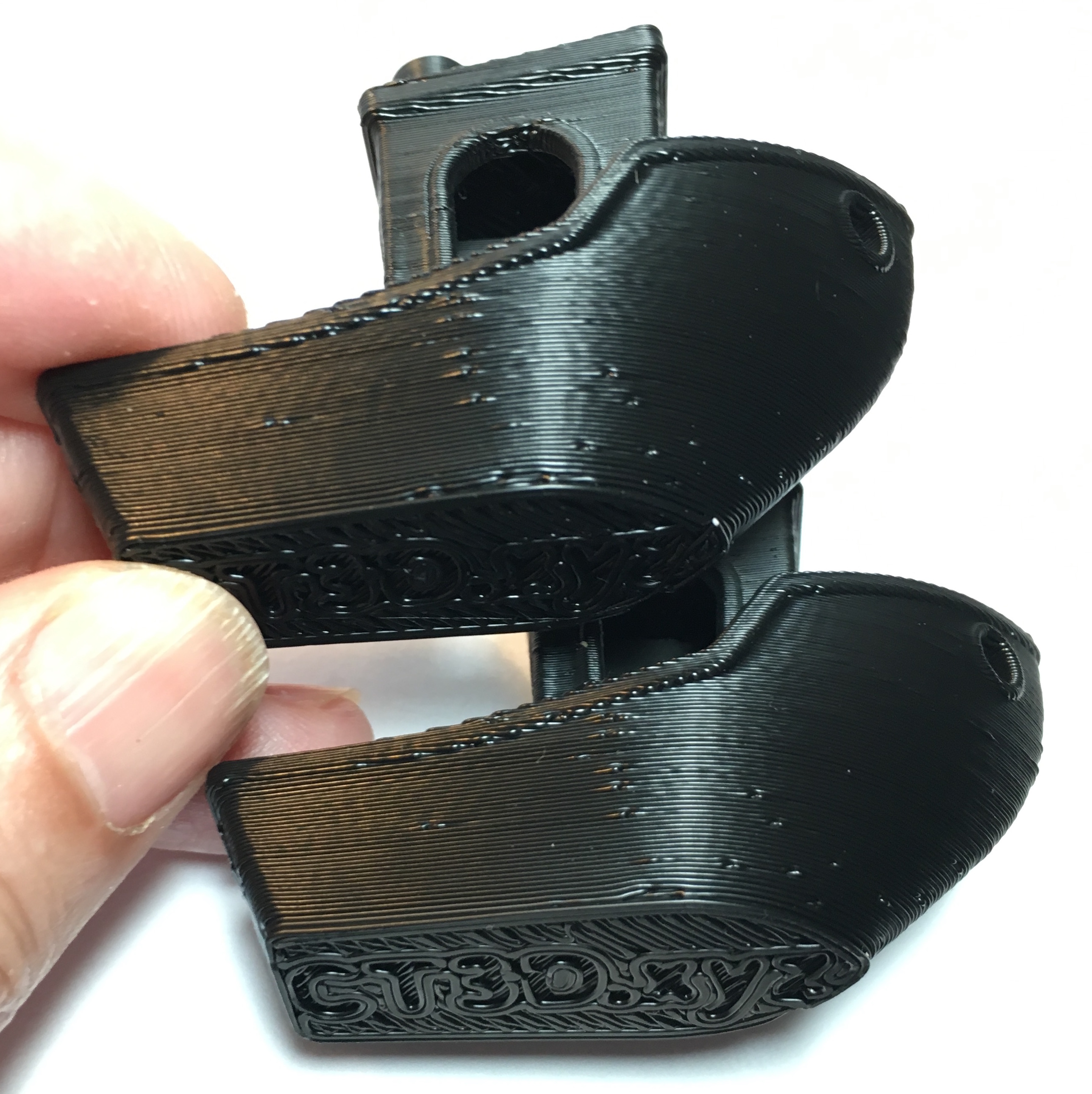

Everything the same as the first one except Esteps set back to factory default: As far as I can tell, pretty nearly identical to the first one.
This is #1 (on top) and #2 together:

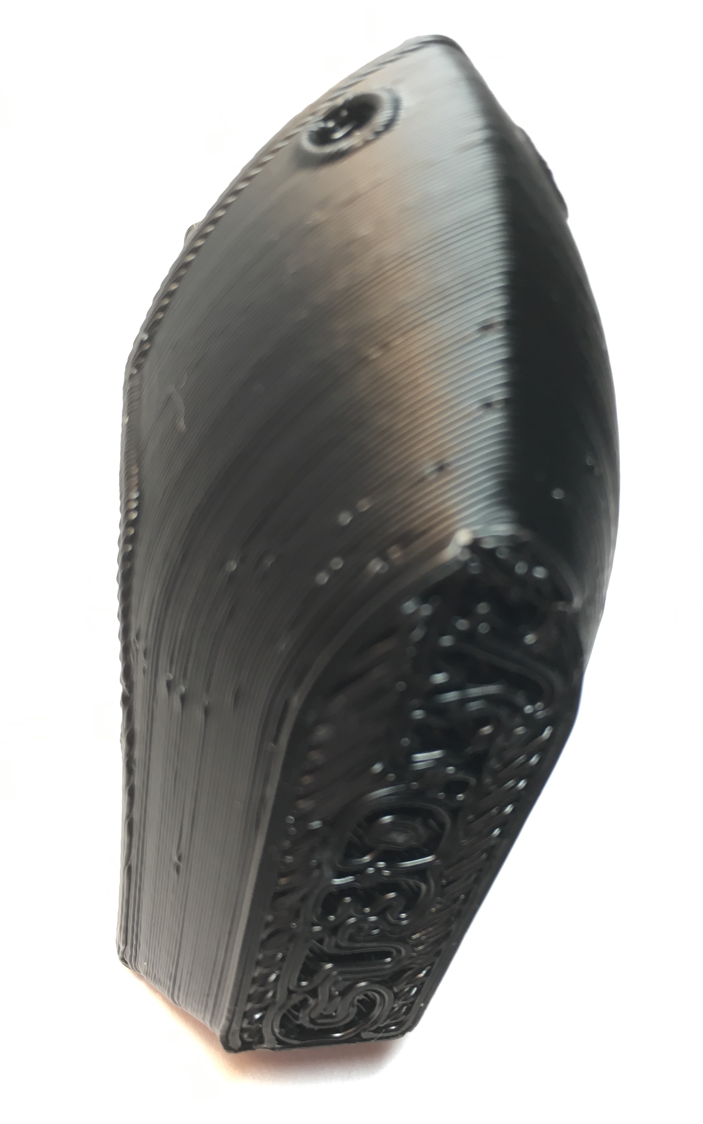

I re-leveled my bed and worked on the nozzle height adjustment.
Top is before; bottom is after bed-leveling using a piece of paper to adjust the nozzle height; middle is after raising Z just a smidge higher, because the paper method left it too low.
As best I can determine using my husband’s non-metric analog calipers (because my digital metric ones died), the first layer thickness is pretty close to where it should be. It’s reading about in the middle between the marks for 0.01 and 0.02". 0.425 mm would be 0.017", so I’m calling it good, at least until I get some new calipers. :wink:
The bottom of the middle one looks good! Nice job with the leveling and z-offset adjustment. I honestly don’t think you’re giving yourself enough credit in all of this. Half of it is just recognizing what doesn’t look right, what typically causes it, and what to do about it. Sometimes the best way to learn that is trial and error.

What does the middle one look like from the side?
Thanks. Part of my problem is the trials and errors are spaced so far apart right now – real life has been frustratingly busy and all-consuming the past few months (I’ve had my printer about 4 months), and I haven’t had the luxury of uninterrupted time to focus on it. And I don’t really know what looks right, and what doesn’t, or when it doesn’t, how it’s not right. The input on my photos here has helped quite a bit with that already.
The middle one looks pretty much the same as the first two Benchys from the side. I didn’t print the whole thing that time, since I was just looking at the Z-height, so it’s only like 1/4" tall.
