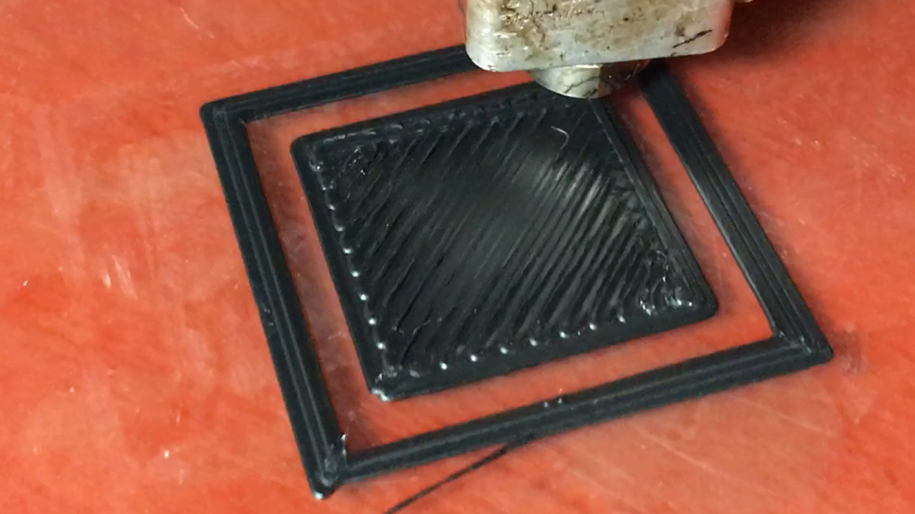

I just went back to the stock Cura profiles and started a print of the 20mm test cube using the high quality profile and default ABS temperature settings on the Taz. It’s already past the first layer, but here’s how it looks so far…

What brand filament are you using, and do you have a set of digital calipers? That skirt looks pretty thick. The top should be a bit flat rather than rounded. Can you measure it? If you are using the Cura stock profile for ABS that should measure .425mm (or thereabouts)
It’s Hatchbox ABS. Yeah, the skirt looks weird to me, too. The only calipers I have at the moment are in inches; it measures about 0.03", so ~0.78 mm.

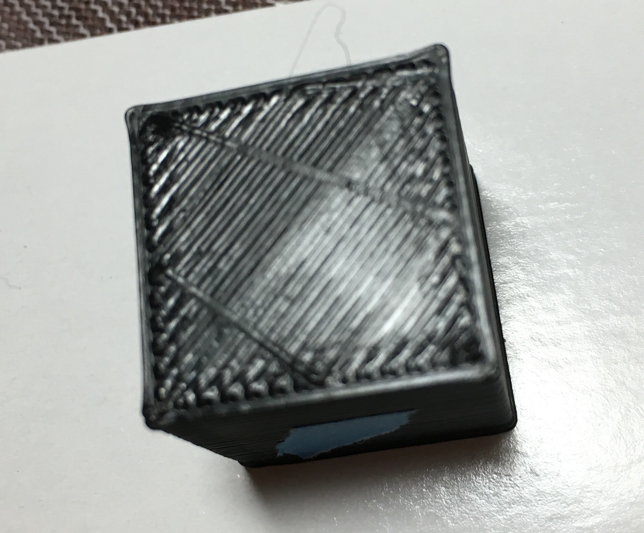

Here are photos of the cube – top, bottom (blurry, darnit), and front, and another of the full skirt.
The cube measures 0.8" X by 0.8" Y by 0.78+" Z. So the height is a little bit under the 20 mm it should be, but X and Y are correct.

Every pic looks like some over extrusion. With Hatchbox (good stuff0 my experience has been that the filament diameter is 3.00mm rather than 2.85mm. If you’re using quickprint, switch to advanced and change the filament diameter to 3.00mm and also make sure the flow rate is also set to 100%. Because of the small skirt you got 3 lines and if over extruding that could explain the almost double height. One thing you can try is let it print one line of the skirt then kill the power. Let the skirt cool then remove it and measure the height (but do it after changing the diameter setting to 3.0mm)
You’ve no doubt read a lot about measuring the filament diameter, which I do every now and then, but to be honest I’ve also found that the manufacturer’s spec for the diameter is usually a good setting and I use that initially. Since Hatchbox lists their filament diameter as 3.0mm (and it effectively is) you need to update the Cura ABS profile which is set to 2.85mm by default. Thus the over extrusion occurs because you’re actually extruding thicker filament than the slicer thought you were using. You’re laying down too much plastic.
The last pic where the bottom is practically smooth could also indicate the nozzle is low, but let’s change one thing at a time and work with the filament diameter first.

Okay, set filament diameter to 3.0 mm and killed the power after a single skirt line. It measured 0.25 mm.

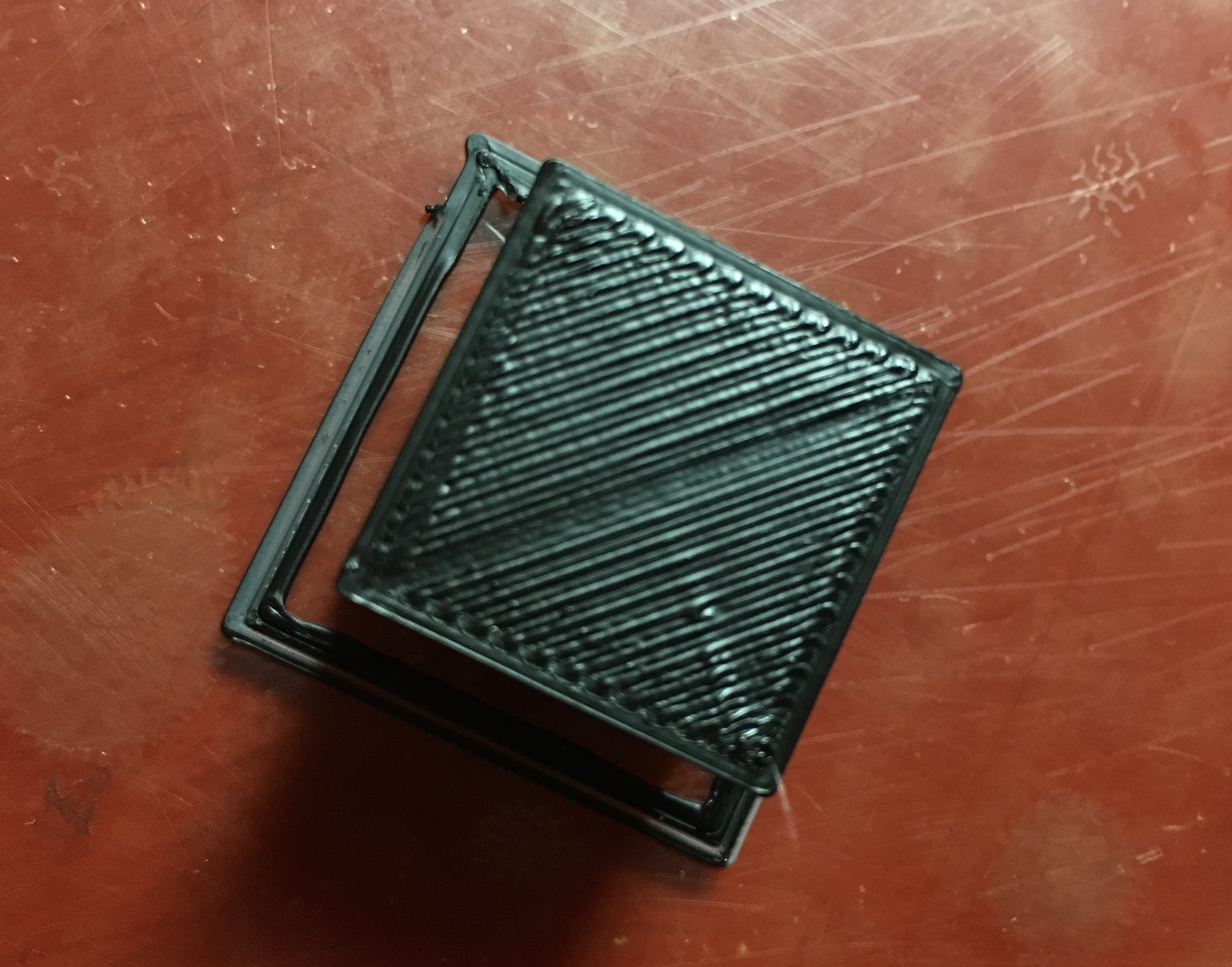

So, I’m thinking the thin skirt line confirms my Z is set too low, right? I went ahead and raised it by a quarter turn (I don’t want to do anything too complex before you decide what’s the next step) and started a cube print using the Cura standard settings except with the filament width set to 3.00 (yep, that’s what the Hatchbox measures). Here’s a poor quality (sigh) photo of the first layer, FWIW.

The “crushed” first few layers is another sign that your nozzle may be too close to the bed. Give the endstop knob a quarter turn. Print half 2mm of the calibration cube then cancel and observe the bottom. It should look similar to your current.

Cura standard settings tweaked for filament diameter of 3 mm
ABS temp settings (240º/110º)
Z axis raised from previous print by 1/4 turn
Skirt thickness ~0.375 mm (note that with analog non-metric calipers I can’t really be terribly accurate with a measurement that small!)
Cube dimensions 20mm x 20mm x 19.75mm (Z)
It’s got less messiness on the side surfaces, but still has little swoopy pagoda corners on it.

If the esteps doesn’t help, try lowering the flow % to 95 in Cura… should reduce the overextrusion.
