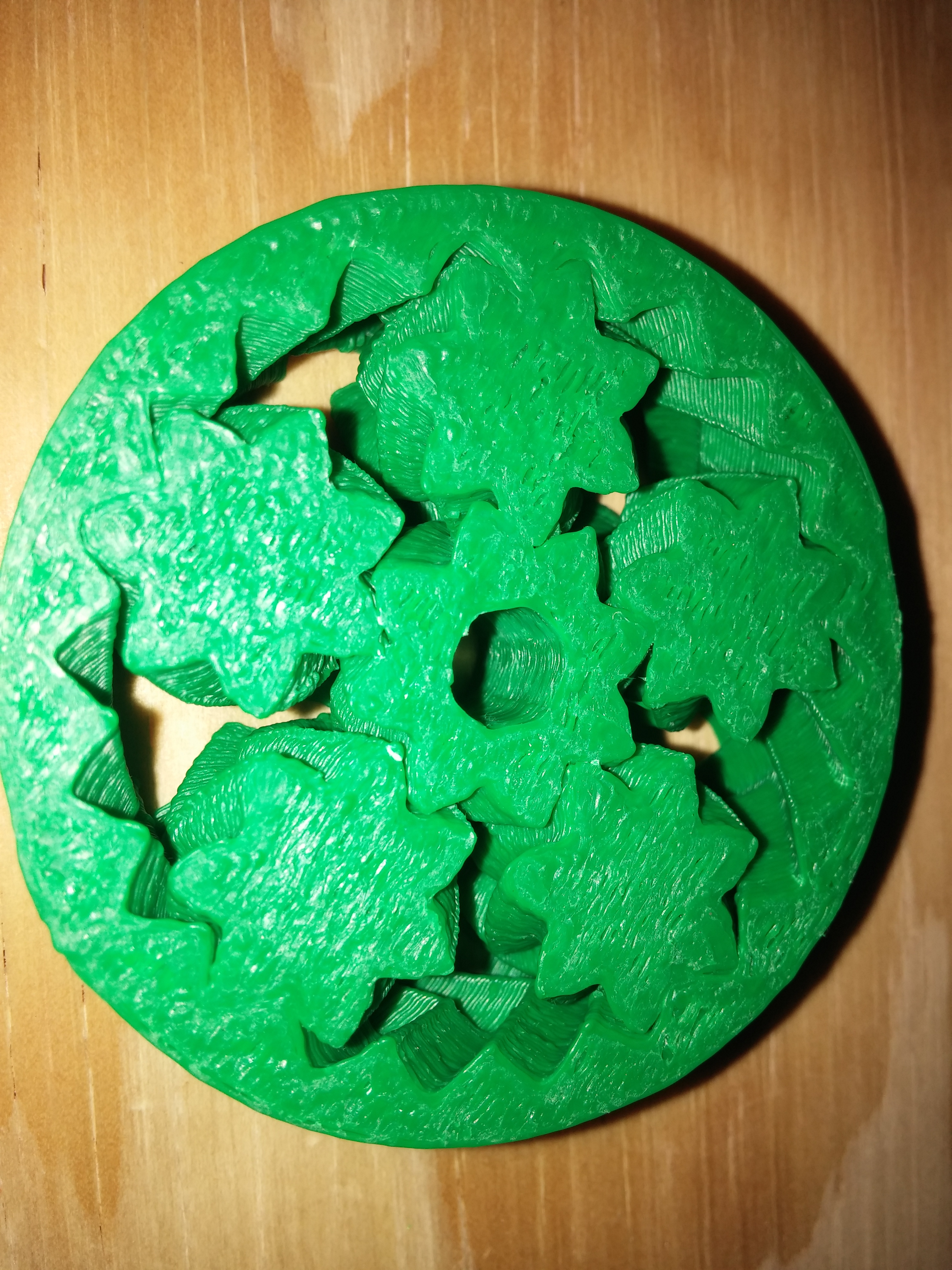

I have been trying to print the gear bearing by emmett. http://www.thingiverse.com/thing:53451.
I haven’t been able to print it without the perimeters of each gear part becoming bonded to the adjacent part. It seems like the edge of the extrusion isn’t being placed in the correct location.
This is on a stock Taz 2 printing with abs. Is this a hardware problem or software? I am at a loss. The printer generally builds parts to the correct dimensions with the exception of hole inner diameters, but holes seem to be a common issue.
Has anyone had this problem with a Taz?
Here is a picture:

I had a heck of a time trying to print that with my TAZ 3, and in the end I had to make a custom one with a bigger gap than the stock model. The literal sticking point seems to be the middle meet point of several of the gears. I think it’s partially a Slic3r issue, and partially maybe some additional filliament calibration needed on my end. I did finally get a working one though as my first Taz 3 part
It has been a real pain. Mine actually fuse at all the gear interfaces. I have tried it with the medium and fine Slic3r setups as well as Cura. It seems like there is physical limitation with the Taz.
There’s a couple of Slic3r settings that need to be changed:
; perimeters = 2 Change this value to 1.
; first layer extrusion width = 0.35mm A smaller first layer extrusion width will help prevent the edges from touching and sticking together
; layer_height = 0.22 A higher layer height will be easier to print. Once you have things printing well, you’ll be able to turn this down and can manually adjust your extrusion widths under Slic3r > Print Settings > Advanced
You’ll also want to have a higher Z axis homing height- Very similar to the last 2 images in this picture:
judging soley from the picture, it looks like you’re over extruding a very tiny bit. You can turn that down, by adjusting your extrusion multiplier slightly, say to 0.98.

I tried the changes you suggested in slic3r. It was still smashing the parts together. I was running out of time so I gave your gcode a shot.
Here is the part build with the posted fast bearing gcode.
It looks better but is still stuck. :slight_smile:

I did increase the z home gap by .oo2 inches before this print. It is now at .005.
I know this part can be printed because I’ve done it before. I think the ideal clearance is somewhere in the .3mm range.

I will give that a try as well. I wasn’t able to measure the clearance on the Thingiverse file so, maybe it is just too tight.
Here is the bottom of that part.
Raise the Z axis endstop adjustment to start with a higher first layer, a good full turn should probably do it. That should help keep the first layer from blending together, as long as it’s still able to stick to the bed well.
