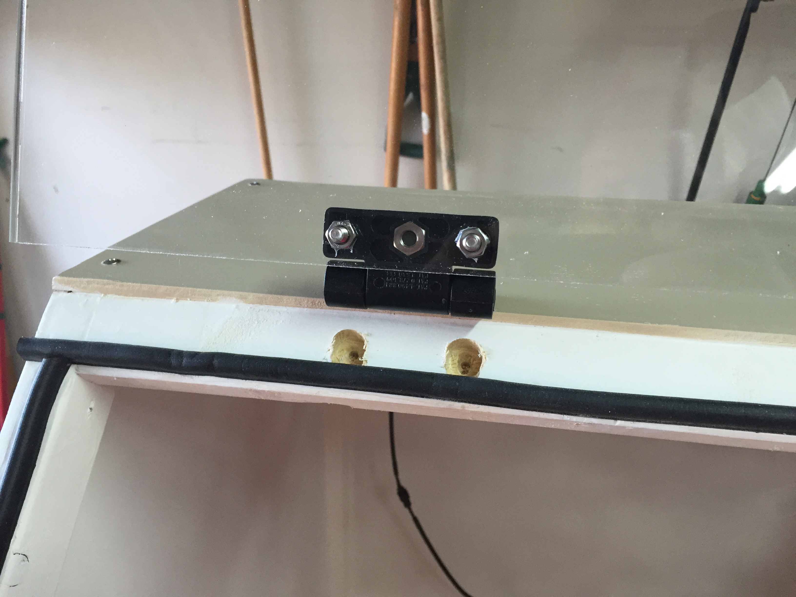

We just got a TAZ 5 two weeks ago and ran some ABS which we had some warping issues with and I looked through you hotbox design. I’m really impressed with the amount of work that went into your designs and documentation. I wanted to offer the one thought I had, if I were to build a similar box, which you may have already considered; is using a piano hinge rather than the bent plexiglass. It won’t be a totally clear cover which is cool looking but it will reduce the overall height and cost of the build.

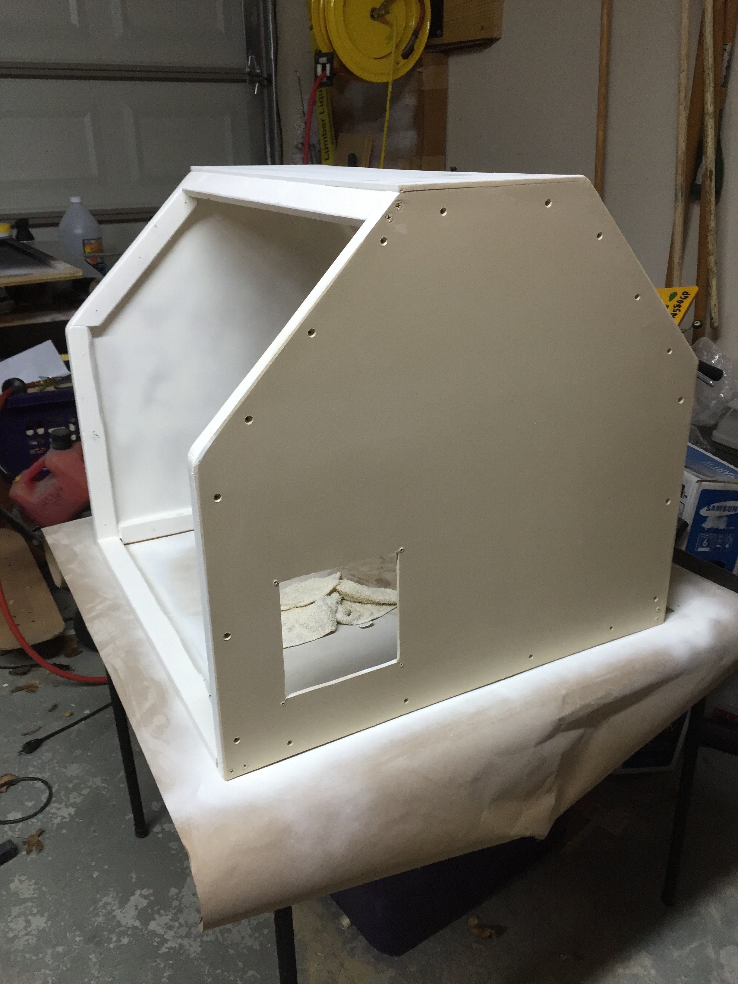

Thanks for the reply Jonathan. I had already built the box by the time i got your message. But it’s all good. Here she is in all her glory. Kind of large for my office but I love it. Thank you so very much for all the effort you put into the design.
I haven’t finished putting the panel in the plexi but i’ll do that in the next few couple of weeks. I also included a pic of the first big item i printed. It was a 12 hour ABS print and it was PERFECT. Perfectly stuck to the floor, perfect layers bottom to top. I could never have done that before.
The rest of the pics…

This post has gotten very long, is there anything I need to watch out for before I start the build. I printed out the directions a while ago, someone talked about using 1x3 for supports, a problem with the screws and latches, drilling holes in the plexaglass and cracking it, bending vs using a piano hinge, any other things I should consider before I start my build.

@BigKahuna That’s a great idea. In fact i’ve thought about that too but never thought about trying to isolate both. But this adds to another idea I had that I’d like to add to the overall design of the box… And that is a panel that can be removed to allow full access to the plate over the controller. Yes, it’s possible to remove the top of the box but for me it would be infinitely easier if i just had a door on the side that I could remove for temporary access. So i’m going to design a side panel door with both in and out for air. Will post something after i get it rolling. I think i’ll just print the whole thing. If i can get what’s in my mind out in CAD, this thing should look pretty cool too.
@choban Just drill slow on the holes. Start with smaller bits and graduate up till the hole is the right size. Practice on a scrap piece of plexi if you have some left over. regarding screws for the main outside of the box, I used a counter-sink drill bit combo and was careful to get them all the same which led to a really nice finish look. I bought stainless oval head screws with a tapered base so they could be counter sunk. Made a nice looking finish. If you decide to paint it, i might suggest KILZ in a spray can for the primer on the wood. I actually tried a couple of lower priced spray primers but i kept having to put more coats on because it didn’t seal the mdf that well. KILZ is great at that and the spray can is in a different league than the other brands. Good Luck!
