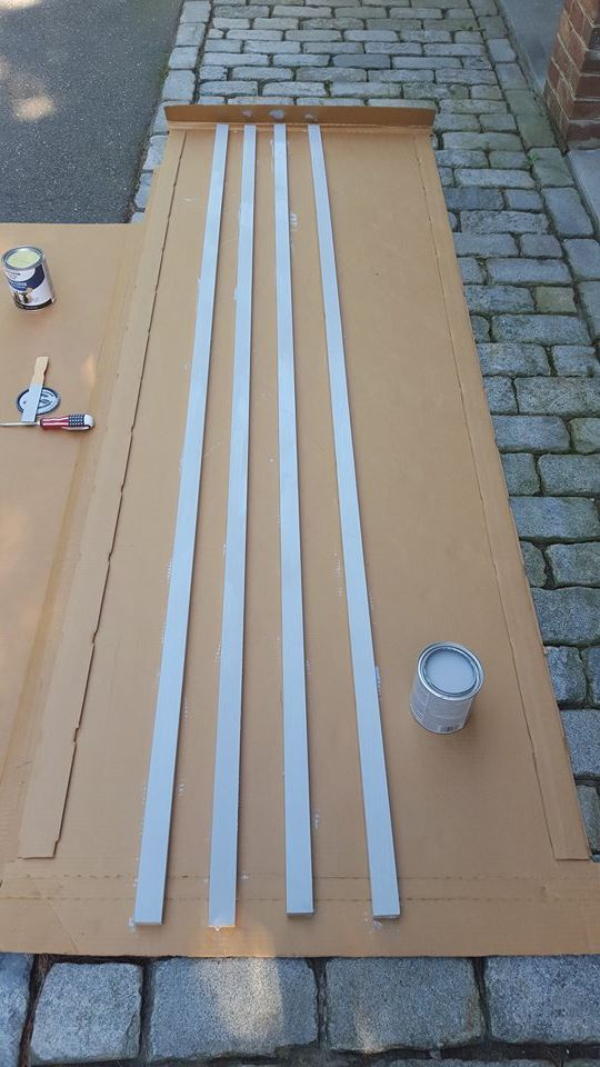

So I head back to Boston for work and school on Wednesday trying to get this thing together before I leave. The laser cut panels should get here Monday. In order to match the black panels I primed and painted my pine with Rustoleum latex paint. I am going to cut all the pieces with a miter when I have the panels to ensure a perfect fit and then I can touch up any areas if needed.

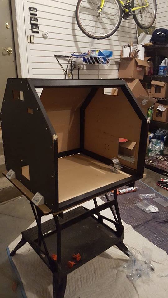

So the panels arrived today and I tried to do as much as I could. I need to get this bad boy as close to finished as possible by tomorrow night before I have to move. I must say, having everything laser cut was the way to go. I have no clue how anyone can make these holes by hand, I wouldn’t have the patience. I used Phenoseal between the panels and pine framing, this way I have an adhesive as well as a sealant. I didn’t have a table saw to cut the 45 degree angled pieces but I am hoping to borrow one tomorrow. I was looking over what I have left to do and saw the wiring for the fans are a bit off, you can watch the video below for more information about that. Let me know if anyone has any questions.

WOW OH WOW. I am impressed at how well the acrylic worked out. I ended up just using a heat gun and heated the acrylic for about 8 minutes and bent it around the sound. Pretty happy on how it turned out. Well, I’m off to Boston hopefully I can do some more work on it there.
WoW indeed, how cool does that black look…making the Hotbox 1.0 look like a piece of crap (as in, my original natural wood version) lol… you guys with the paint, really onto something…Nice work Nick, very nice. Just imagine putting blue tinted LED’s in there, would be insane. Maybe throw in a strobe light :wink:
