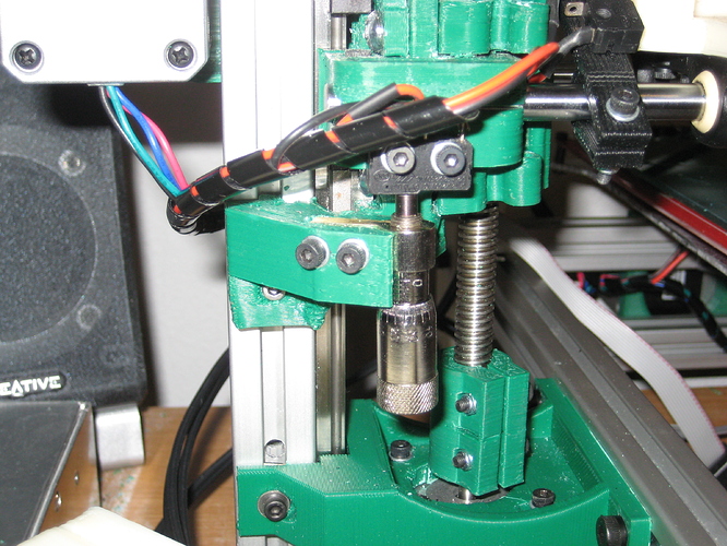

The micrometer based Z axis. I’m actually kind of surprised I haven’t seen one like this aside from the entirely made of extruded plastic ones on thingiverse so far. Maybe there’s a reason. if so, I’ll find out!

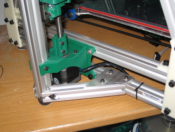

I also replaced the Angle brackets. I’ll polish them up nicely later. You can also see my top secret project “lulzbot AO-10x feet made out of washers and rubber cap things and screws and some t-slot nuts that may or may not work” in there. Probably need an acronym for that project heh.

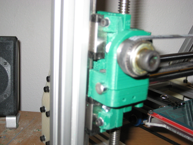

Well, Here’s half the final assembly anyways. My plan is to run a few prints through it in hybrid mode and see how it looks before I add the X motor side this weekend. So far the whole thing fits like a glove. I had to add longer screws to anchor the upper spar mount plates to the top gantry side plates, but aside from that I couldn’t have asked for a better fit. Also top secret project Mendelfeet was also a success apparently. I’ve been running the Z axis up and down the gantry for the last few minutes, and it moves smoooooth!!!
The entire frame is much more solid than the admittedly already really solidness it had before. Once I get the other side on, I’m pretty sure I could park a car on top of this thing and it wouldn’t notice. The angle brackets and extrusions on the bottom really are overkill. But that back spar and rail is never going to accidentally move even slightly, so I’m ok with it. This modification also gives the frame enough stiffness that you could probably use it for a light duty cnc wood router with decent results.

One thing odd I noticed. By putting my printer on the little rubber feet I made for it, it has literally cut the noise it makes in half. I thought I was going deaf at first. but apperently that solid frame was using the top of my print table like a resonating chamber and amplifying all the noise. It’s almost too quiet now.
Ya, we tried a huge variety of feet to quiet it. It makes a huge difference.

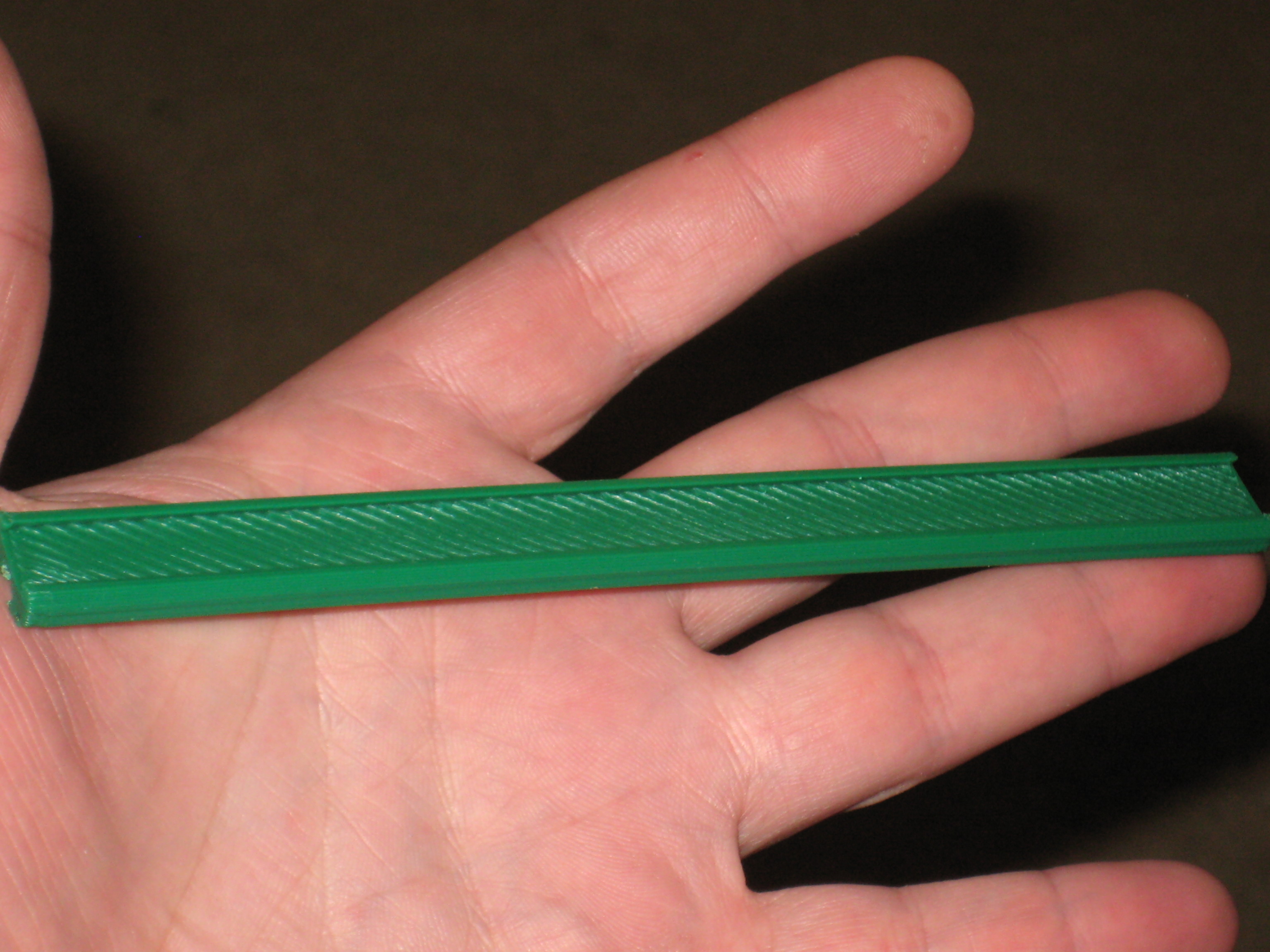

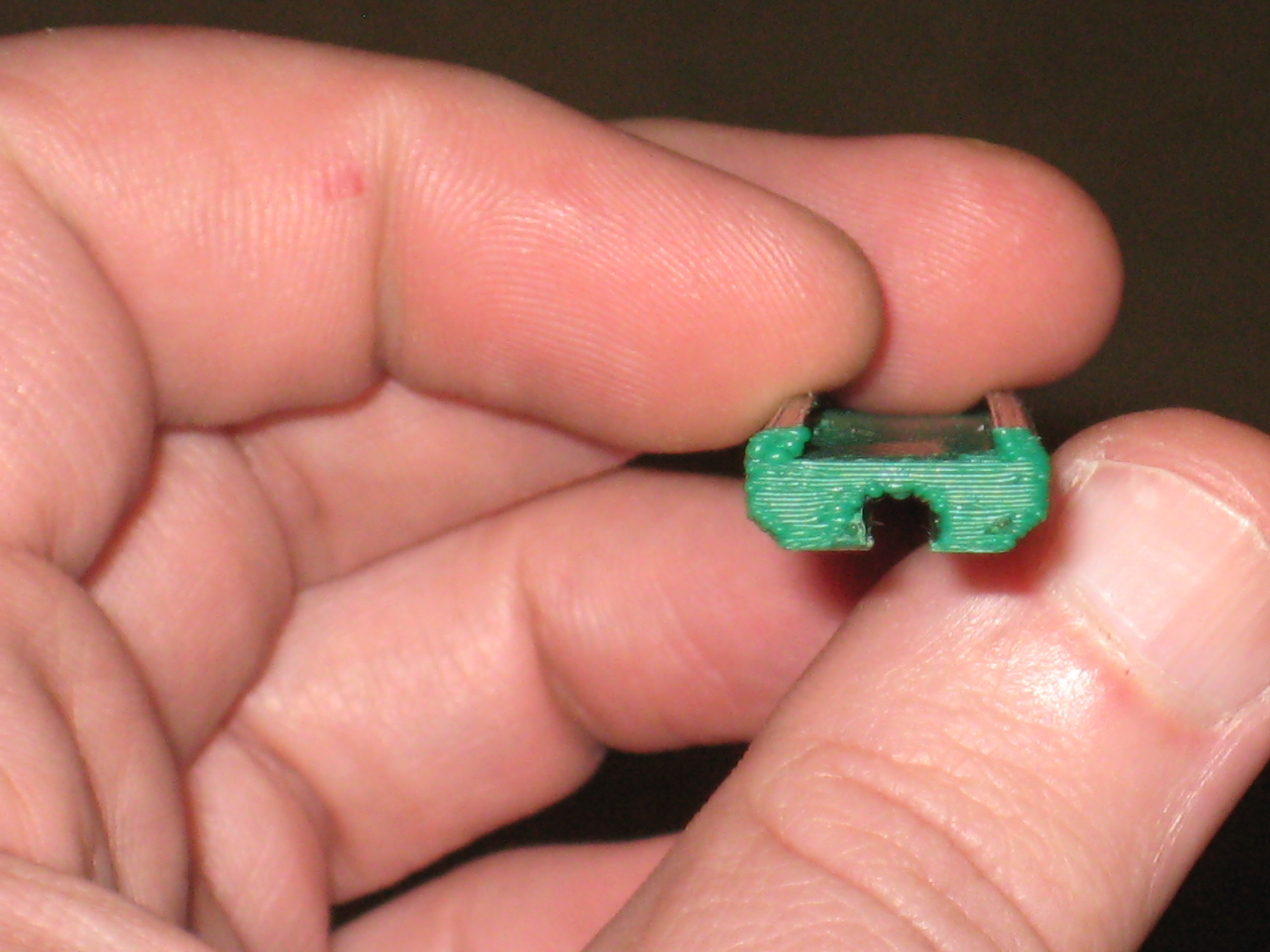

First prints with both ends on show promise. I do have a little tuning left to do on the idler side. Nothing too exciting, just some simple flat LED holders, but I think it’s pretty good quality for a .5 nozzle in a fairly small part I’ll be printing some more stuff with flatter walls later in the week which will tell me if it was a big improvement there.
Nothing particularly entertaining there but it does show how it is printing
Edit: By the way, the micrometer based height adjuster? Best idea in the history of ever! I get really really fine layer adjustment, and the damned thing stays exactly where I set it!!! the other one would tend to drift slightly over time. I’ll make a rod based version of that so people can experience the awesomeness at some point in here.

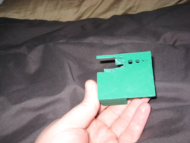

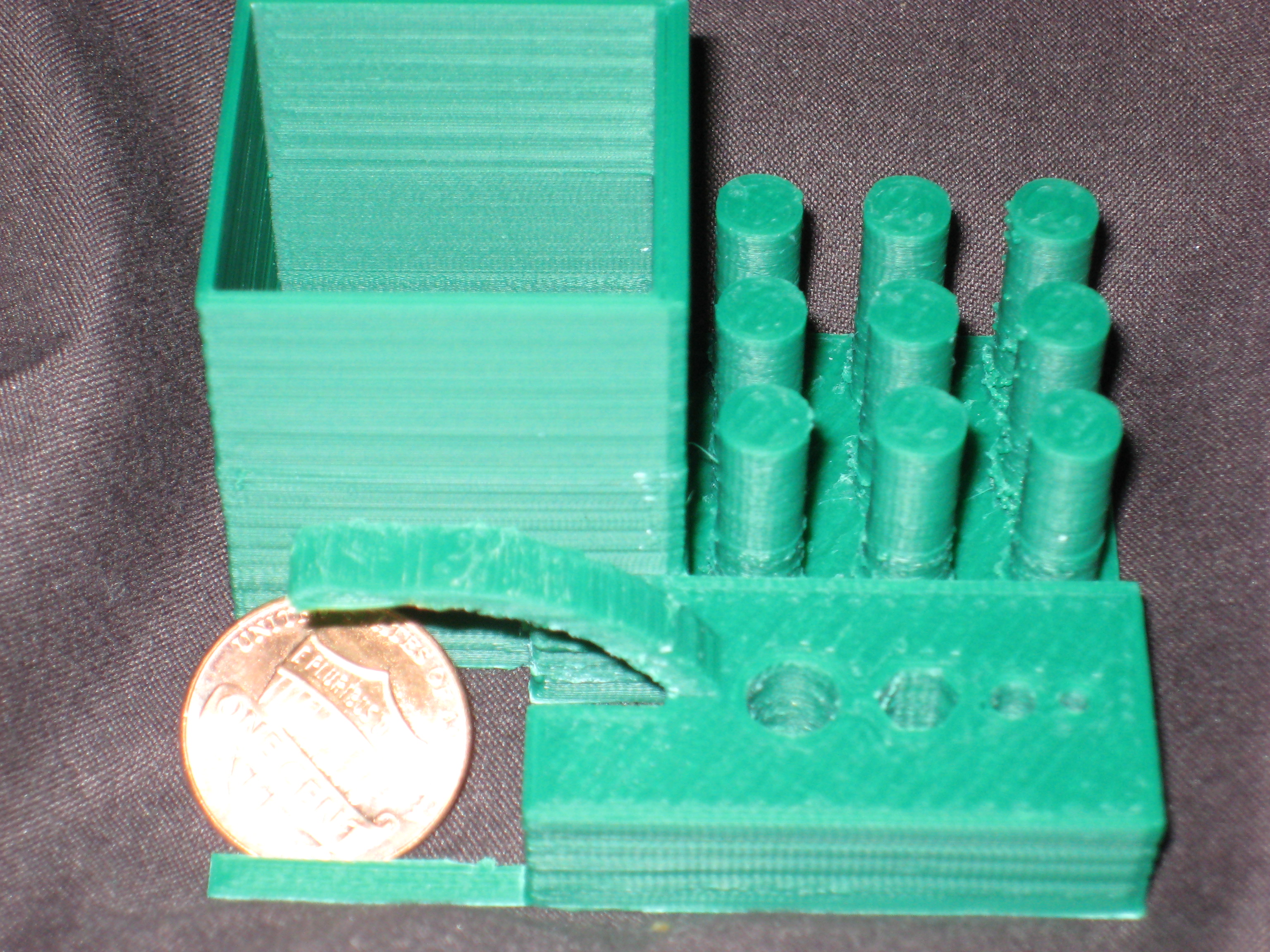

Here’s my first serious attempt at printing something very high quality with this modification. As you can see, there is room for some additional tuning, but it’s not bad for an old AO-100. I do apparently have a slightly bent threaded rod which isn’t helping, but I think the rest of the banding is actually in the carriage and the 8mm carriage rails rather than in the Z movement. I’ll work on them next. The green actually makes the banding look worse than it is though too.
Edit: for clarification this was printed at 0.10 mm layer height. at normal heights the banding is now invisible.

Those parts are looking really good! The corners on that box look really sharp and those cylinders tooI am amazed how fast I are pumping out these upgrades! Thank younger the pictures.
Do u know what cause those little bubbles at the ends on the prints? (Gantry photos)
Thanks! I’ve got a few more upgrades in progress that haven’t been officially called projects yet aside from the still in progress deckplate modifications (a new quickfit stabilized X carriage based of BAM’s, A fully supported 300mm ballscrew for the Linear rail Z, A Linear slide (or maybe Rail) Horizontal X axis modification different than the Mendalmax 2.0 setup, and possibly fiberglass sideplates for the gantry to get more of a finished “office product” type look for the printer. amongst others). Should be enough to keep people entertained for a few months anyways. at which point maybe i’ll have a printer upgrade kit for sale or something along those lines?
The Bubbles are the result of a few things. Humidity and moisture content of the filliament is a big cause, along with overextrusion. FOr the moisture issue, filliament if you look at it under a microscope is basically a very tiny sponge. Holes in the plastic from the extrusion process to make the filliament in the first place collect tiny amounts of water, that turn into steam when they hit the hot end, which causes extra plastic to extrude
Extruder calibration is the other big culprit. Especially printing at micro layers. Basically if your filliament isn’t exactly measured, and your extruder isn’t dialed in to the point where extruding 10mm of filliament will result in exactly 10mm of filliament travel, you can get bumps in the corners or on circles.
The other source of the bumps is a slicer bug that is fixed in version 1.0x, Basically filliament extrusion is like pavement on a road. There is less filliament needed on the inside portion of a round hole, just like there is less pavement needed on the inside lane of an oval race track. THe older version of slicer didn’t take that into account as well as it could have, which is now fixed in the latest version.
Beyond that, temperature and humidity issues can also account for unexpected bubbles. Short of an isolated climate controlled dehumidified environment, they are difficult to remove entirely in my experiance so far. Storing unused spools of filliament with dehumidification sillicon packets seems to help somewhat unless you live in an area that is pretty much 100% saturated year round like Ridgefield.

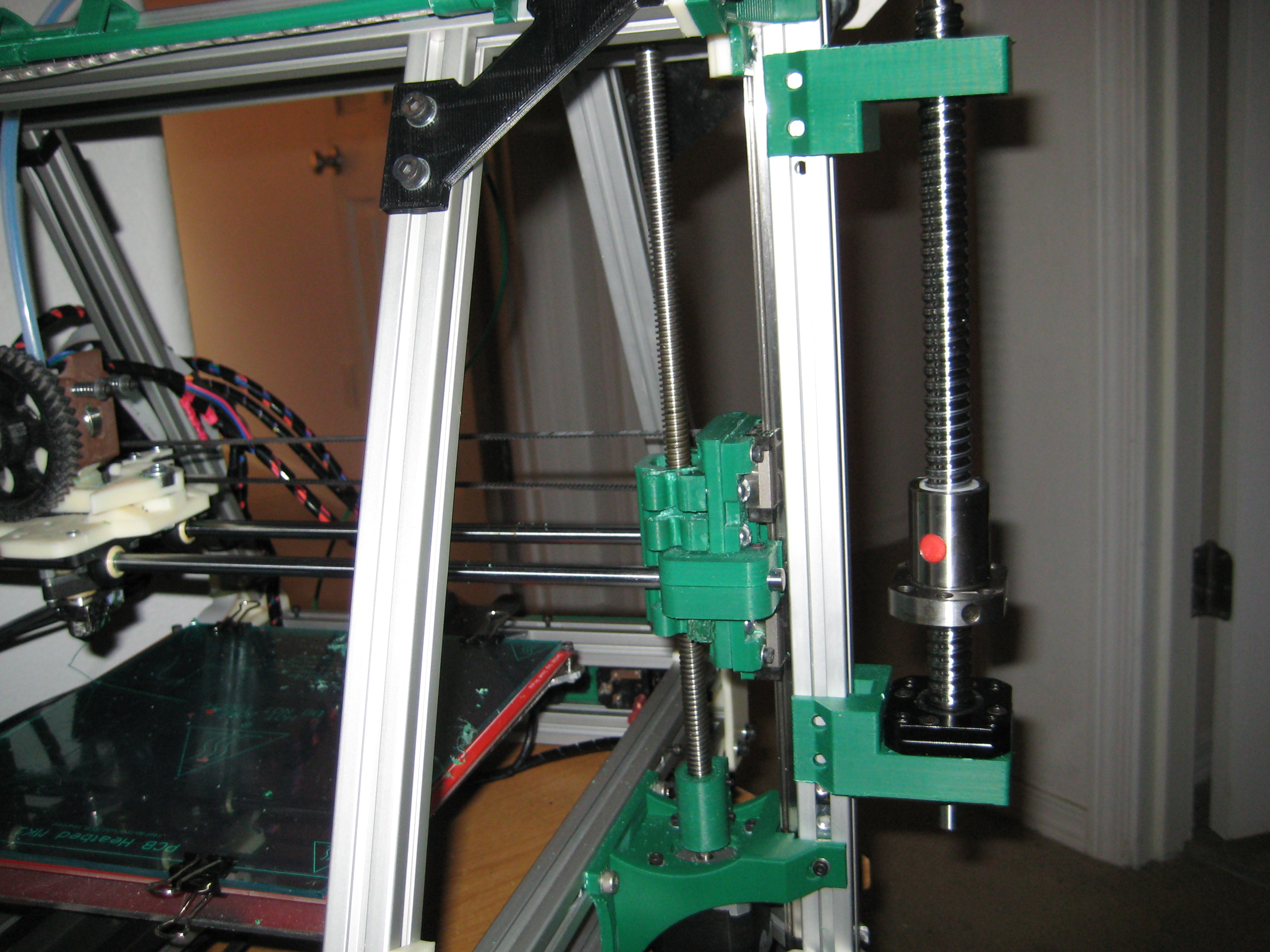

A preview of Phase II, while I wait for more parts to arrive
Here’s a bit better hint:
The top bracket isn’t anywhere near the final design, and the whole assembly will replace the existing acme rod on the inside. The TAZ style spring will be replaced with a fixed adaptor, hopefully reusing the existing clamp ends for now. I would have preferred that the mounting flange was on the other side, but repacking the balls in one of those is amongst the most annoying chores ever invented, so i’ll probably work around it. Not bad for a $30 ballscrew though so far. Still need a top support bearing, as well as a design for the nut retainer. I’ll also end up rebuilding or at least relocating the z height adjustment screw assembly since it will be in the way of the lower bearing bracket. No idea where that will go yet though. This one is going to take a bit to get right. and then there is the whole leadscrew e-steps issue. I will say this, the new one moves a hell of a lot smoother than the existing one for certain.
