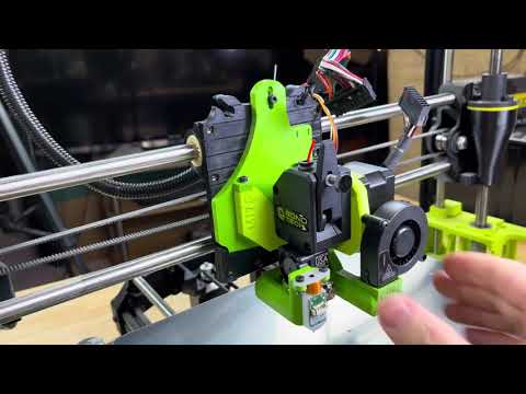

Okay, some updates!
New piece printed in ABS
I feel like the big issue i had was I was at the very top of the opening up top for the screw to go in. Extending that top area 5mm seems to have helped a good deal.
Video Summary
Files
STL -
PP-GP0355_v2-1_Aerodaptor_Taz_Mount_ABS-BLK UPDATED.STL (70.0 KB)
SolidWorks

No comments on my video? Ha you guys!!
