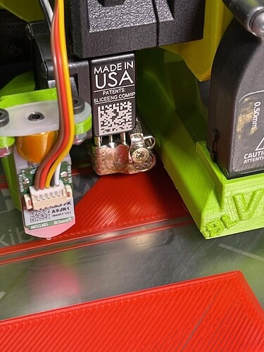

So I still have some unusual gaps and I noticed as I was doing I test cube, I was hearing a lot of rattling. I knew it wasn’t the tool head connection, I resolved that.
I did notice an 8mm screw under the printer. Hmmm.
So I tipped the printer on its back and noticed that the bearing holder was in place with 2 screws! The rest had fallen out. Inspecting the bearing holders was even worse. One was held in place with one screw! The rest were all very loose.
I installed new 8mm screws, based on the OHAI assembly guide and tightened the rest.
Note to self…do this again, but with some blue Loctite!
THAT was the source of all the gaps in my bead! Now that it is all tightened up, I am able to dial in the Probe Z Offset to -1.120 and get a very smooth, flat layer.
In the foreground is the gappy mess I was getting before.
The lesson here is this - if you get a free or second hand printer, it might not be a bad idea to check for missing or loose screws!
