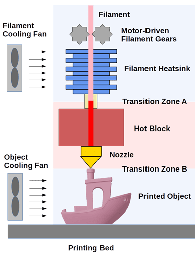

So here’s my problem. I’m printing carbon reinforced nylon which I know is notoriously tricky. For about three hours it works great but then almost like clockwork it cant feed the filament. I say can’t because it is trying to feed but the filament doesn’t move and I have to push it through by hand to get it going again but by then the print is ruined. At first I thought the nozzle was clogged but I don’t get a big blob when I feed it through manually so I’m not sure thats it. What I don’t get is why I never have this problem sooner in the print. Everything on the printer is stock except the nozzle which is the same size but coated so I can print the cf reinforced nylon. I’ve tried changing a few settings but so far it’s still happening every time I print this or any model longer than about three hours.
This sounds like a classic case of heat creep. Using the attached diagram as a reference, the “Filament Cooling Fan” is supposed to keep the heat from the “Hot Block” from reaching the “Filament Heatsink”. If it doesn’t do this, the result is called “heat creep” and often results in a clog as the filament is partially melted in the “Filament Heatsink”.
One solution is to lower the temperature of the “Hot Block”. Since it appears to take 3 hours for the problem to occur, a slightly lower temperature could allow the “Filament Cooling Fan” to keep up.
A second solution is to increase the efficiency of the “Filament Cooling Fan”. Usually this is done by increasing the CFM rating of the fan but other solutions like providing a cooler source of air can be used. Make sure the path of the cooling air isn’t blocked. Make sure the fan is still spinning at full speed (i.e. its not worn out).
