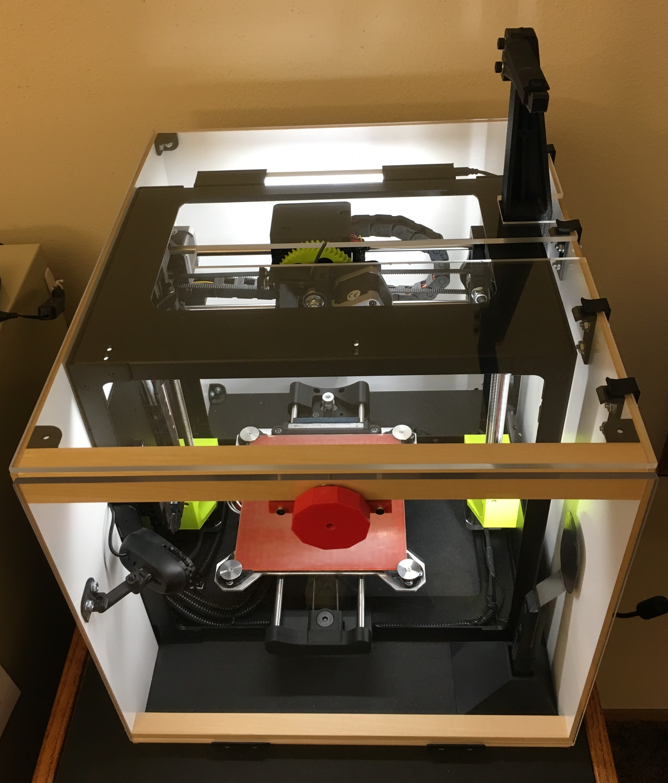

I solved that by just putting the electronics outside the enclosure (photo below). The left side is flush to the frame, with a “cutout” that goes over the electronics box. That way both the inlet and outlet of the electronics box are outside the enclosure, and no ducting is needed.
That’s a great-looking enclosure, Scott. Is it your design? I’ve been looking at some pictures of Mini enclosures. A couple of them I’ve seen have way too small a door - I can’t imagine trying to remove a print that is really stuck on through them. Yours looks plenty big. I am debating about door hinges on the bottom vs hinges on the right side or perhaps using lift-off hinges (mainly due to where it sits in the classroom, but also so kids with shorter arms aren’t leaning up against the open door when they remove prints).

I will try to take some more pics… The enclosure is my design, but not a work of art. Mostly just hacked together from materials I had on hand, and a couple quickly-designed pieces.
I decided against hinges. Instead, I designed/printed a couple z-brackets that screwed into the bottom-front support bar (maple). The bottom edge of the 1/4" plexiglass front just drops into those. I designed that big red “knob” near the top of the plexiglass to rotate, and it has a rare-earth magnet near the edge – which, when rotated correctly, aligns with a rare-earth magnet in the top-front support bar (also maple). So a quick rotation of the knob (un-aligning the magnets), and the entire front just lifts off and can be set aside.
The sides and back are 1/4" hardboard, with white melamine on one side. I faced the melamine side inward, to help with light distribution. The sides and back are held together with some brackets I found on thingiverse. I also attached a C270 webcam (for Octoprint) to the left side of the enclosure, near the front, using an articulated C270 mount arm from thingiverse.
Like the front, the top is plexiglass. It has a slot for the filament, and a cutout to accommodate the spool arm. It is held only at the right side by some “clips” I designed (in retrospect, only the external clips are needed). The top simply slides into those clips, which provide some friction hold but otherwise the top just stays in place via gravity.
Aside from keeping the electronics cool while retaining heat around the print, my main priority was quick/easy access to the printer. Slide the top out of the clips, remove the front from the Z-brackets, and the entire enclosure lifts right off the printer. It’s literally 30 seconds to completely remove, or completely reinstall.

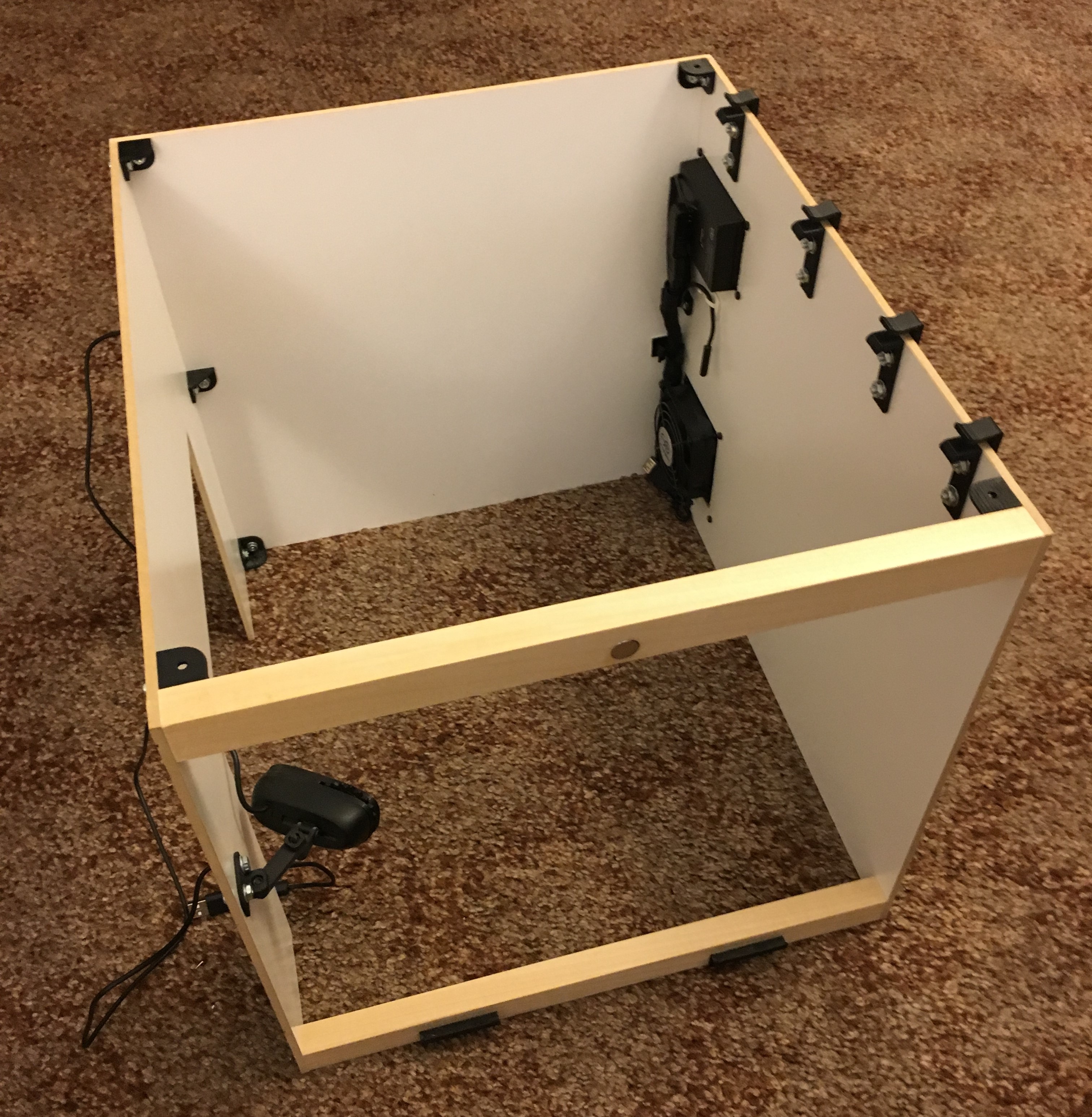

Even with the oversized “filament slot” in the top, it easily gets up to 40C from the retained bed/extruder heat. In fact, I was concerned about it getting too warm for the steppers in summer months, so I added this Infinity Airplate temperature controlled fan to the enclosure.

That’s a very nice looking enclosure, ScottW!
The temperature controlled fan is a nice addition too!
Are there two fans there, or is one of the black squares just a grille?
I’ve always been curious about putting a fan in an enclosure. Do the air currents cause problems with some filaments/prints?
