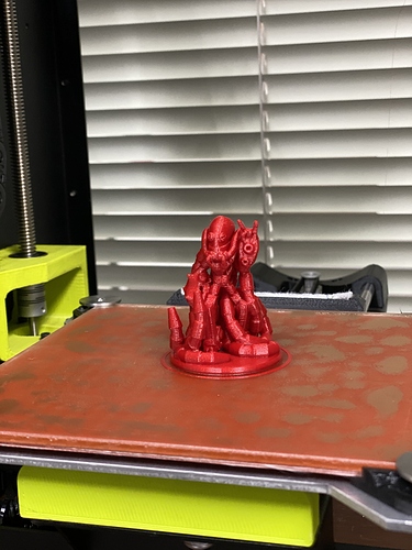

Anyway, the extruded warms up just fine. I load filament and extrude a few MM to get it going. Then load up a rocktopus and begin to print. Almost right away I get a thermal run away error. I reset and try again. Same thing, so I figured it was the bed this time since the extruded worked great, and everything else moves and homes correctly. Time to take it apart again.
This time I decided to rip out the entire bed heater harness and started doing continuity tests. There it was, one of the bed heating wires was bad and the bed was not heating. At this point I noticed the harness was different than the 4 as well. The cable drag chain was wider than the 3 and the wires were pretty bunched up which was part of the reason for the wire failing. It was also 14ga and very stiff wire. After looking over the wire harness documentation and BOM of the 4 I saw they switched from 14ga to 16ga wire. I got the wider cable drag chain from McMaster and some super flexible silicone wire from Amazon.
While I’m waiting for parts I notice the bed that came with it needed a new PEI sheet. Since I had upgraded to the modular bed on my 4 I pulled the original bed out and installed that. One of the things I do not like about the 3 is the bed mounting plate compared to the 4. The bed corners make it more difficult to center the bed and the spacers for the leveling disks are dinky in comparison. I’m working on sourcing an updated bed from Lulzbot if possible. In the mean time I printed some new bed corners with Cheetah TPU in hopes it will help centering.
Time for surgery. It was pretty straight forward, I transferred everything over to the new drag chain and made sure everything worked. So now it was time to try to the roctopus again.
Before the roctopus, I found the burn in gcode and ran that just to see if everything was working correctly. Fun fact, that gcode doesn’t warm up the bed, so I still didn’t know if it fixed the problem. I did notice that the 3 is a lot louder than the 4. I think it’s mostly because of the Z axis motors not being Moons and lacking a dampener. I think that’s next. So now I loaded the code for the roctopus and and it went off without a hitch. I printed for speed and not detail because I just wanted to make sure it all worked. Success!
