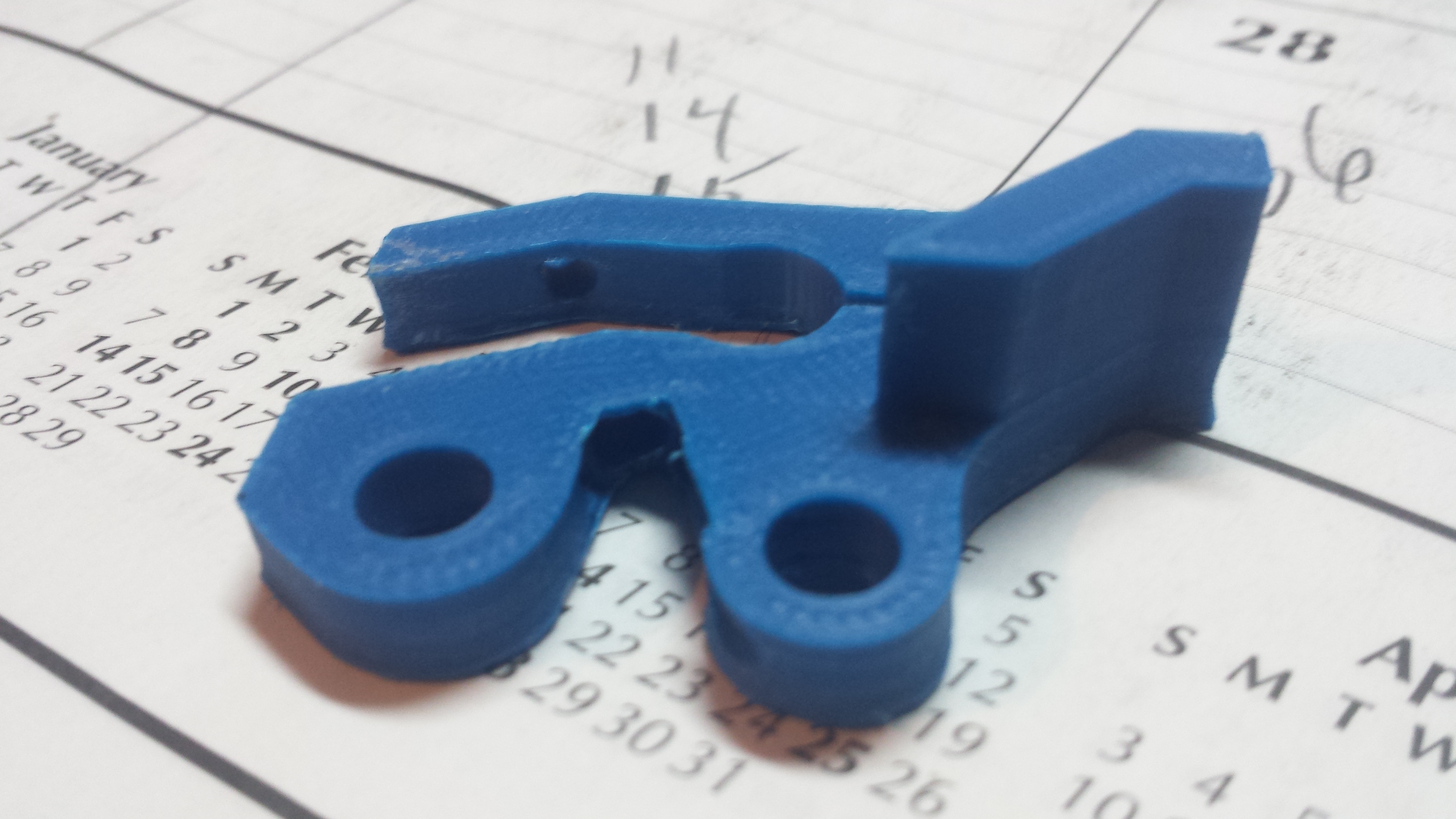

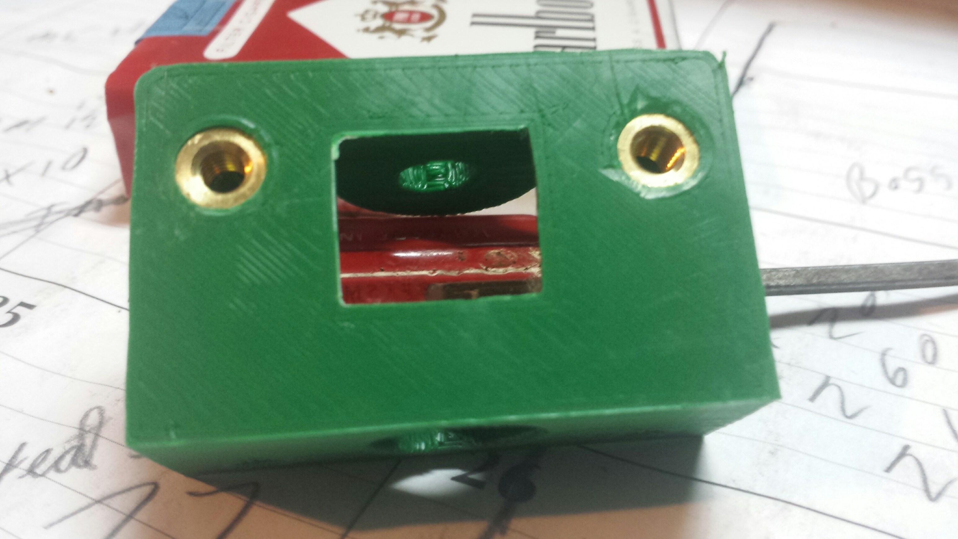

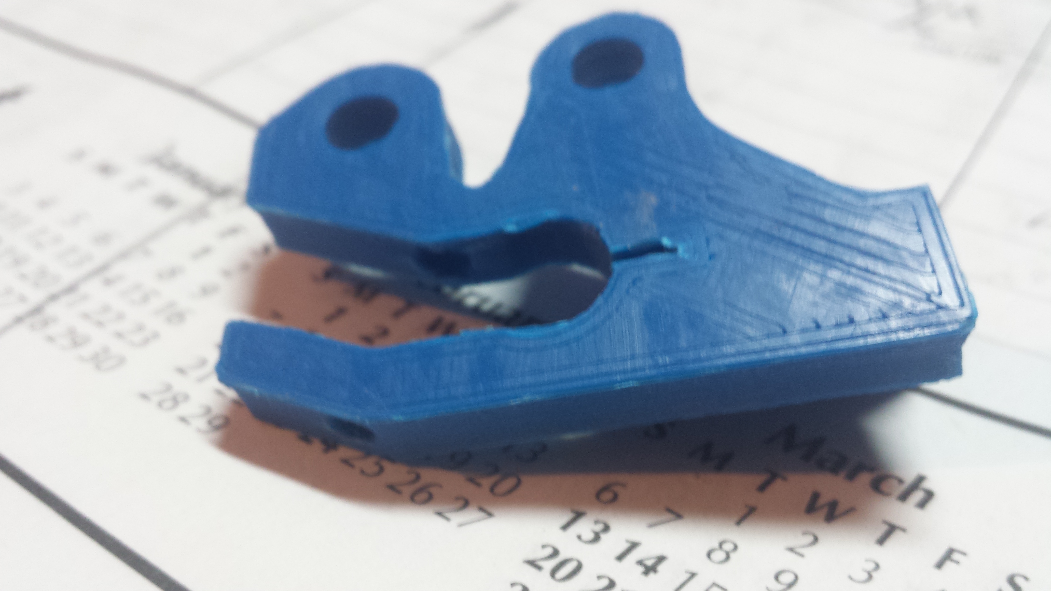

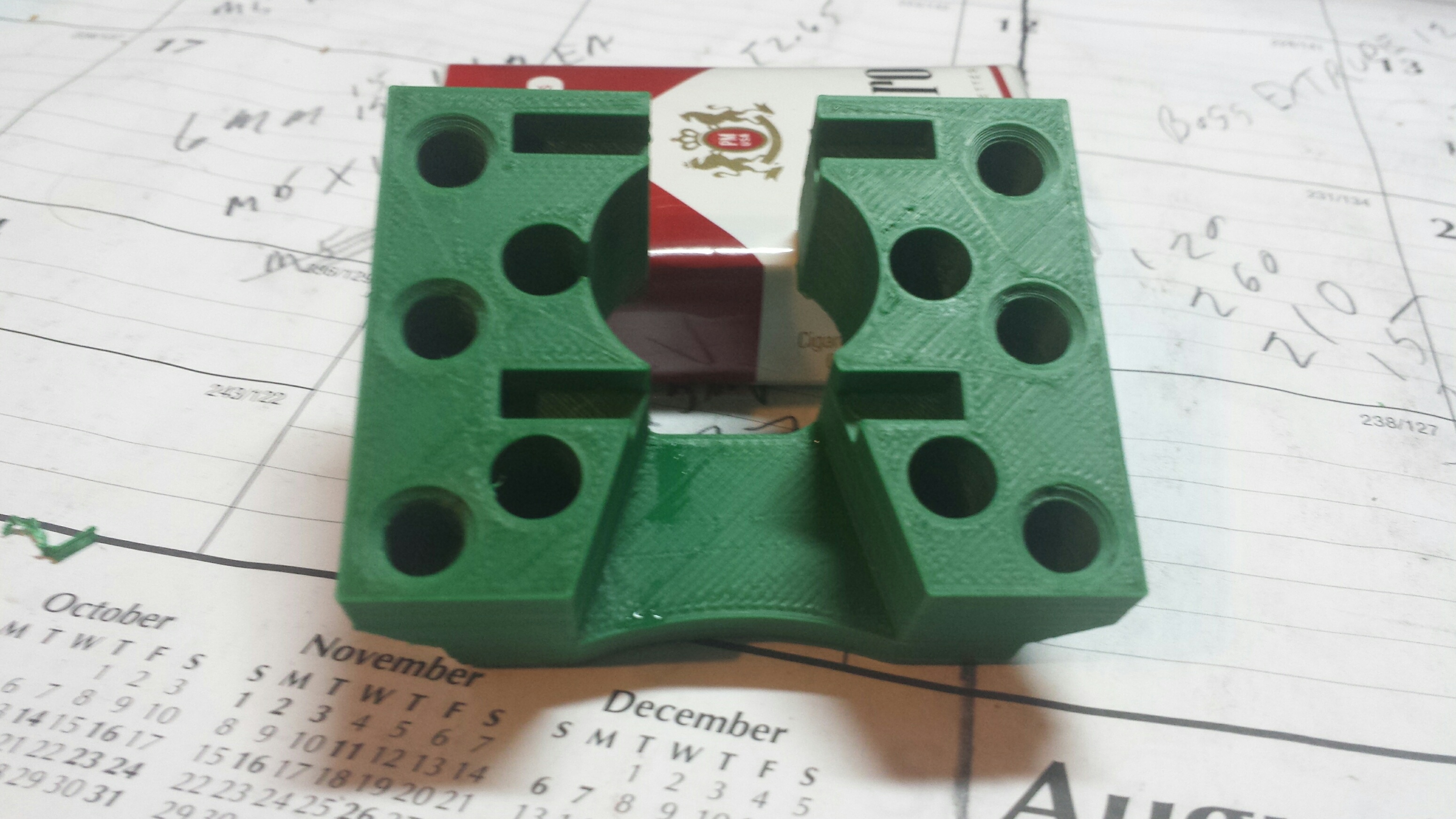

Okay as the saying goes a picture is worth a million words, the first one shows my latest finished part, of which I am happy but am wondering about the slightly raised surfaces inside the profile, it is not much about .001 or so, I can live with it at this point unless you wise people have any idea’s why they are there…second one shows the back of the same part minus the lines I mentioned earlier and will show in another picture…third and fourth pictures are just another gizmo (micrometer stop for Z height that I thought was kind of cool) my only concern with these is the out of round holes that it prints which seems to be a normal thing for me so far…fifth picture is the backside of the smaller part showing the separate lines in the base layer…
Hey, I know which upgrade you are working on, that top part looks familiar!
You’re welcome! (and I don’t think i’m too evil, I mean I do enjoy bagpipe music occasionally, but who doesn’t? and there was that overdue library book too.)
Modifying the frame may indeed void your warranty as written currently. If you tell them you did so… I would recommend waiting if you are concerned, or alternatively keeping the pars you remove and then reinstalling them before requesting warranty service if required and never telling anyone that you did. For what it’s worth I think that particular recent policy addition is not in the best interests of the company in the long term. I understand why they did it (people breaking their hotends swapping nozzles), but I still don’t like it.
As far as your prints go, they look pretty good for a stock Taz 5. You might have some slight excess bearing play (or possibly an overloose bed corner spring) in the direction of those upper right diagonal surface marks towards the upper right cable anchor in that first picture. Whichever direction that was sitting on the bed is where you want to look. Possibly the X axis double bearing holder. it’s definitely pretty minor though and it could just be the picture focus there. The marks on the lower left and left side I think are just residual travel marks from the nozzle, possibly a bit of leftover plastic ooze which can generally be ignored.

I am going to add a whole bunch of pictures, manly just to find out if and what settings I might want to play with
