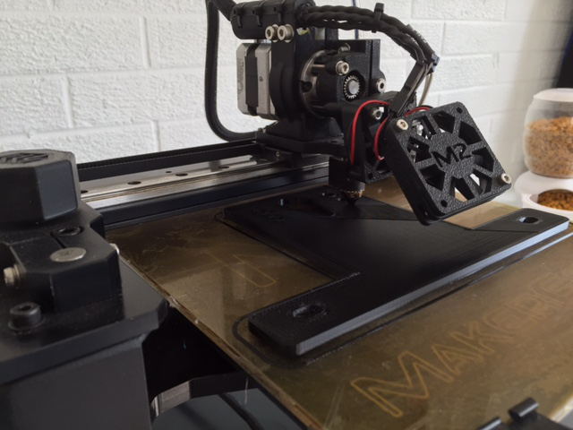

Well here is a print I am doing in PETG, its set open on that reel for maybe 6 weeks and I am printing a license plate holder for another trailer. Since it gets flexed and hit a lot, :slight_smile: when backing up the ABS one did not last long. This is for my jet ski boat trailer the other one was for the gokart hauler trailer.
The machine has been leveled once since August and I am ashamed to admit I just used it out of the box and its never been calibrated.
Nozzle .35, 245/75 settings for eSun. The OEM printhead holder out of ABS had a hairline crack, I printed this one from PETG. One clogged nozzle since August. Biggest issue is keeping the Cat from walking across the printer when its running!
