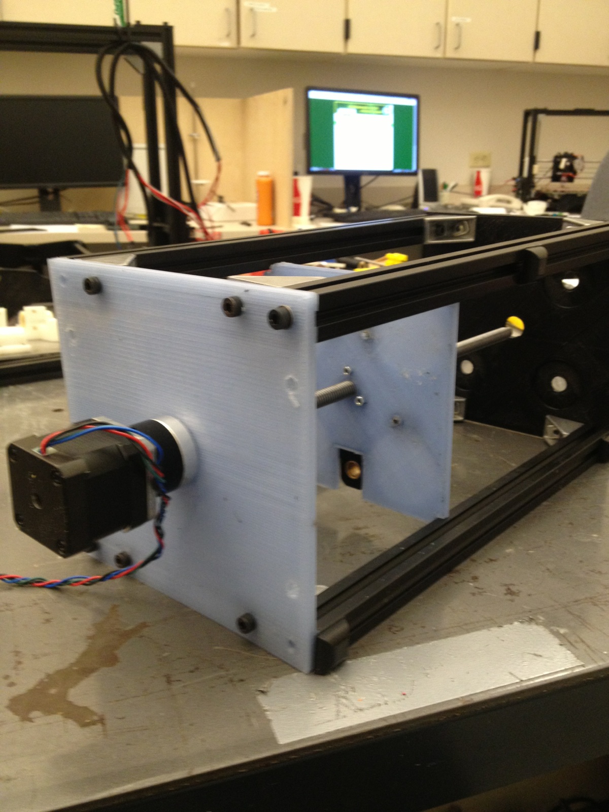

Going to try to have V2 posted over the weekend, I’m mixing up the design pretty significantly to allow mixing of pastes/chemicals and to allow better (read: ANY) retraction capabilities.
Here are some images I took before the phone died :slight_smile:

I can see you’ve made some updates to the design. I’m thinking of giving this a try but I’ve got a few questions.
  1. how torqy is it? could I push a ceramic through it?
  2. Have you played with any slic3r configs yet?
Have you made any more progress on this? How was the torque?
I’m curious if using a gear setup like wade’s extruder would be a better system for more torque. Maybe just one of those geared nema 17’s? Thoughts?
