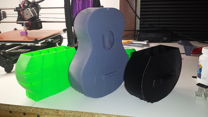

After my initial try with it clogged and broke my TAZ 5’s nozzle, I replaced the nozzle (with a .4mm E3d style) and went on to print many wondrous and somewhat large and complex parts with PETG (as well as ABS and PLA). I love it’s strength and lack of warpage.
Using the same profile I printed several parts in previously, all of a sudden I now cannot complete any part I try to print in PETG. Don’t seem to have any problems with ABS.
The print will start beautifully, but after several minutes of printing will stop and I end up with the half-moon cutout in my filament. It doesn’t appear to be a jam as loading the filament back in immediately extrudes easily with just light hand pressure. Reloading it will result in another few minutes of printing, but will end up the same way. This did this on the first print on a new nozzle as well.

The first time I printed it was in ABS and looked like a modern art body. Next was in PLA but it had poor layer bonding and was fragile though complete. Tried it in PETG and got 60% before failure. Now it fails in a few layers. It is a rather thin part (maybe.8 thick walls) could that cause extrusion problems?
FYI from my experience a lot of things on ThingVerse do not print right. The one you are trying is to thin. The sad thing is you can not edit a STL file, you might be able to scale it in such a way that it would work. But I think you need to just move on to another project.

I’m pretty familiar with modeling in general. Did it for video game mods for years. I use a variety of products for it, but right now it’s mostly FreeCAD for mechanical things. Meshmixer has a few neat features as well for printable models. I have tried to thicken the walls of the model but there really isn’t a simple way to do it evenly. You can edit it though in FreeCAD by converting it to a solid and tweaking it. The body has a LOT of geometry after solidification though, and there isn’t a non manual way to do it. Would take forever.
It will fully print in PLA and is so close to being strong enough. There are a few working examples of it in PLA. It would actually print in ABS but it warped so much I stopped it before it finished. The 50% body I got in PETG is quite strong despite only being 1mm thick and would work beautifully if it had completed. I don’t think I’m gonna give up on it just yet.
I’m not running the cooling fan for PETG. I did notice that the mini fan for the hotend vanes was full of dust though. I’m wondering if it could’ve been a heat creep issue. I was able to get successful test prints of other objects since lowering the temp slightly and cleaning out the fan. I’m right at the margin of having enough on the roll to restart it…I’ll likely just wait till the new rolls come in. I think I’ll test it on some legos.
Well, after printing out a half dozen or so nearly perfect Lego bricks, I decided to check my filament supply again and realized I had enough for the print after all. And…Success!!
The PETG is much stronger than the PLA and should work just dandy.
Just to close out the thread for those that come later, the problem was likely a combination of several things. Too low Z, too tight extruder clamp, and a bit of heat creep caused by a clogging hotend fan. Calibrating the e-steps probably helped too. I’m overextruding just a tad less now.
