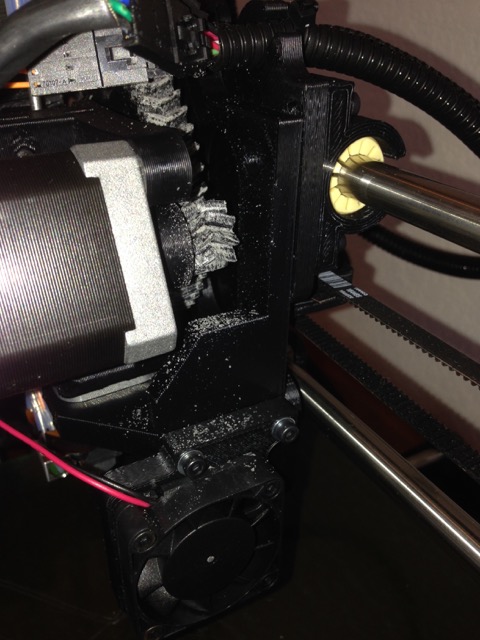

I just purchased a TAZ4, and have printed a few (6 now) items with it in PLA. My first print was Thursday night (three days ago). I’m using the Silver PLA purchased through the Lulzbot website.
Today, I printed a 6cm tall squirrel (my tallest print yet), and a couple times it sounded a little rattly. I let it finish the print, and a couple of the supports (columns) looked a but unravelled, and one side of the model was rather rough. I’m afraid to print now, though, because the extruder gears are covered in a grey plastic powder. The gears are black, so I don’t know where the powder’s coming from. I went through the setup in the manual when I first started printing, and haven’t changed the filament since.
On closer inspection, the plastic flakes may be black. A couple flakes were big enough to see that, while the rest is a rather fine powder. It’s almost as if the gears are disintegrating.
Is this a common thing, and does it have a known resolution?
It’s possible that the gears are wearing down abnormally, but unlikely. You may see a bit of powder from time to time after a few dozen prints or so, but they generally don’t wear fast. What is more likely is that the filliament is grinding inside the idler chamber, and the residue is getting on to the gear surfaces. Check your idler arm tension, and see if there is any sign of gouging or scalloping out of the filliament that is in the machine itself at the moment.
However, the plastic powder appears to be of black plastic (based on some larger flakes I found), while the filament is silver. So it seems that it’s not likely to be the filament.
I have slightly reduced the idler tension just in case, though. I’ll try a simple print of a small part later today to test.
Ok, I created a simple 20mm cup with 3mm walls, and it appears to be printing just fine.
However, in doing this, my first attempt at printing it made the whole printer sound like it was trying to force itself to do something it didn’t want to. It made a lot of noise and didn’t move. I turned it off, turned it back on, connected Pronterface again, and tried again, and it seems to be quite happy.
My extrusion fan was a little rattly though. I think that’s what I heard earlier that concerned me.
So, at this point, it appears to be doing fine, and isn’t producing powder. I’ll keep an eye on it.
Mine had the same kind of powder and after a couple months, my small herringbone gear split in half. Luckily, I was able to print a replacement gear with the broken one. I recommend printing a replacement large and small herringbone to everyone who hasn’t already done so. If those break, production is halted until you get one delivered.

I just got a Taz a couple weeks back and my extruder is covered in grey powder as well. Upon inspection I noticed that the small extruder gear is broken. I will print another.
I have, as yet, done nothing in regards to this issue, but my small herringbone gear has split in half. It’s still printing delightfully, though. I keep meaning to replace it with a gear that Lulzbot sent me when I first posted this issue, but I appear to be rather lazy about it, as it still works.

if the large gear is slipping, it can only be a few things.
Is the hobbed bolt loose enough that the bolt head has popped out of it’s socket on the large gear? if so, tighten the hobbed bolt.
is the hobbed bolt socket on the large gear stripped out allowing rotation of the gear when it shouldn’t be? if so, you will need a replacement gear.
check that the motor mount and small gear are close enough to the large gear that the teath mesh well
Check the set screw on the small gear to see if it is locked down and tight. This can show up as the large gear not moving correctly, but it’s actually due to the small gear spinning on the motor shaft.
So I looked closely and did not see anything damaged, so that is good. What I did notice is little ribs on the PLA when I removed it. Almost as if it was grinding instead of pushing through the extruder. I suspect that has to do with the spring, but not sure what direction to go, in or out.
