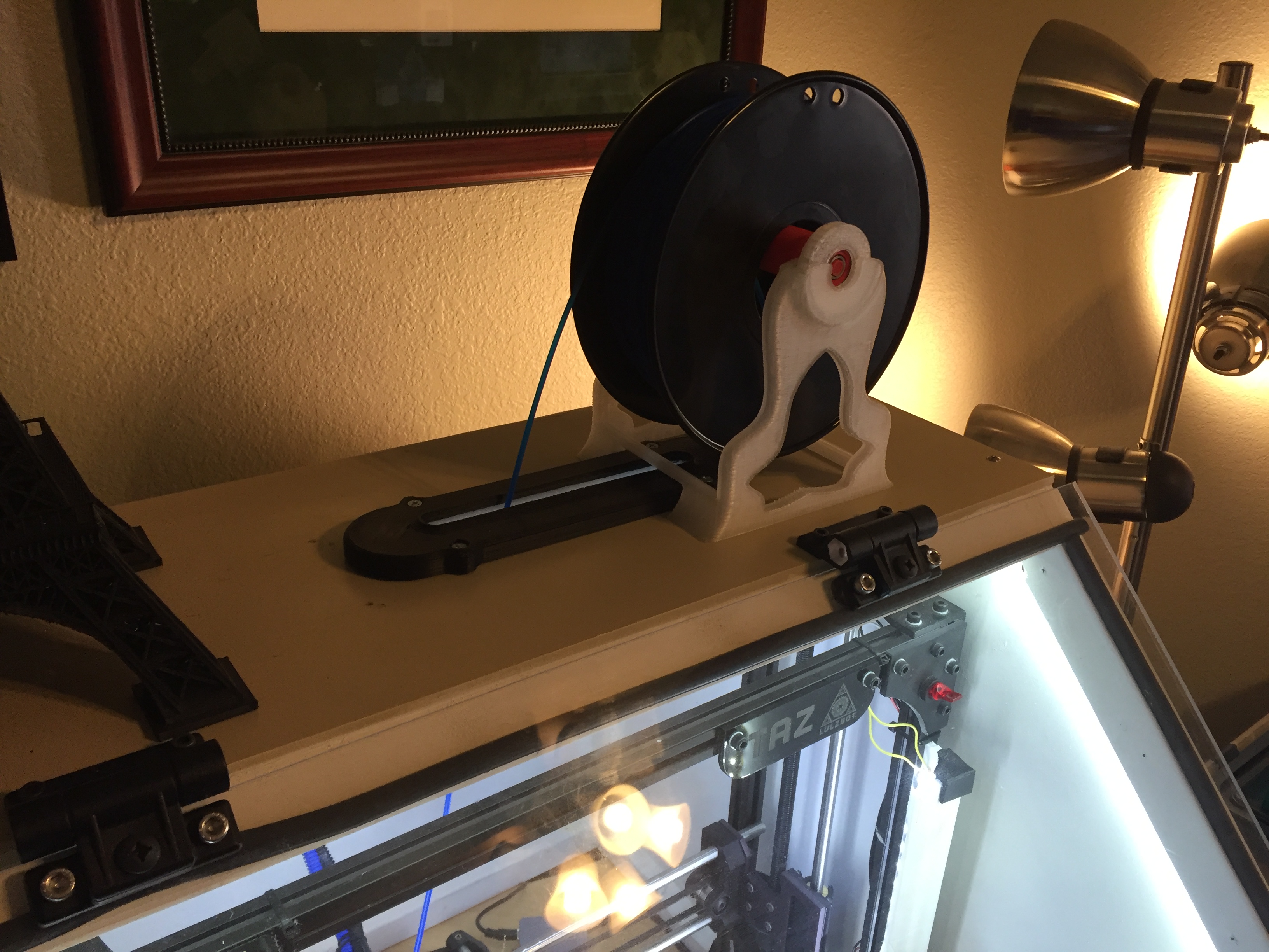

I’ve never read definitive info that says you can’t. Are you concerned with the look of having the spool on the outside or trying to figure out how to get guide it into the box? This is my solution using JonathanB’s stupendous design. https://grabcad.com/library/hotbox-diy-enclosure-for-3d-printing-1 I actually much prefer having the filament drop straight down into the extruder and i’ve tried many different options. And here’s the great thread in this forum. HOT BOX 3DP ENCLOSURE SYSTEM (For Taz) It’s a must read.

I’d prefer the filament inside to avoid drilling extra holes in the enclosure and make it more simple (especially because my enclosure will probably have a removable top, so I’d have to remove the filament before removing the top).
It’s not a big deal but it would be sweet to do it that way.
