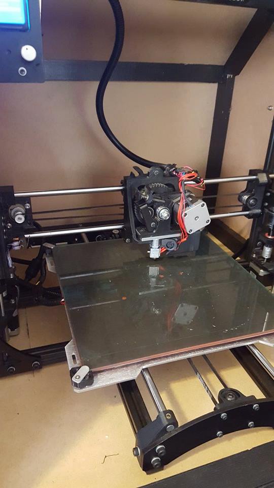

So I installed the hardened steel rods along with the linear ball bearings and dampeners. The machine is SOOOOOOOO quite compared to before. You can see my machine in the image below. Also you will notice the thin bed fingers I made out of aluminum
I was talking to someone I work with about my recent upgrade to linear ball bearings and he asked why didn’t I just use an oil impregnated bronze bushing. He stated that at slower speed they should be more accurate along with making less noise. What is your take on this?

If the ID of the bushing is even slightly greater than the OD of the smooth rod, the clearance will allow some motion. Whereas bearings can be preloaded. Also, metal on metal may wear faster - always consider applying high-quality grease with any linear bearing system (eg. PTFE SuperLube).
Also, the thingiverse page specifically mentions “you may have to ream out diameter with 5/16” drill bit to fit rods". So, getting good results may require carefully machining these to closely match your smooth rods.
