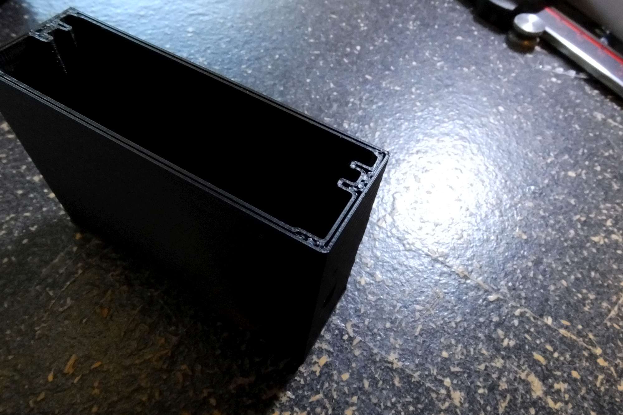

I just recently started having this issue. I’m trying to print a fairly simple 3D model, but I’m getting really nasty zits/blops all over the surface of my final print.

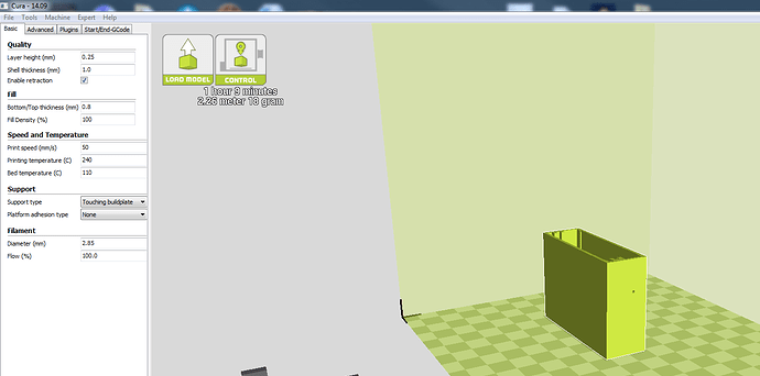

I’m using brand new IC3D BLACK 3mm ABS 3D Printer Filament, and the default “ABS_medium_mini.ini” profile with 100% infill.
Here is a picture of my latest print along with my print settings:

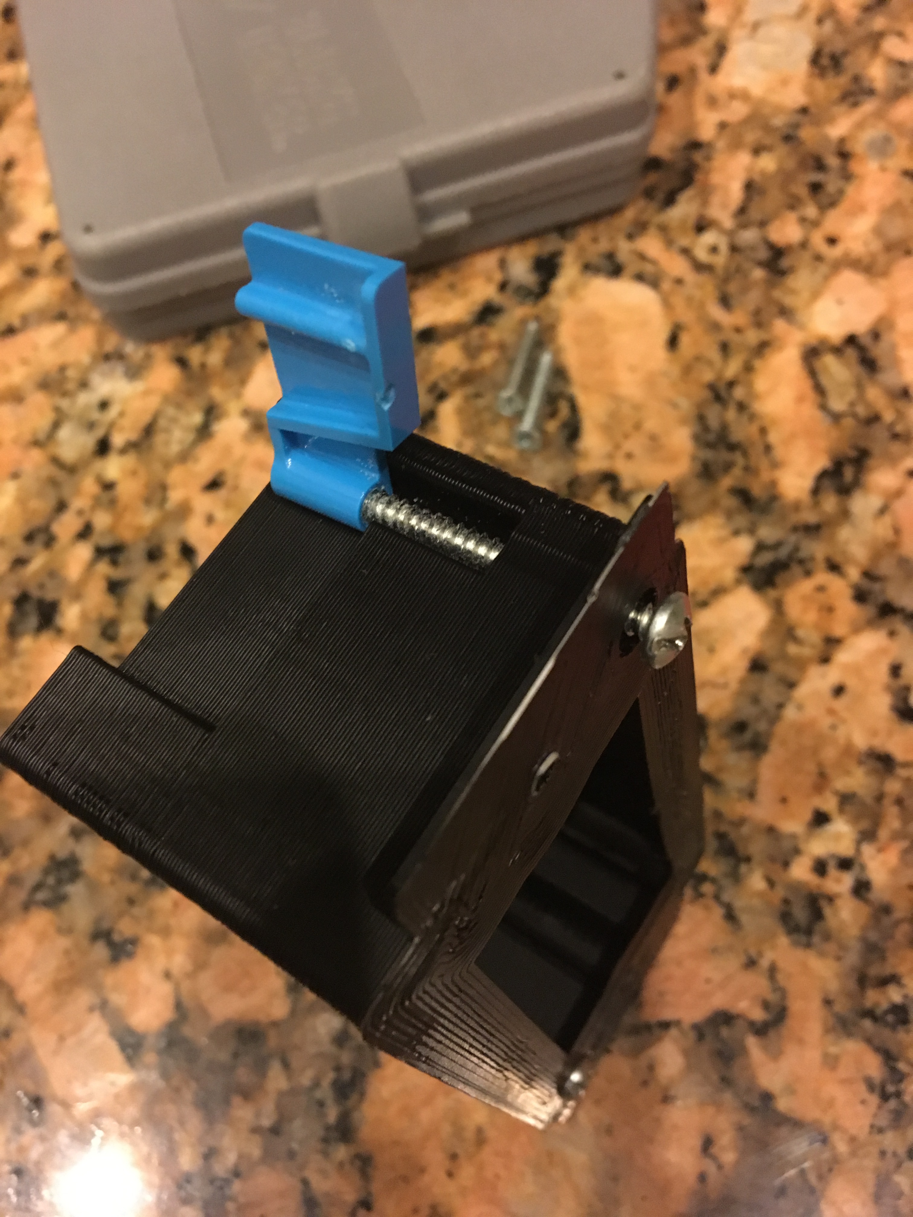

Possible over extrusion? I have the same filament and have to switch to Advanced settings and change the filament diameter to minimum 2.90mm (which is actually their spec). Based on your image I’d try at least 2.95mm, maybe even 3.00mm.ngive that a shot.
Also, what kind of surface is your printer on? There are a lot of ringing patterns on that print which is caused by toolhead oscillation after it makes the sudden and sharp 90-degree turn. If the table your printer is on for example amplifies any movement that effect can be amplified. These aren’t the best images but what I have handy. You should be able to get smooth, straight sides like these (IC3D Black ABS @ 100% infill)

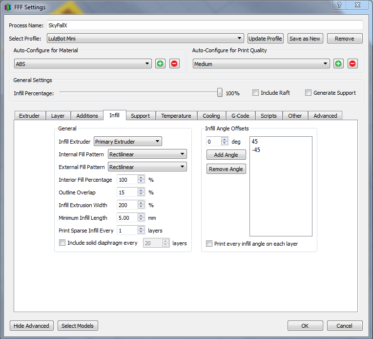

There is a gap between the outer shell and the inner shell. I’m using 100% infill, but for some reason Simplify3D seems to ignore this, and prints “hollow” parts.
I read on the forums, and someone suggested increasing the Outline Overlap setting, so I tried that next. I changed the default value of 15 to 40, and this fixed the gap issue, but the outer shell of the print started messing up again.
Pics of the prints with 100% infill and the Default Outline Overlap setting at 15:
Sides look MUCH better. What you might want to try is on the Layer tab, increase the number of “Outline/Perimeter Shells”. If you have it at 2, make it 4. Also on the Advanced tab lower-left make sure you have “Allow gap fill when necessary” and adjust the percentage up until you see the gap being filled in the gcode preview. Give that a shot…

Changing the extrusion width from Auto to Fixed @ 0.50mm looks better, but I notice the preview still shows some gap (look near the corner):
Is I change the extrusion width back to Auto and instead go to the Infill tab and change the Outline Overlap to 50%, look what happens: @mpick67, if the extrusion width setting doesn’t completely solve your issue, try this additional setting. Also, no need to print the entire model, you can print just a portion of it and/or use multiple processes to test different settings in the same print job on the same model. Let me know if you need more info on how to do that.

Are you hiring any popping/snapping when printing?
I printed the stl again in CURA for a baseline with a Filament Diamter of 2.95. While this improved the CURA “version” of the print slightly, I still see significant blobs/zits like before.
I then printed the file again with Extrusion: AUTO and Outline Overlap: 40% (I chose this over 50% because this was the lowest outline overlap that infilled 100% of my model according to the gcode viewer.
Also, I edited the model slightly to make all of the wall thickness of my model the same. One wall was .005 mm thinner than the rest. Here is the new stl I’m trying to print. Again, thanks for all the support and help guys! I really appreciate it! nasa cast v2_fixed.stl (119 KB)
Those are at least mostly layer start points. You probably have Randomize Layer Starting location and Start external perimiters first enabled. That or this is a thin enough part that it can’t hide the start blob inside. If you turn off random layer starting location, you should end up with those blobs in a line. You can minimize them by playing with retraction settings, making the model a minimum of 3 passes thick, enabling a “start layers in corners or inner perimiters” button if cura has one, or similar techniques.
Personally, I would redesign the box so it is a multiple of my extrusion width, so that there is either a good amount of infill, or it only uses perimeters for infill.
Simplify 3D has known issues with thin walls (although if you design around the issues, they no longer become issues ). The gap fill quandrum is another issue.
If you can redesign the wall to be a multiple of your extrusion width that would be best. Otherwise adjusting the extrusion width slightly (+/-.05) can fool S3D into getting a better thin wall fill.
I experienced the same printing your model. What did you design it in and what wall thickness were you going for? I measured 1.61mm ~ 1.63mm. Echoing what others have said, try making your walls a multiple of your nozzle size (if fixed) or extrusion width (if auto)…
