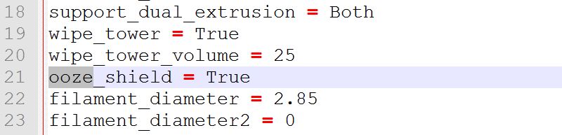

You are getting a wipe/prime tower, the white outer square, the gold inner square, and an ooze shield. The picture they used does not have the wipe/prime or ooze shield enabled.
You would need to go into expert/full settings to turn those off.
Yep.
After you select Expert - ABS & ABS from the quickprint screen, go into the expert settings and turn off “Wipe tower” and “Ooze shield”.
In the pictures, ignore the center square which looks multicolored and outermost square. Measure the gap between the two inner squares with solid colors and plug those numbers into the Dual Extruder Offset Calculator.

This bit be in the butt as well. Couldn’t figure out what the problem was and it drove me nuts. I ended up downloading a profile, which thankfully had these settings turned off so that I could get good prints. The documentation at https://ohai.lulzbot.com/project/dual-extruder-v2-tool-head-installation/accessories/ makes no mention of these settings. Would be useful to new dual extruder users to know this, hopefully Lulzbot will update the docs…

Are the ooze and tower settings on by default under the quick print modes?
Yes. Both Ooze Shield and Wipe Tower seem to be enabled for quickprint.
