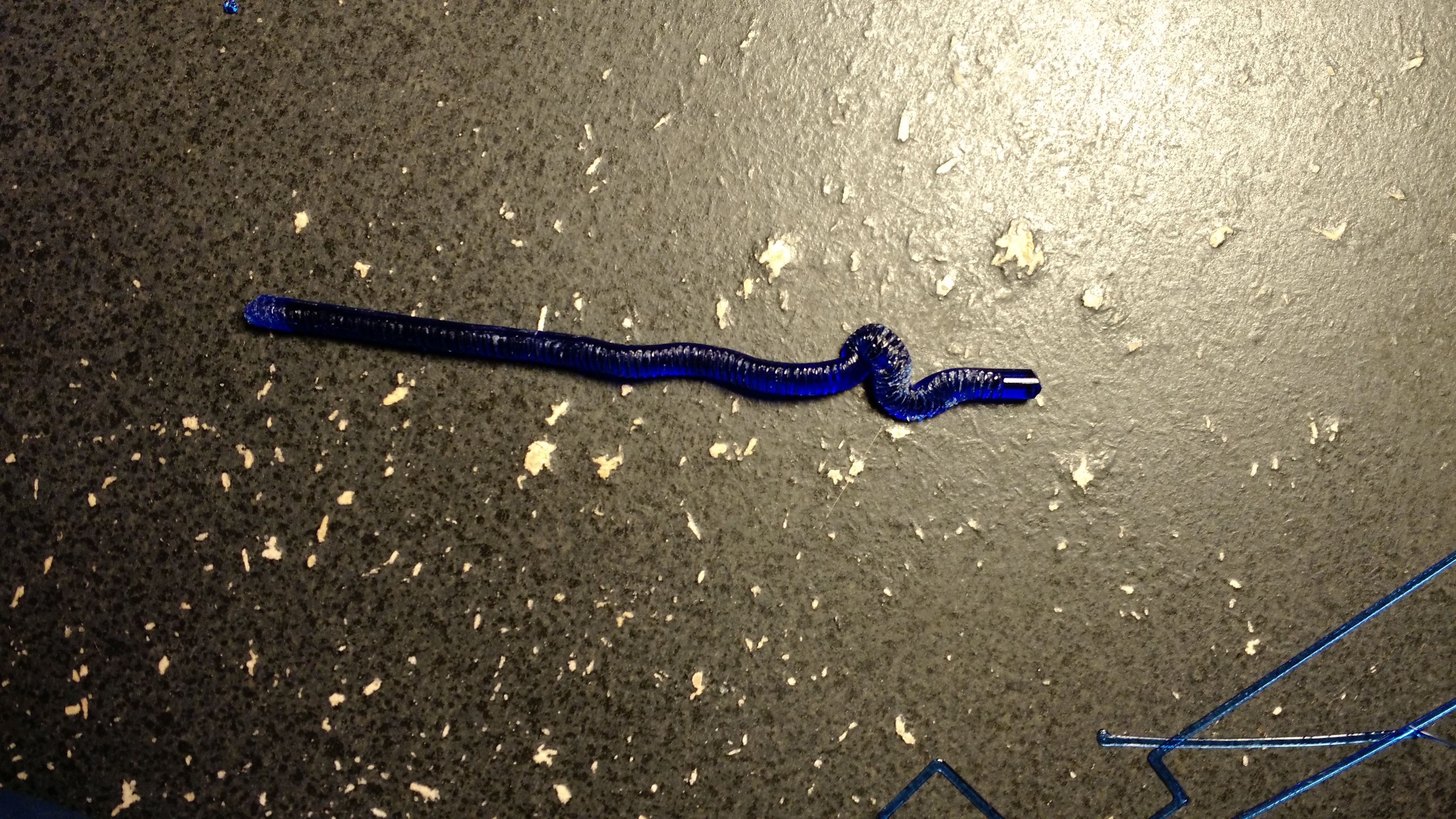

Hey folks, thanks for the advice. I’ve been running the printer longer now and am still having the same issue, but am back with some more information.
The problem is still that it often stops extruding partway through a print. When I open up the head, what I find is that the teeth of the bolt have scraped out a big groove in the filament, leaving it with no traction to continue pushing the filament down. I often also find that the filament has lumped up or twisted right below the bolt, like one of those twisty straws.
So for whatever reason, something stops the filament from being able to go into the extruder. The bolt then continues trying to turn and push it down, but this causes it to get stuck and carve a groove out. But why is it getting stuck in the first place?
I’ve had this problem with PLA, PLA(H), PET, and ABS, at a variety of different temperatures and retraction settings. Whenever I cold pull, it works fine for awhile. The jam usually occurs after 1 hour of printing. If the problem was some other material remaining in the extruder, I’d expect it to happen sooner. And I’ve had times where I printed several things in a row (10+ hours of printing) without a problem. If it was some flaw in the extruder itself, I would expect it to happen more consistently.
What could be causing this?
The most likely cause of what you are seeing there if you have seen it with other materials as well (Specifically ABS), is electrical. ABS isn’t prone to bore lock. Either you have an intermittant short in the thermistor or heater core, or inadequate cooling on your rambo board that is causing issues after the machine heats up for a long period of time. Check that your fan is functional on the electronics box, make sure it isn’t inside an enclosure, and if it is, it has adequate outside air for cooling, possibly replace the fan. Also check the wiring and plugs, and consider building a new wiring harness and replacing the thermistor.

I’m not sure if you have already solved this problem but I was wondering, are you using a standard print head? The one with the mini blower? I noticed on my Taz 5 I was having clogging issues and it was heat creep. The mini blower wasn’t cooling the upper part of my nozzle enough and my filament was getting soft and clogging. I would have to let my printer completely cool down and then I could print a handful of parts before it acted up again. I don’t know if this helps, but if you do have the original head, try upgrading to the Taz 6 head.

Just because your hotend barrel fan is working doesn’t mean it’s working properly. If you’re getting heat creep up your barrel, chances are that your little blower fan is dying - it’s a fairly common issue. Replace the fan with a 40mm axial and your pla issues should be a thing of the past.
