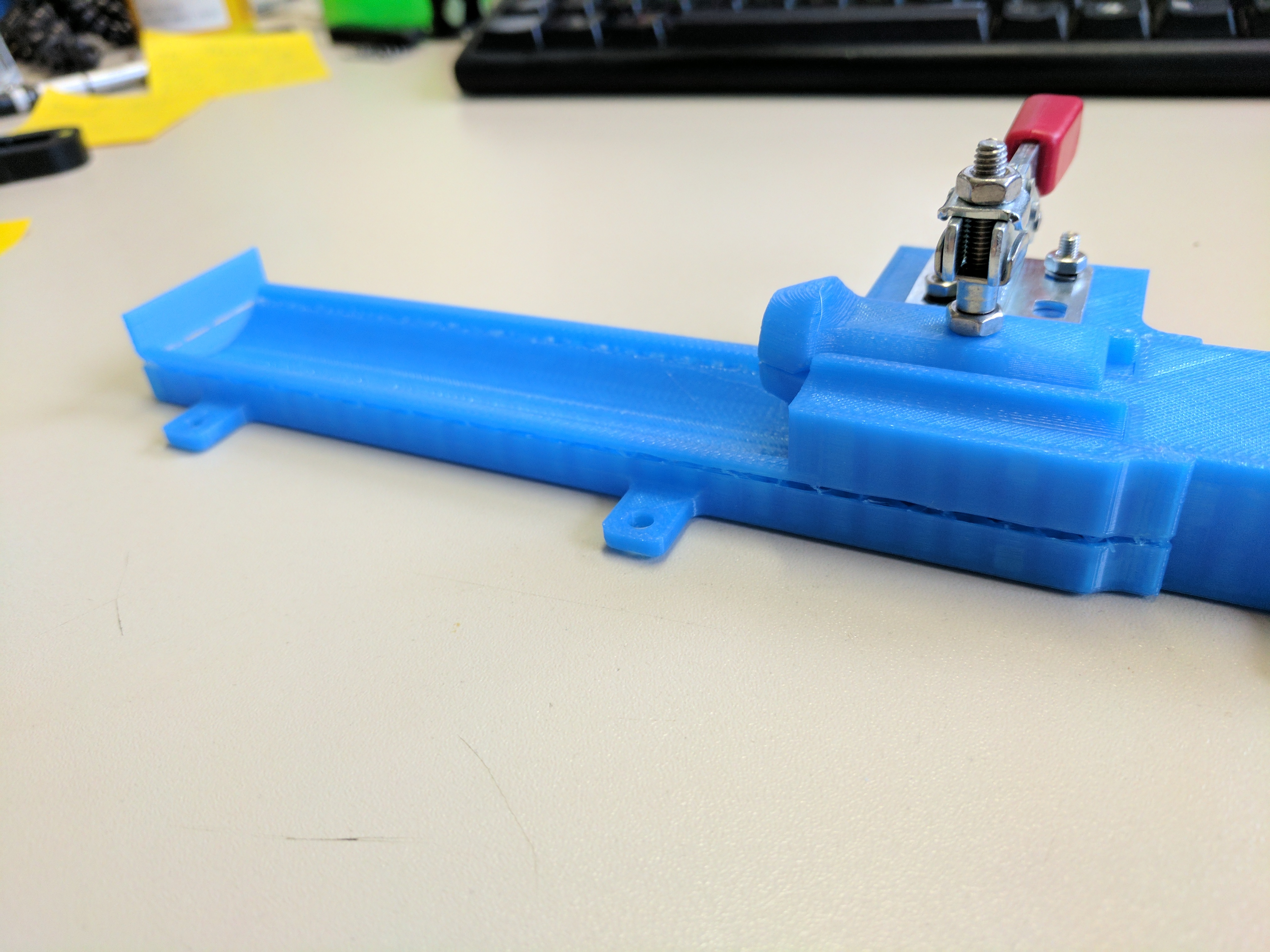

here is a picutre of the failed print. I still can use it since I discovered the problem 3 layers later so I pulled out the old filament and put the new one in so it was able to finish the print more or less:

Ok the Cura slicing did also fail… almost at the same layer height… hmm strange…
So it must be somehow a heat problem… or not?

I really push the limits of the printer in terms of short extrusion over a long time period and this probably leads to failure.
I now have two successful prints one 5 hour and one 11 hour.
I did reduce the Outline overlap and this seems to work. However I now have really tiny holes see picture:
If I increase the value just 10% they disappear however on large prints this might result in a failure later during the print…
