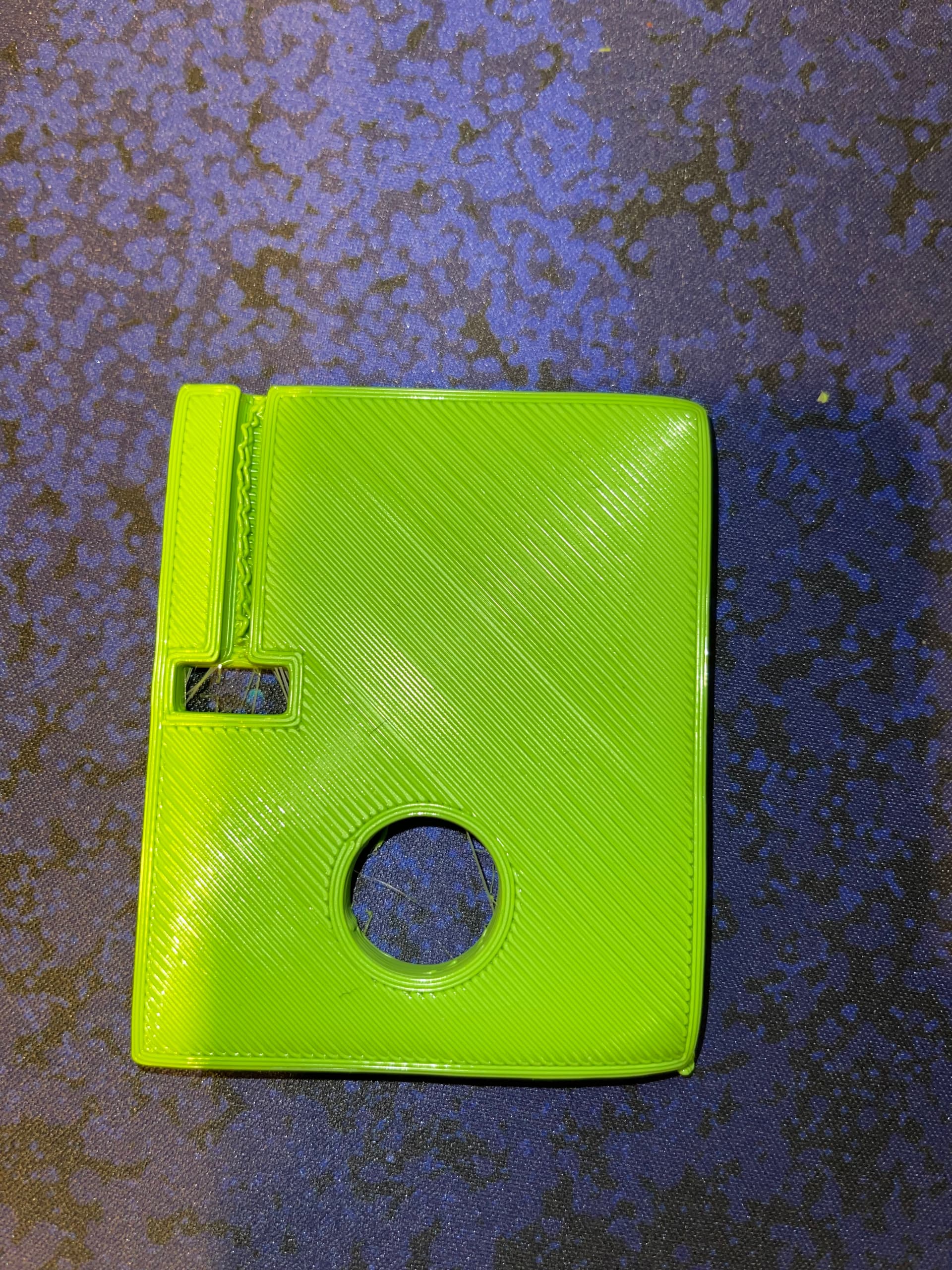

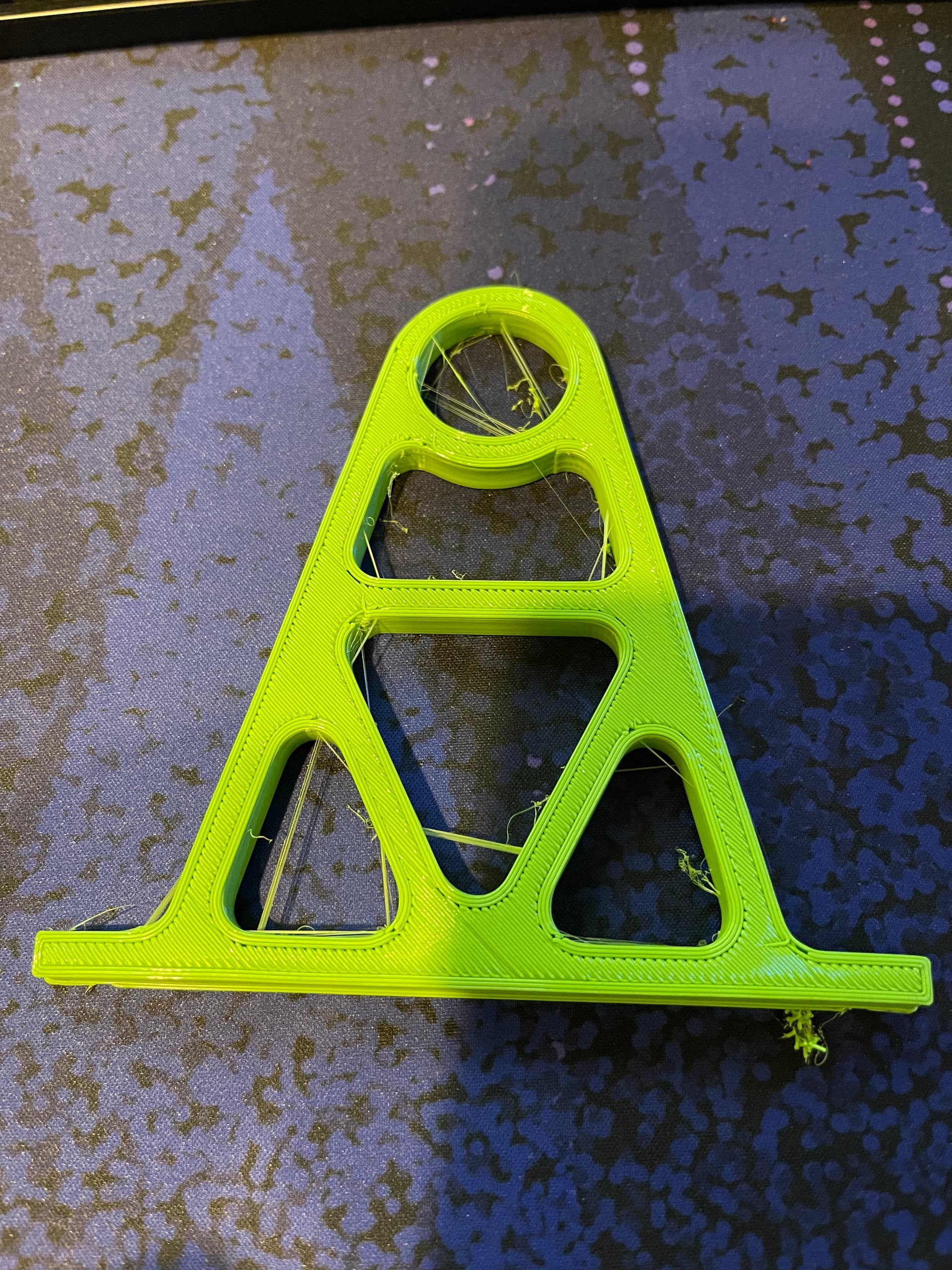

Here’s a failed print of the spool holder with -1.5 z offset.
This was printed with 215c first layer, bed at 65 first layer. 195/60 after that. Corners peeled on the bar at the bottom and are bending up but it would’ve been usable. Filament grind stopped the print again I took the tube off between the filament guide and the print head.

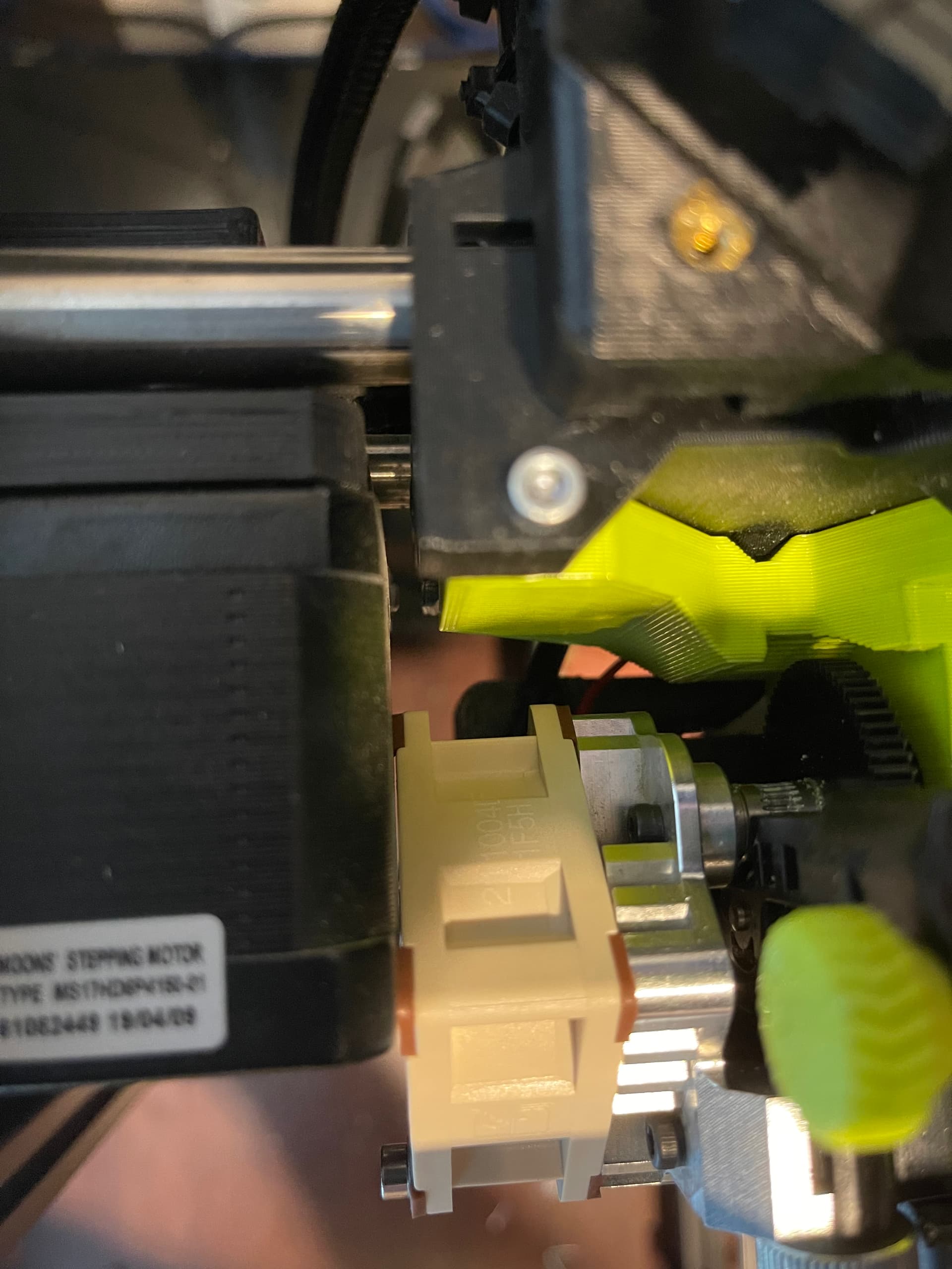

So I think we need pictures (or maybe a video) of your assembled tool head with the new fan (or the old fan) mounted on the printer.

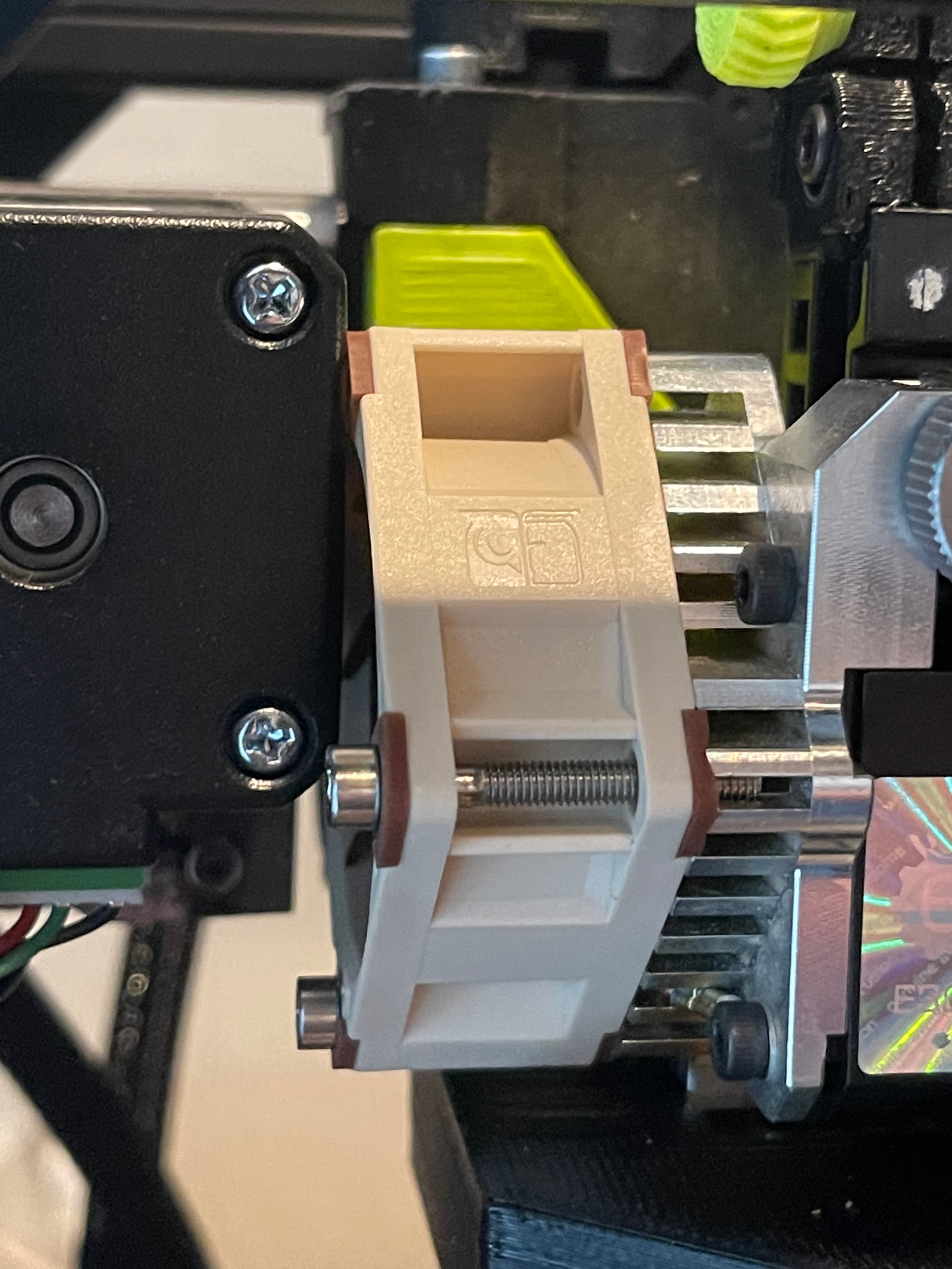

You replaced the stock cold end fan with a NF-A4x20 5V which is thicker. Is it interfering with the X end stop? Perhaps preventing the tool head from reaching the end stop? This is the only thing I can think of that would cause a failure to home and/or grinding.
Replacing the stock cold end cooling fan with a NF-A4x10 5V fan would have the same dimensions as the stock fan but would have a higher CFM.
BTW, I’m not completely convinced that we are dealing with a heat creep issue assuming that the stock fan is blowing in the proper direction.
I will reassemble and provide pictures in this post, it is interfering with the x end stop. It is running into the motor for the x axis movement. I can order the 10mm fan defaulted to the 20 because more CFM when I compared. I see the x end stop bumper switch, and it looks like it is ~5mm now that I took two bolts out of the fan that were hitting otherwise it was like 6mm. Give me a few minutes to post pictures, and thank you so much for being willing to help!

Thanks, this is what is happening with the prints that don’t stick well without higher print temps. Note the corner peeling. I just got stuff setup to do a temperature tower tomorrow.
Rocktopi printed with 240c and -1.6 z offset, maybe 1.6 is a bit high. I can dial in from here as adherence to bed was amazing.

Your z-offset is much too high. You will want to lower that to help with your bed adhesion issue for the parts that are not sticking.
You think it’s too high on the rocktopai in the last photos?
Not on the rocktopus, but all of the other prints you have supplied pictures for.
The new noctua fan arrived yesterday. I put it on and tried a print, no dice. Failed from grinding at the same tension I’ve been using for eSun pla+ and I swapped to a roll of that before the print. I will see what happens when the new motor arrives on Friday.
