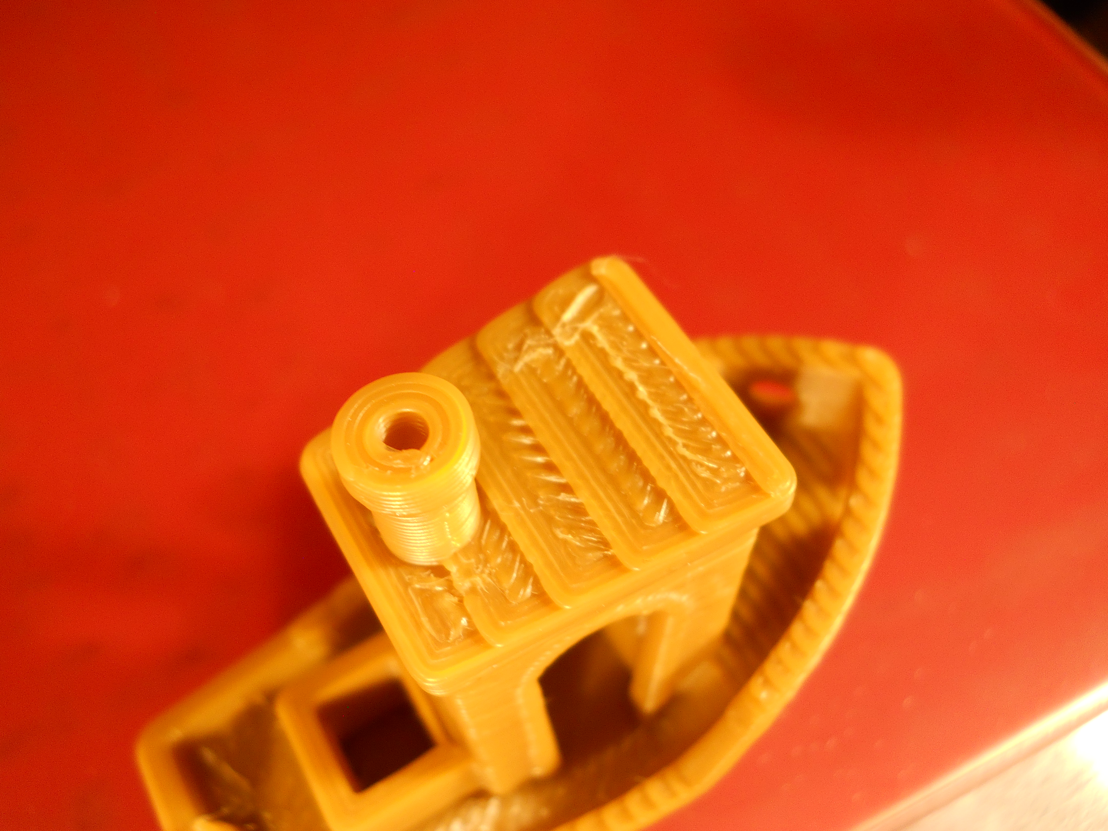

This imgur album: Disappointing Stock Taz 5 Benchy - Album on Imgur is the 3dBenchy printed my TAZ completely stock.
Here’s the album after installation of discojon’s toolhead upgrade: Benchy after discojon upgrade - Album on Imgur
Settings were the same but clearly the extra cooling just wins. Sure there are divots and zits which are Cura related but overall, I think you would agree that the upgrade was essential to getting a decent print out.

Yeah the dual extruder fan mod helped your prints a lot! Nice job!
Just to clarify, The dual fans are from Lulzbot, as is the extruder carriage. The reinforced mount was from another member here (sorry can’t remember who). I took the original concept for the reinforced mount and just made it work with the mangrove parts. Be sure to print out the newest left and right fan ducts from the olive directory and attached below as they divert the air lower away from the thermistor and cartridge.

Attached are images of two Benchy prints made on my machine - one ABS and one PLA. The machine is physically stock, but I modified the Marlin code to compensate for the X sag because wide prints had the first layer separating from the object at the ends while being well attached at the center. As soon as the help desk indicated the problem, I instantly thought of a machine I worked on in 1978 where electronics + mechanics were used to help compensate for Z axis droop. Note that such compensation is a last resort - the machine must be made mechanically as good as possible first. For the moment, my machine is as good as it gets, but…
As yet, no enclosure for the machine. The ABS print was not as good as the PLA. The temperature was too high when printing the PLA so some goobers and spider threads are present - I did not want to spend two hours printing another properly. Except 1st layer, ABS layers were 0.4 , PLA 0.2. ABS shows separation on the front of the wheelhouse and some layer gaps.

Your ABS temp is too low.
What characteristics of the print help you see the temp is too low? I can see some things indicating my PLA being too high.
Is there a place to visit that lists the types of things to observe? I’d expect different brands, and potentially batches. to need somewhat different temps so observing prints early in a spool can should help printing with the rest of it.
Looked at the gcode: the PLA was 205/200 (1st layer/rest) and the ABS was 235/230.
