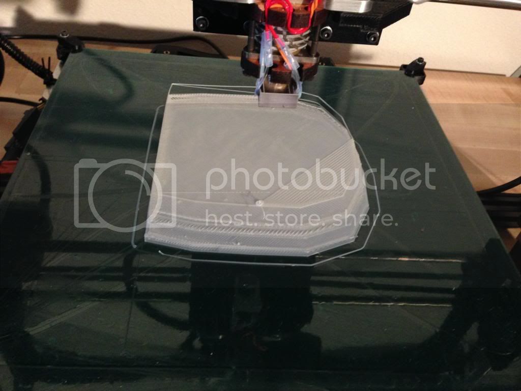

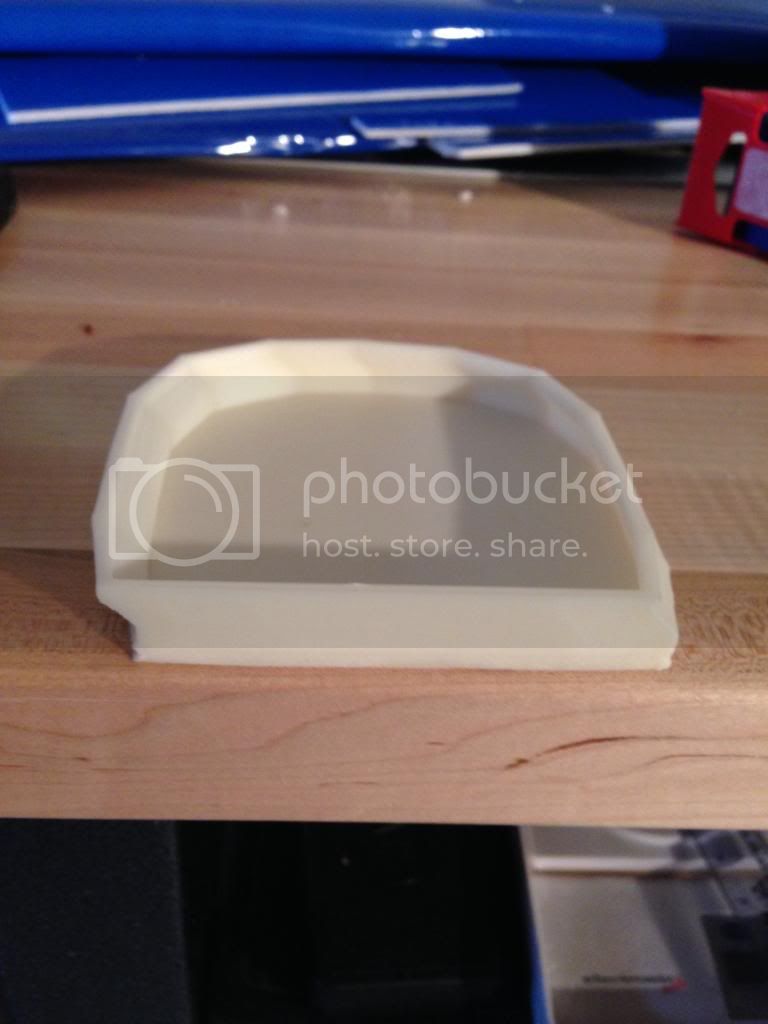

Hi everyone, I’m trying to print a larger item that is basically has a flat bottom with walls, and the walls are severely shifted. I’ve tried tightening my belts, but it doesn’t help. Smaller items, such as the octopus test print, are fine, it’s only larger items that have this issue. Does anyone have any suggestions?
Here is a picture of the whole object printed with the shift:
It has been getting worse, here is the latest print, stopped early because of how bad it was:

You aren’t getting any lifting that I can see. I’d try tightening the set screws on the pulley for the X axis if it isn’t the belt. Do you have a belt tensioner on the X axis, or are you tightening it manually by loosening the belt and pulling on it with your hands?
for some reason it is loosing steps. in X. try to slide the x axis by hand left and right while the motor is active. (just do a manual move in x and the motor should stay active for a few minute). you will be fighting the motor that is trying to hold the X carriage in place, but if you can move the carriage by hand, you might be able to see what is slipping.

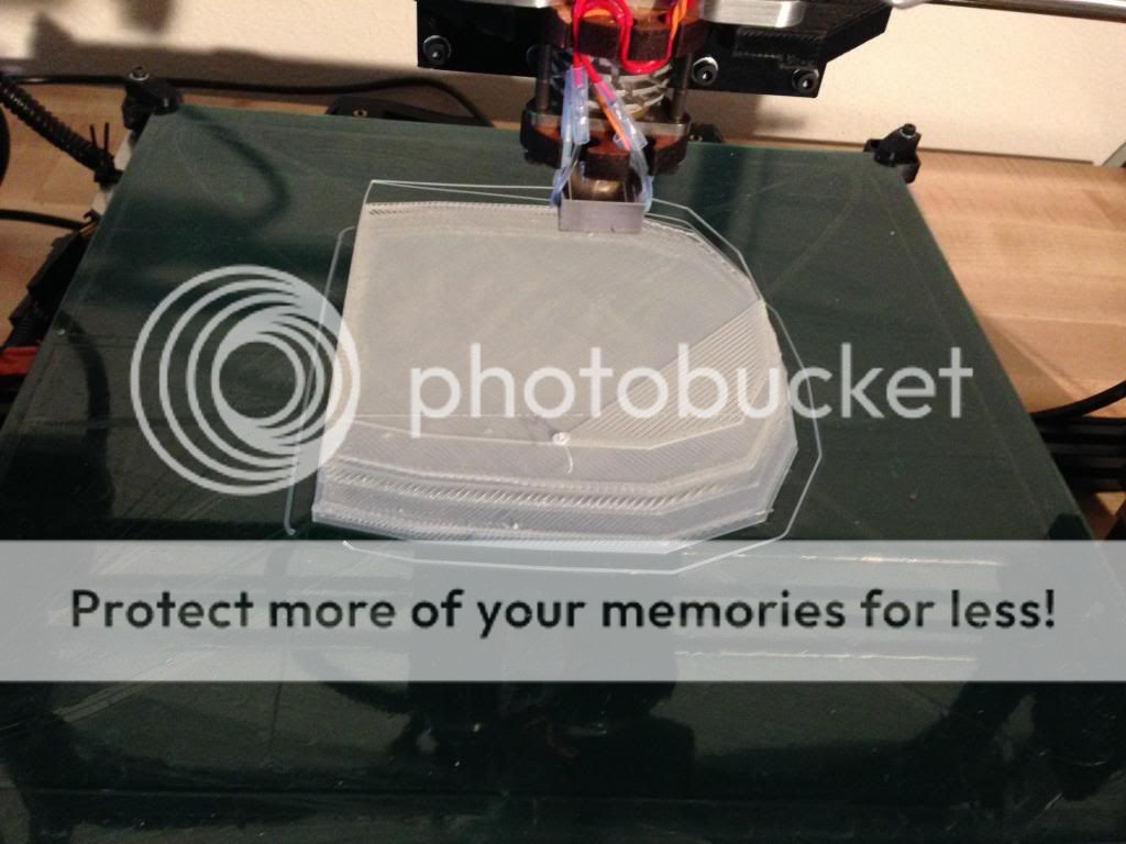

I tried printing again, but the problem doesn’t seem to be any better. I took a picture of the first layer, as you can see at the top, it kept going a little bit past the skirt. As layers get higher, it will keep going farther and farther past the skirt.
You can see I have other issues as well The z-index height isn’t right at the top, even though I’ve spent hours trying to get it calibrated properly, and it lays down a little extra filament when it changes direction, even though I measured the filament with digital calipers and the setting is correct in slic3r. I will continue to work on those issues, but the major issue is the shifting.
The belt or the drive pulley is loose in the direction of bottom to top of that picture, whichever that axis alligns with. Maybe it isn’t your X axis but the Y axis? It’s definitly the hardware somewhere, and it’s definitly skipping. Try 1013’s suggestion from earlier in the thread if you haven’t already. If you’re careful that should show you where the movement is happening.
Looking at this picture again, you can see the reflection of the X axis bearing rods in the build plate glass. It looks like the shift is occuring in the Y axis direction, perpendicular to the X axis.
It’s working again, thank you! Nothing seemed obviously loose, but I messed with it and it’s working now, must have been the Y axis as you said. I figured it had to be something with the X axis because of how messed up it seemed to be, but I guess not!
