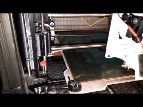

We haven’t been able to find a solution and I have been instructed to try with the community :slight_smile:
So, I have made 2 videos.
-One is with the stock lulzbot TAZ 3 firmware showing the absence of problems in Z movement
-Second is with the hexagon lulzbot TAZ 3 firmware showing the actual problem (you will hear it)
My thoughts are that if the problem were hardware related, it would be with both firmware.
To give some previous info-
Support provided me with TAZ5 firmware and I tried printing, which led me to wrong Z heights for my prints. They were squashed
They probably forgot during our long correspondence that I am a TAZ 3 user, I won’t blame anyone of course. All this tempering is at my responsibility.
Also, please notice strange behavior in the videos-
the one with the trouble Z movement has a rather higher speed and I think it goes overshot! I keep giving it a 10mm movement and I think it moves more.
So here you are. Some leads if anyone would help.

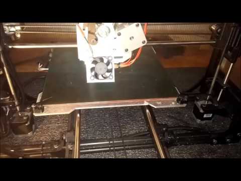

I need to see both Z motors at the same time in both videos to be sure. Is it possible the nosie is coming from the right hand motor out of the picture?
Mechanically,the system looks fine on the left. It’s either the other motor, or a motor voltage difference that is just making things louder. The Taz 4/5 leadscrews are slightly more massive, so it makes sense the firmware for the hexagon hotend might have a higher stepper motor voltage in the firmware left over from the 4/5 firmware if they started with a 4/5 firmware and worked backwards to make it Taz 3 compatable.
Here is a video of them together-
The noise is coming from the left side I am pretty certain.
Also note that when I disconnect them I leave just the left one, it works without the noise.
And I never lose alignment in X axis. So they are definitely working together
Support said they tested it on the same printer as mine and everything worked fine.
Could something weird have happened from TAZ5 firmware installation, that sticks around even after I install other firmware?
Can I do a “clean” install somehow? Reboot the Rambo clean… I dunno because I am getting out of ideas…
The motors are both rotating in sync, so its not mechanical offset or a reversed motor. And it works on the old firmware so it isnt electrical. It has to be something in the firmware, but it doesn’t show up on the other test machine.
