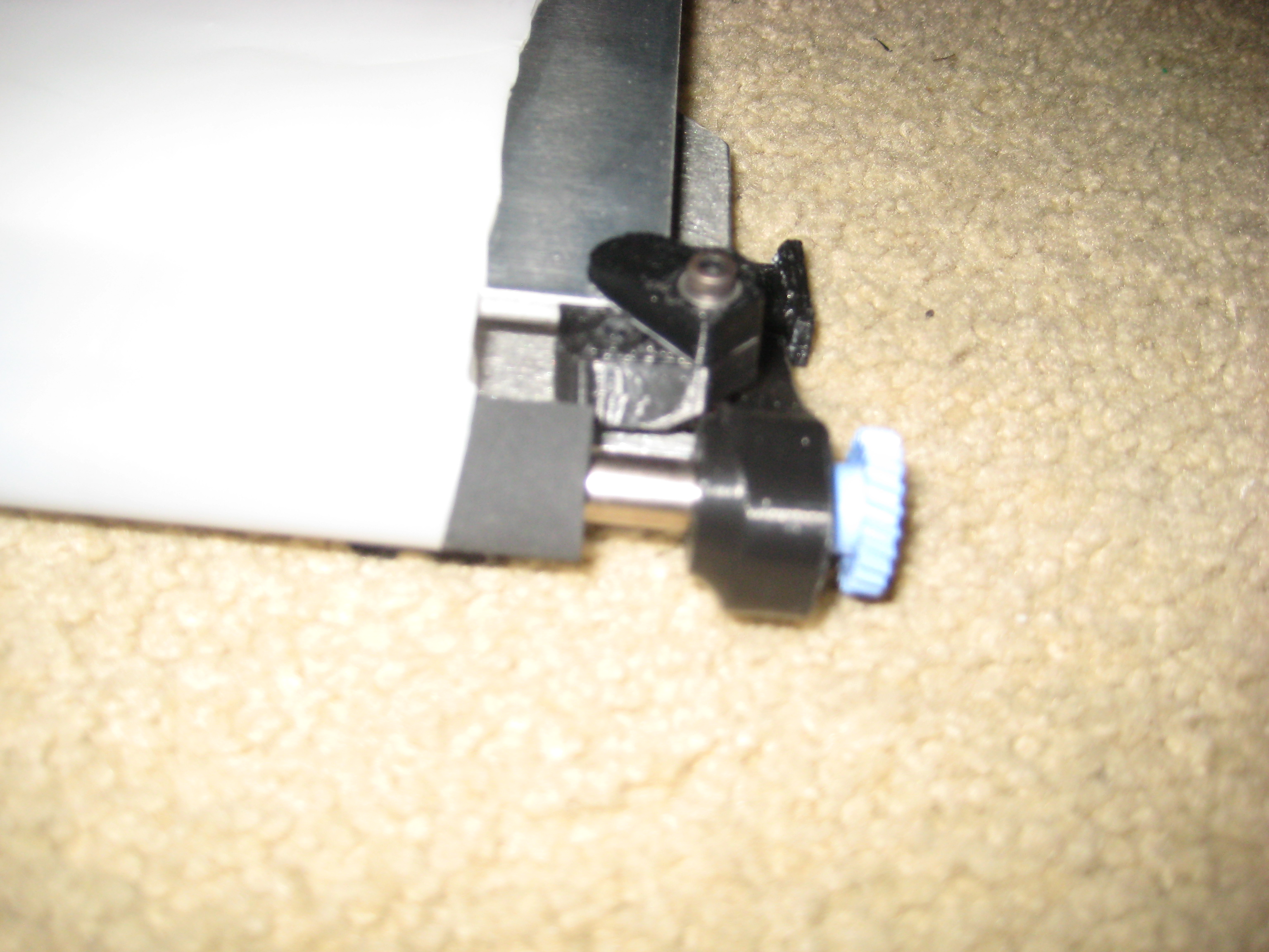

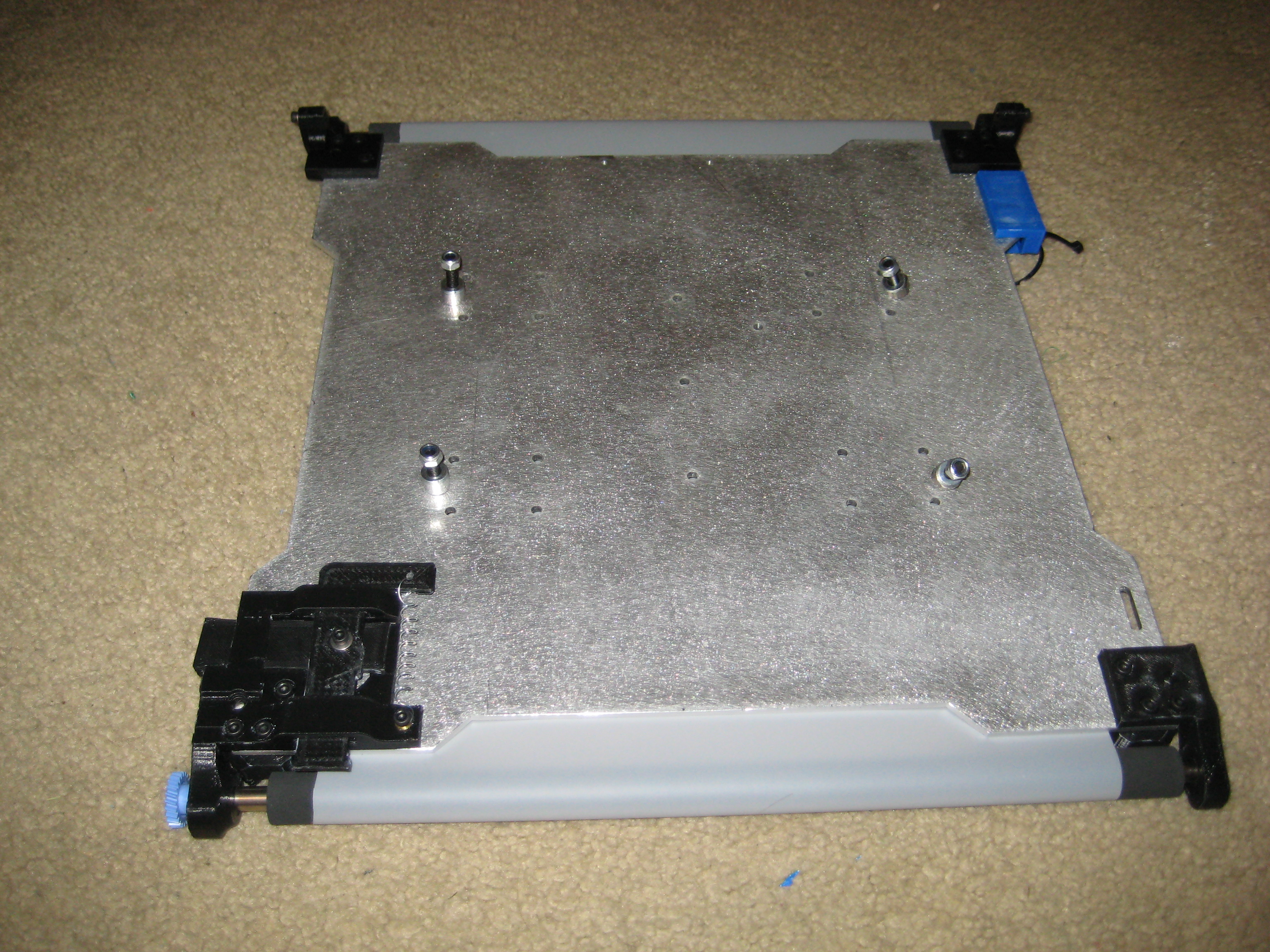

I finally got some time to play with this some more. I have officially fitted a test belt to the assembly, and tested a sort of working gear brake mechanism.
The belt is just temporary, will be cut better and adhered better on the permanent one, etc. For right now it’s just a placeholder for fit. The bed tensioners work great, the belt feed works great, with a bigger gear on the spindle i see no issue with ejecting moderate sized parts in the future.

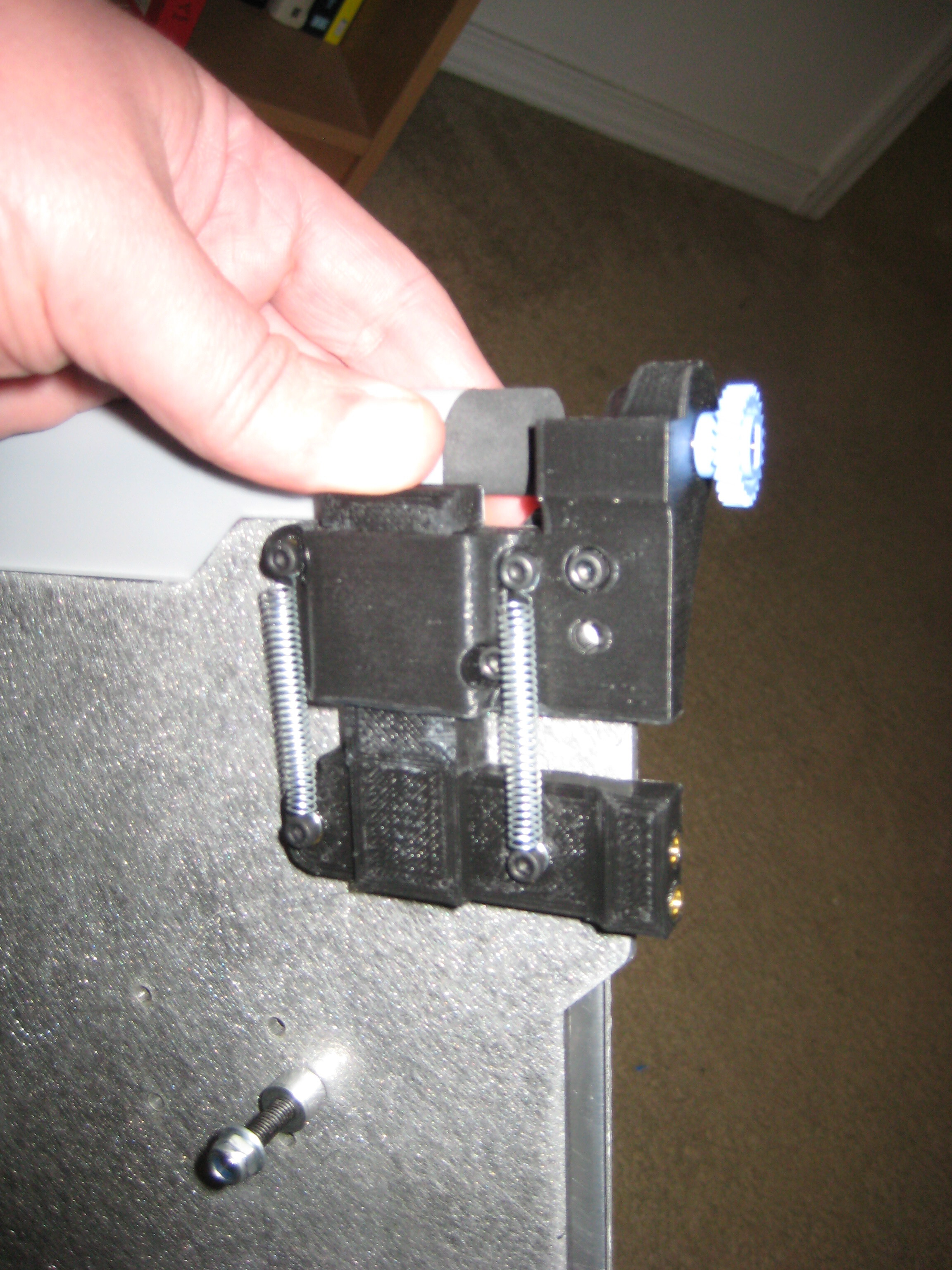

The gear brake mechanism on the bottom front right corner also technically works. Impact does indeed retract the mount where the gear brake teeth would eventually engage the gear. Sort of. And it does eventually go back kind of. There’s just too much friction the way I have it right now. Thicker parts, a bearing on the guide pin, a better spring, a better holding bracket, etc. will all fix that. I erred on the side of trying not to add too much weight, but it is working as a proof of concept anyways. It just needs a bit of refining.
You also see the new bed mount corners. These use a precision cut segment of flexible silicone tubing to relpace the spring dampers. It will give the bed a more solid feel, but still allow for impacts. These are basically the same density as the ninjaflex spacers on the Taz 6 bed, but less expensive to make and adjustable. That STL is ready to be used for aluminum beds, and will be posted somewhere below. The other bracket peices still need some work. I don’t have the actual bed heater installed yet (it’s on the way) but I do not see any potential clearance issues in that area, even witha thicker multi layer bed. There is plenty of room for the openbuilds wheel bolts, someone fitting this to a stock Taz may want to replace the stock M3 bed bearing holder bolts with low profile head ones, but either way it should work with no snags. The belt feeds manually without traveling back and forth, there is plenty of tension possible even with just the tape seam, and everything lines up perfectly for the motor mount. I just need to add the limit switch mount location, actuator fingers, and rebuild the brake system to be more reliable, and I think we have a prototype for testing. My confidence level in this project is very high at the moment that it is viable.
More pictures and the Corner mount STL. This one takes a 1/4" soft silicone tube with a 3mm inner diameter hole. I think its intended for use with spray nozzles.
corner (repaired).stl (540 KB)
I should also mention that this project so far requires zero modification to the Taz build plate. The openbuilds Y axis modification is reccommended, but not required. Once I get it working on the Taz 5 bed, a Taz 6 bed variant is possible without too much trouble. The mount corner holes are a bit different, but not too far off, and the changes will be in areas that don’t affect pathing or operation.

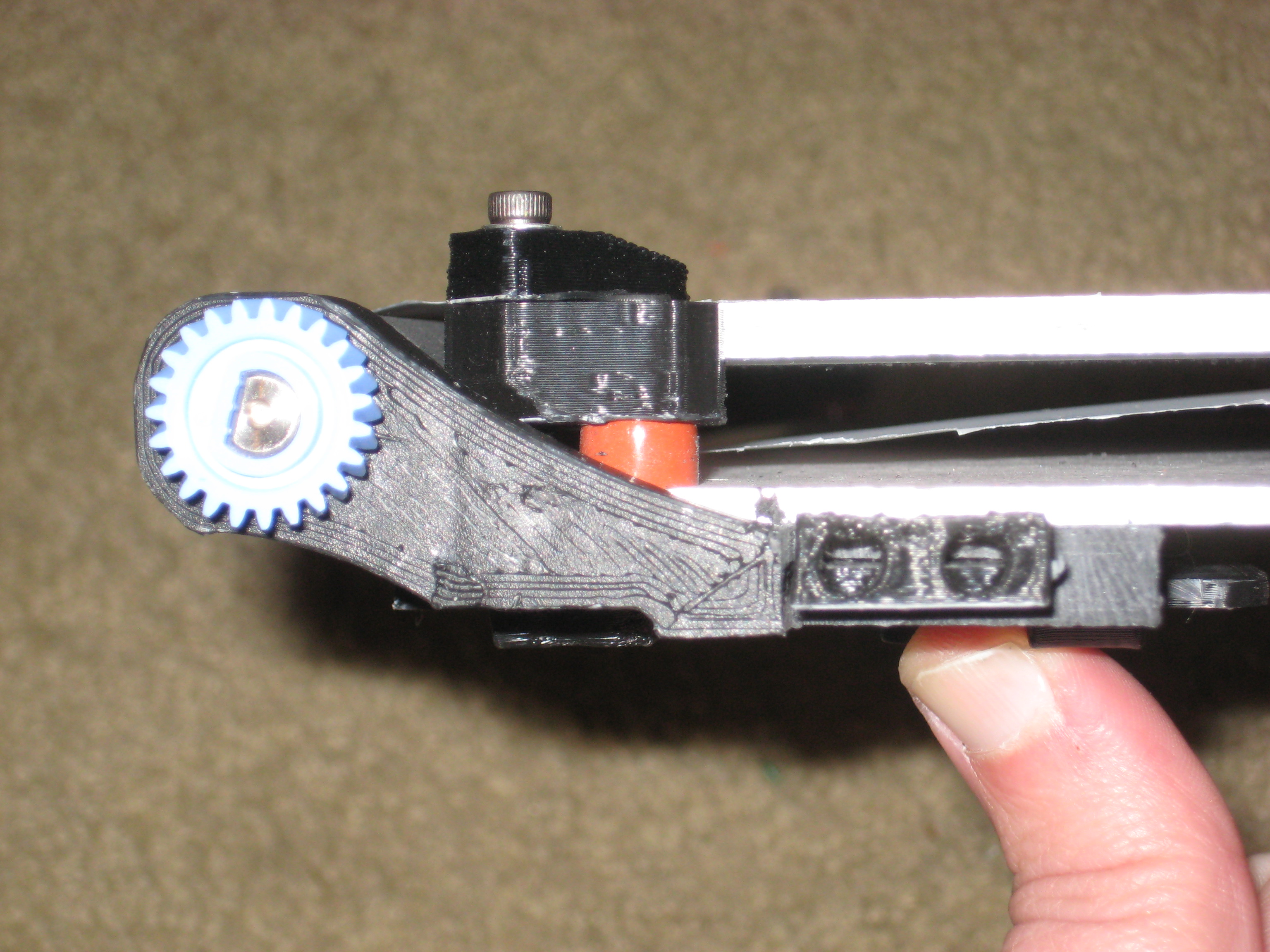

I fixed the gear brake mechanism. It looks like it will work just fine now, and is half the mass of the other crappy one too.
When the bed approaches Y maximum, a pokey thing on the back of the conveyor belt motor can housing will hit the gear brake, pushing it back about 5mm before the second pokey thing on the bed itself hits the conveyor belt actuator limit switch. You can see the general arrangement below.
