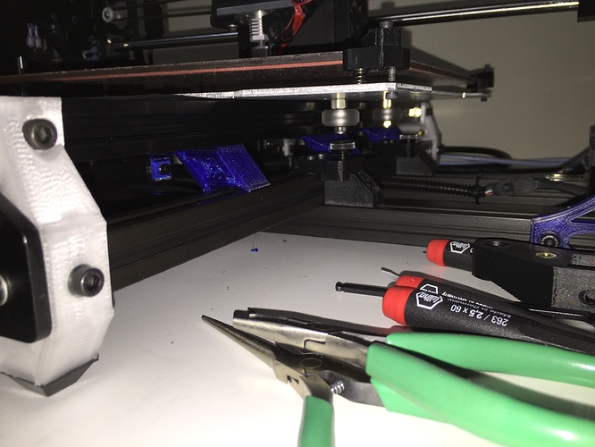

Got the plate drilled and the Y axis mounted. Here is a video of the initial run in operation:
and some pictures!
And more pictures. The one rail that looks like it is a degree off is, I need to adjust the back plate on the Y axis, I’m going to wait until the print is finished before I do though. SO far everything is working great. The individual layers are getting a much better bond to one another as well, which is an interesting side effect I wasn’t expecting.

Just ripped the Misumi hardened rails out of my Taz 5 and installed the Openrail. Without printing anything, all I can say is that it’s super smooth and quiet. The force required to move the build plate is considerably less than the stock setup.
Took me a good 2.5 hours and I guess the 500mm rails needed to be cut. That kind of threw me off a bit as I figured it was a drop in. It was getting late so I just hacked it up with a jig saw. I could have done a better job but I was getting impatient as i wanted to sleep haha.
Running a 50cm test cube at the moment so I’ll see how it looks tomorrow morning. However, looking at the first layer or two, it looks a lot nicer than what I was able to do with the Misumi rods.
Oh and my parts are printed with eSun PETG.
One caveat is that I wasn’t sure what drill bit equates to 7.2mm so I just used a 7mm drill from my metric set. The hole was slightly too small for the eccentric spacers to fit in but I was able to take a slightly smaller drill bit and used it as if it was a file to remove a bit more material. That did the trick and the e-spacer was able to fit nicely and snug
For the 4.975 holes, I just used a 5mm drill. The drilling jig made it nice to drill but I was thinking maybe it would be nicer to make it slightly thicker to help guide the drill better. Downside is that you need longer m3 screws to hold the piece down.

Clearly, Misumi rods + ball bearings are not the way to go. For anyone looking to do that, please do not. Stick with the Igus or do this conversion
