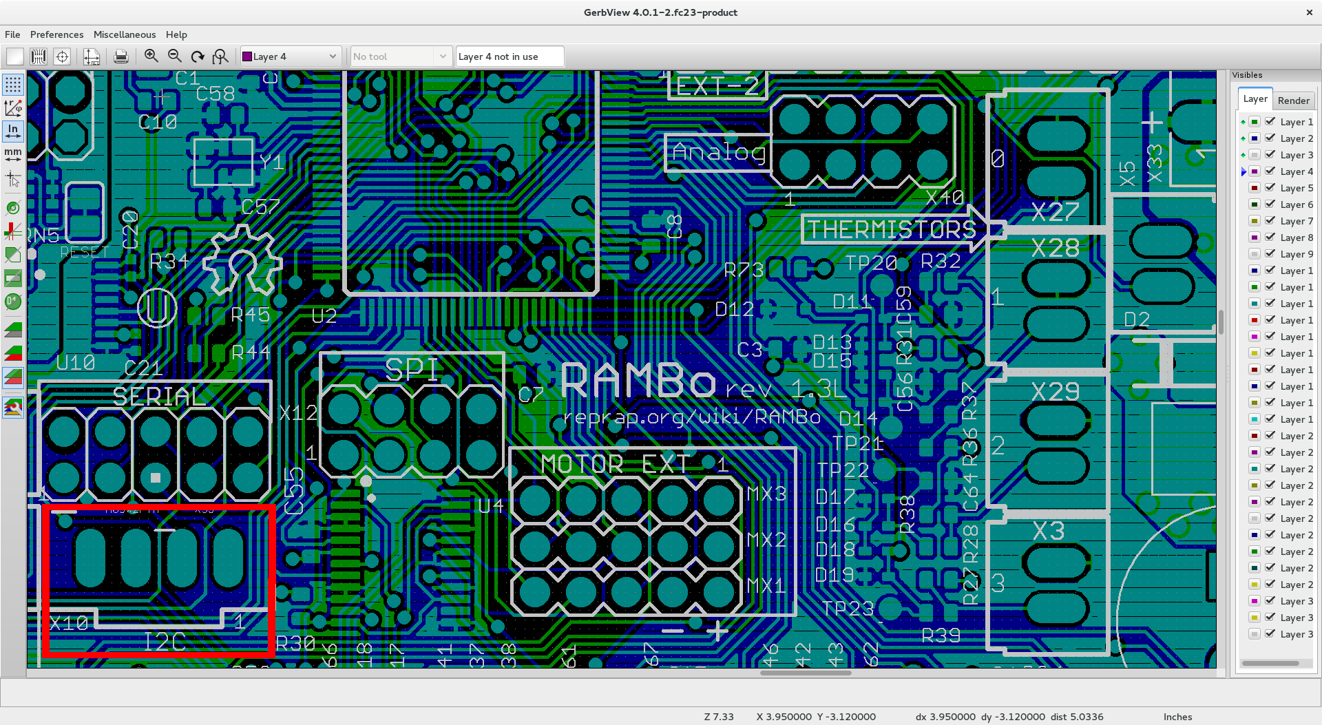

Hi ! At this moment I fried almost all my endstop pins. I have only xmin and ymin. To avoid buying an other Rambo board, I’m trying to use a mcp23017. The hardware is allways working and tested with a basic example : blink.
I want Marlin read the state of pin 0 on the mcp23017 and not the pin 10 of the atmega. Can someone help me to adapt the Marlin firmware ?

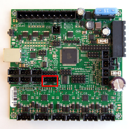

You’re actually fine if you’re using the LCD controller.
Sorry, you can attach several slave devices to an I^(2)C bus if you’d like but it will be more challenging to get it set up (extra wire pinning and programming). Also, I made a mistake, SDA and SCL are not actually routed to EXT-2. There is a totally separate pinout for the I^(2)C bus.
The header can be found here on the RAMBo 1.3L (“I2C” is silkscreened just below the header):
Make sure that’s where you’re connecting the MCP23017.
If you have any free digital pins available on your RAMBo then you can simply use those as your endstop pins rather than using the MCP23017, but it’s up to you.
The MCP23017 is connecting in the right pins. That was checked with a very simple blink sketch and with the M119 statement.
