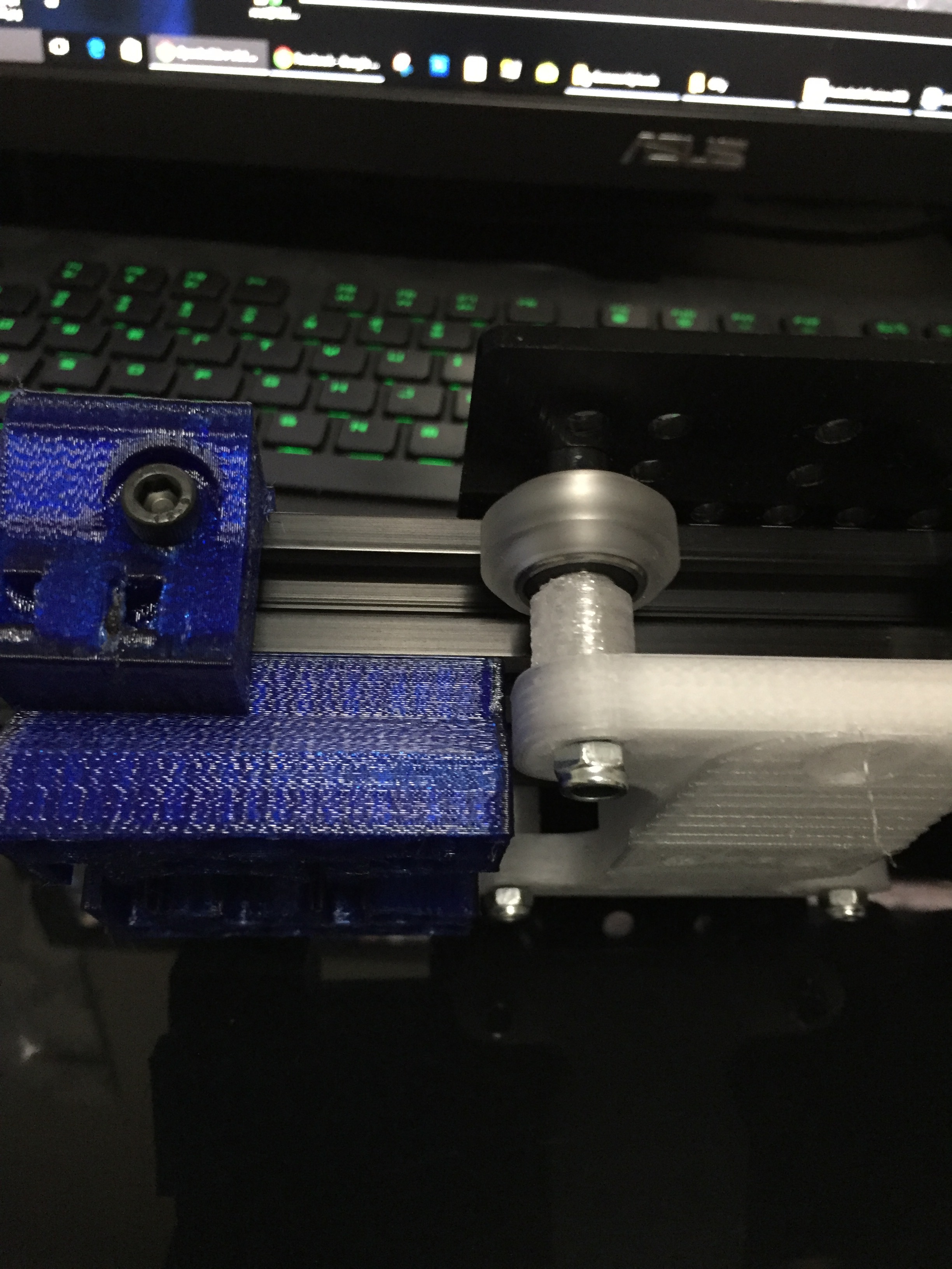

I’ve got most of the X axis built. All I need are the heat set nuts to arrive from McMaster (should be tomorrow).
@Piercet: I wanted you to take a look at what I have and see if that’s even put together correctly. My main concern is that the X endstop switch might not be able to make contact. Might be ok but just not sure.

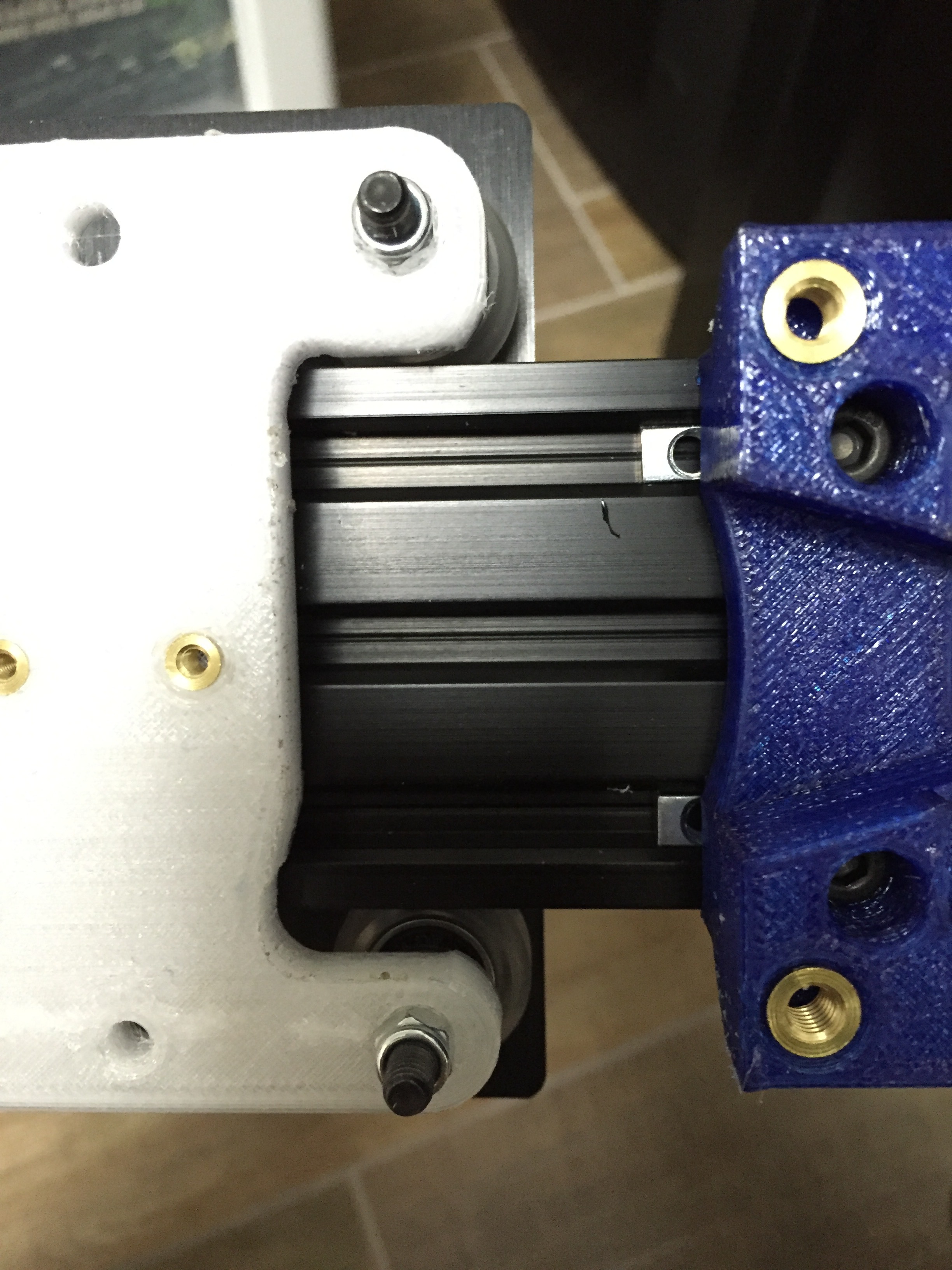

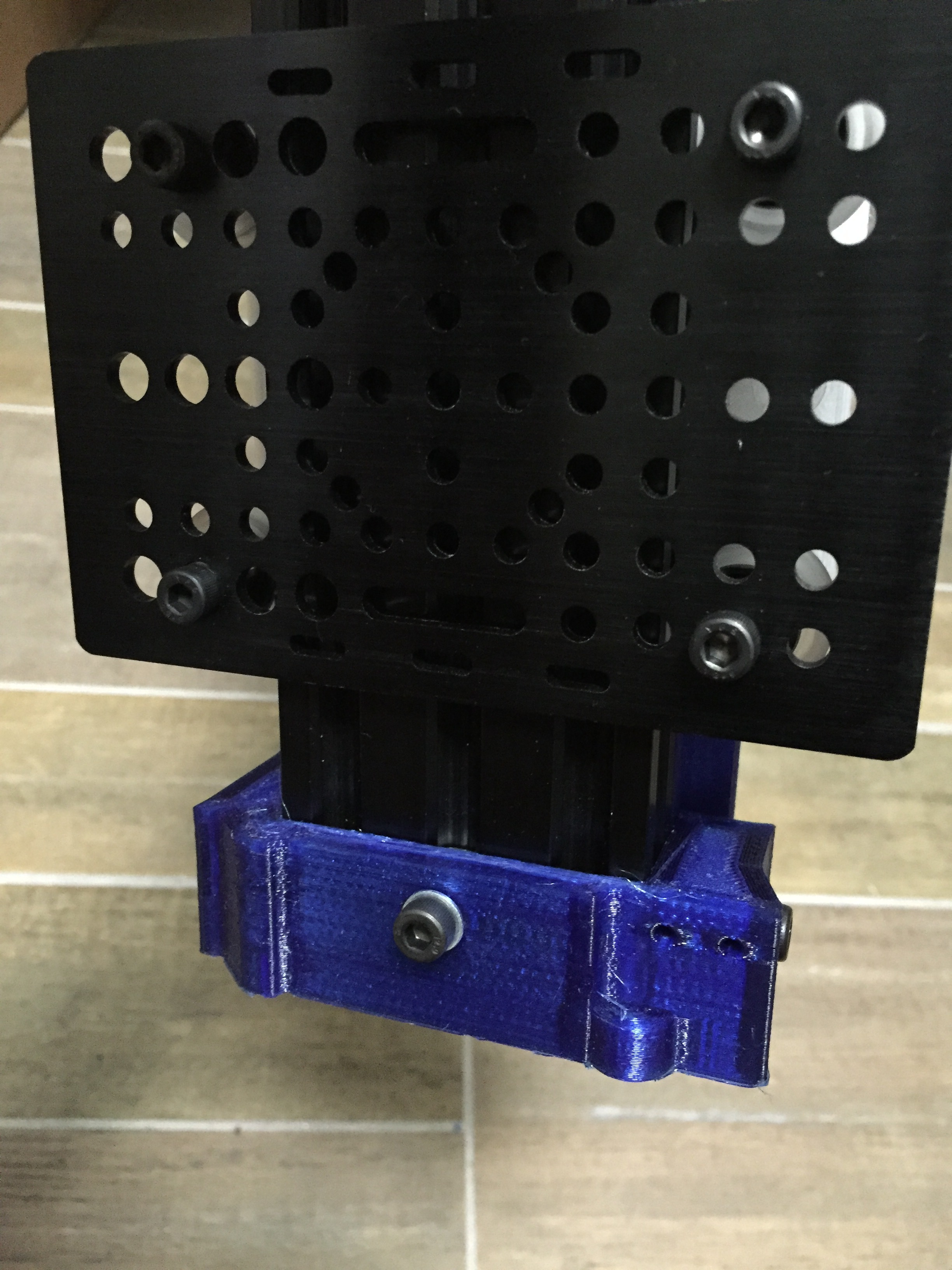

Hmmm, yeah that is a bit too far over. Looks like the upper backplate arm may be in the way. The motor mount piece should be all the way over and flush with the outer edge of the x endcap. I can’t tell if it is in that picture or not. The front mounting plate that bolts on to the front of the metal plate is a bit wider than that plate by design to contact the endstop, but I might need to make you a modified backplate. If you can, please post a picture pointing straight down to the backplate with the end cap in the frame, one from the side view of the endcap towards the backplate, and one of the endcap and the motor mount block itself and ill see if I can fit it in there. Worst case scenario you may have to use the other style.

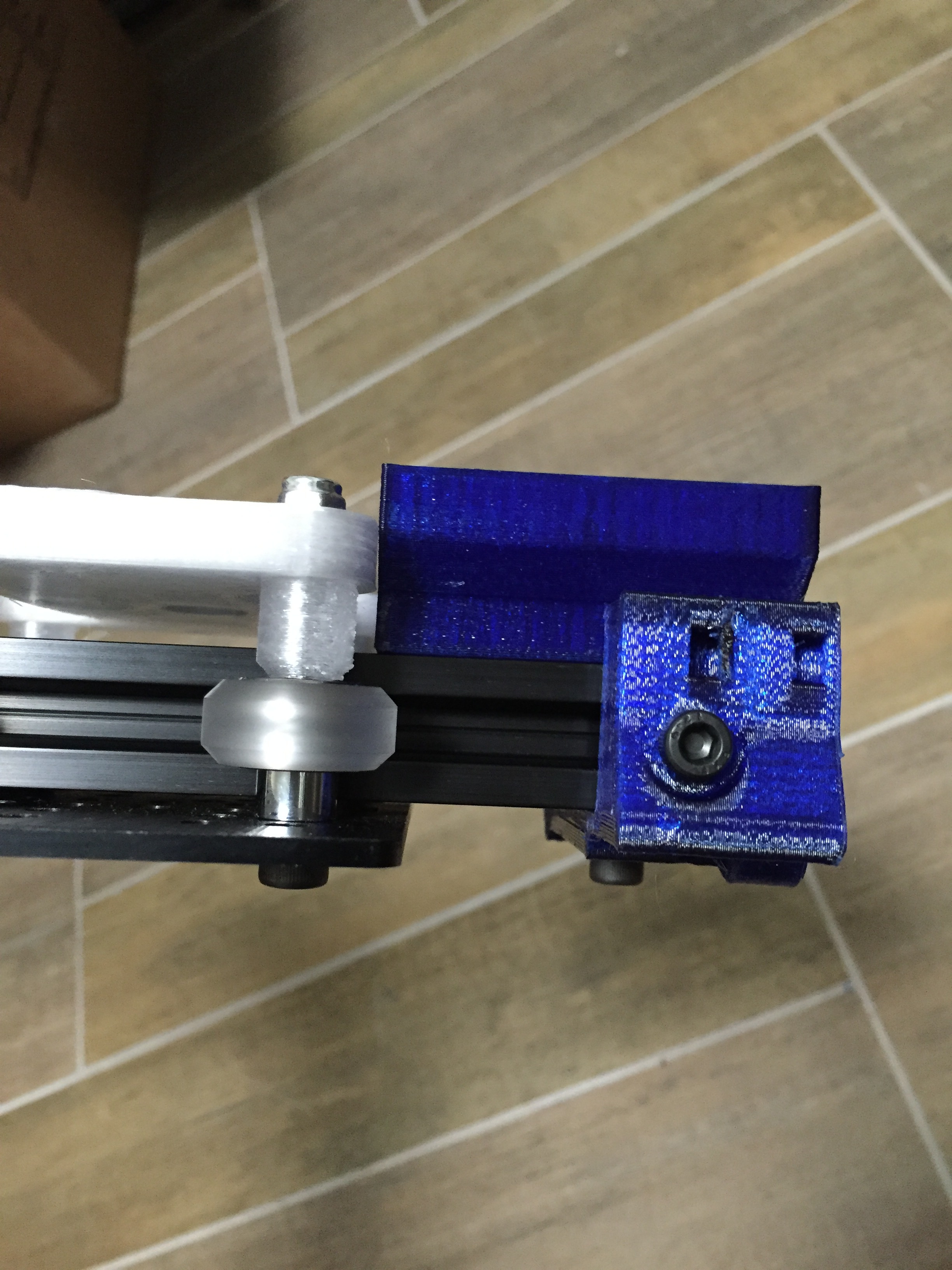

Here are a bunch of pictures of the back area on mine with the metal plate
Is yours hitting on the bottom and the top? How much thinner would the backplate need to be to clear on either side? I can probably drop the thickness quite a bit safely, it’s pretty overengineered.
It looks like the spacers I made spaces the piece out too far. I shrunk it from 12mm thick to 6mm and it still could use another mm or two. I’ll probably just order metal spacers from openbuilds because I need to buy some low profile 40mm’s. The 25’s that I did order were too short.
As it is, it’s able to slide all the way or almost all the way. I machined some of the plastic off on the back plate as well as lightly dremeling the motor mount
Ok, great. You are definitly close enough in that last picture with the front mount plate installed. it’s about 3mm wider on either side than the metal plate so you should get just about ideal limit switch position there.

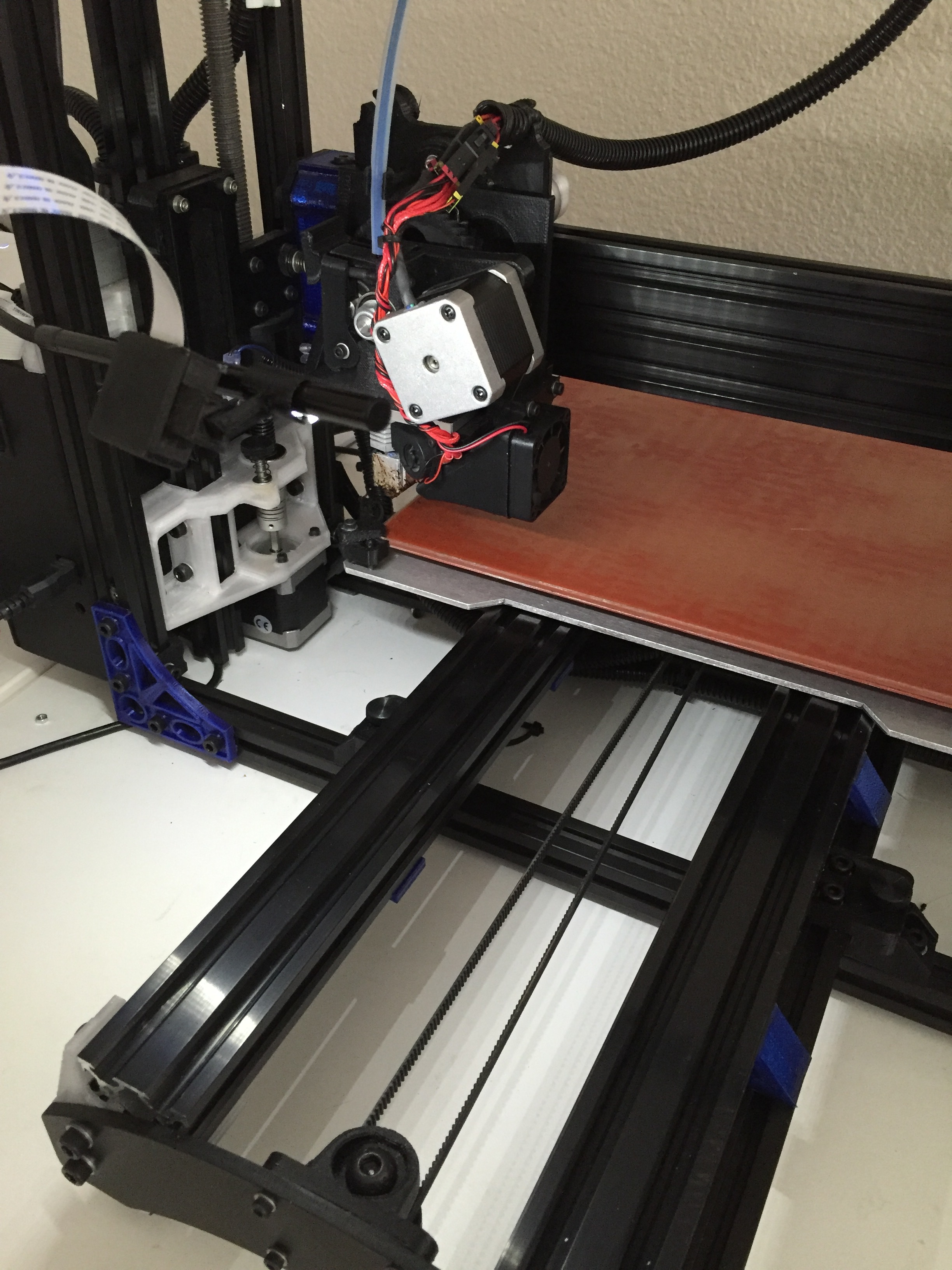

The X and Y rail mods do complement eachother. Without the Y rails, you will see an apperent dip in the middle of the bed because the stock Y rods also have the same amount of flex in the middle. On the stock Taz, both the X and the Y have about the same amount of flex, With the X mod in place only, the Y rods are still able to deflect down from the weight of the bed, leading to an apperent low spot in the middle.
I do highly reccommend replacing the stock glass bed with 12" x 12" x 3/16" Aluminum plate with PEI or Buildtak on top. It spreads the heat very evenly. The downside is you have to either transfer the heater off the glass to that plate, or buy a new one for $70.

I actually did the Y mod as well, so that isn’t the cause of the bed sagging. I put a straight edge over the top with the bed while it was heated and there was a small gap in the middle, and as it cooled the gap went away. The only thing I can think of is that the glass starts to sag under its own weight.
