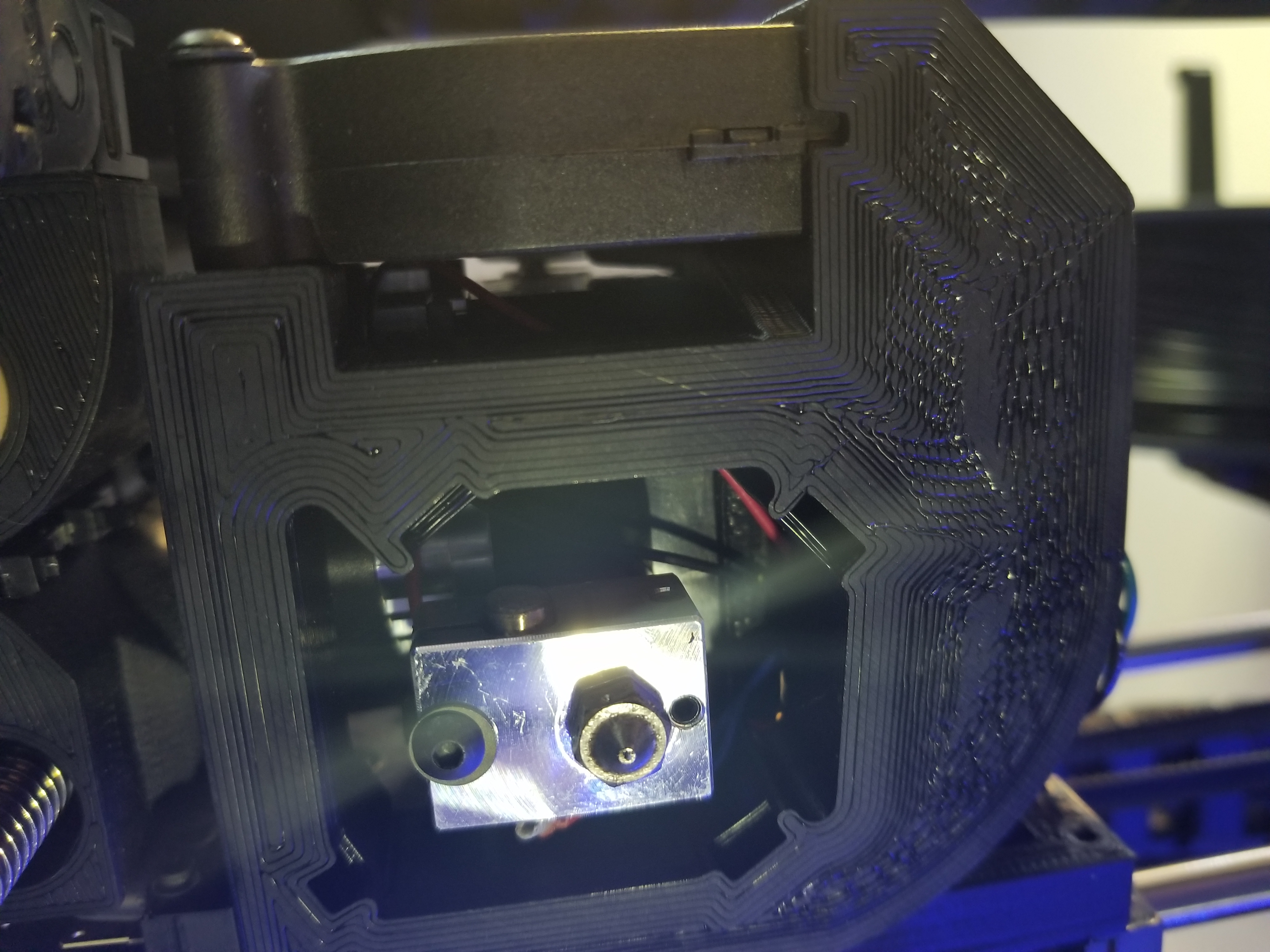

I do not have an Aero tool head, but does it have a silicon sock on the heat block to keep the filament fan from cooling it too much? The radial fan pushes more air through compared to the old axial fans.
I don’t think so, but here are a couple pics as I’m not certain I’d recognize one if it was there. They’re not the best pics, but short of disassembling the tool head, were the best angles I could achieve.

My Aerostruder PID numbers (for 240c) came up as: 22.35, 2.16, 57.70. I haven’t had any heating issues – before or after adding a silicone sock – it’s been very stable, within 1.2c when printing, even with the fan at 80%.
A silicone sock looks like this:

Yep. Great deal at $2ea, helps keep things clean and theoretically helps with temp stability, although I never had a problem with temp before putting it on so can’t really attest to that.
