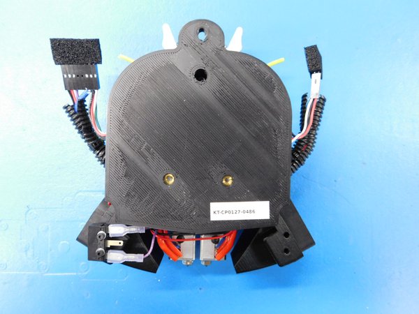

Where is the serial number located? Mine was purchased on 11/30/17, and I can’t find any markings on either the toolhead or packaging.
There should be a sticker placed somewhere on the back of the toolhead where it rests against your extruder mount that will have the complete serial number for the toolhead. I attached an example picture for placement on the Dual Extruder v3.
My V3 does not have a sticker. Not even an e-steps sticker.
Reach out to the support team at LulzBot.com/Support and they may be able to find your probable serial range based on your purchase method. Include your order number. How is your tool head performing?
